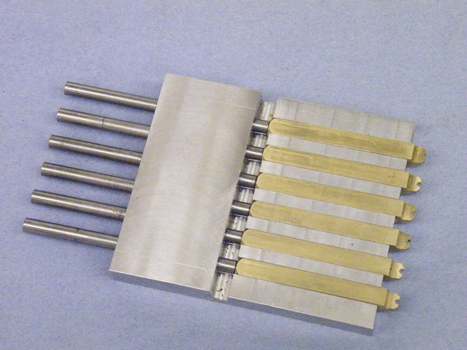

Like below, power tap the brass fingers with a 5mm LH coarse tap on the lathe, then single point the same thread onto the SS rods for a perfectly straight and perfect matching thread.
Don't ask what it is for.
