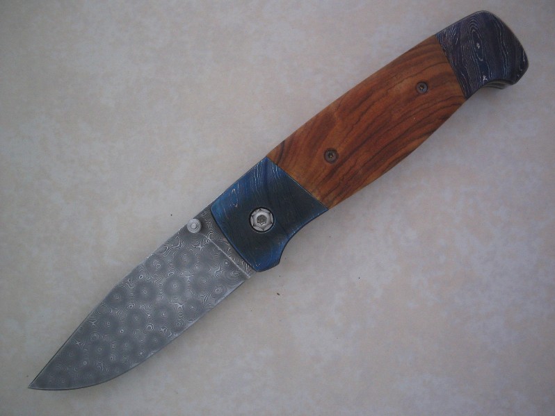

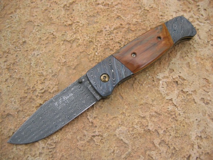

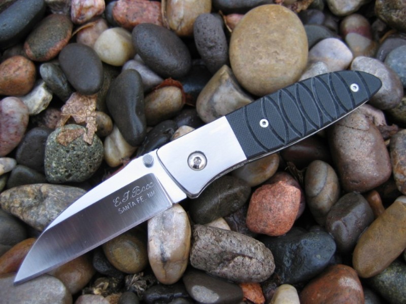

Ok  I guess I will have to figure out how to use the quote feature also:)
Here are a few pics of my knives. Two are Damascus and one is titanium stainless and G10.

Those are some nice knives. I especially like the middle Damascus one. So when you say you buy the raw materials, you actually forge the Damascus? I would love to see some shots of that!

I purchased the Damascus as bar stock for these knives, I have forged some damascus but I don't have the space for the extra equipment I need so I just buy bar stock.

Very nice knives there blade :clap:
Hope to see some more of your work :thumbup:
