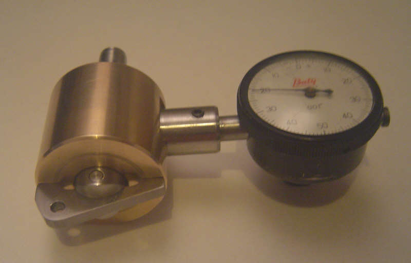

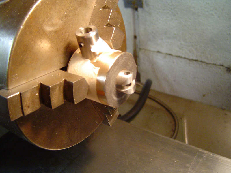

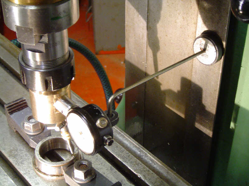

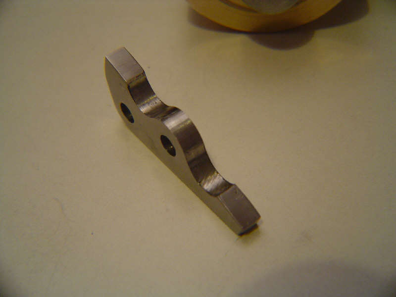

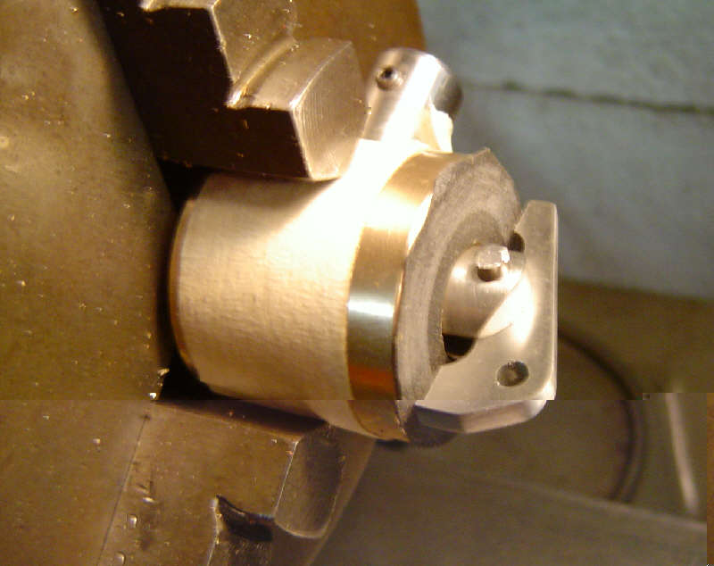

Rocker on  :headbang:
Managed to get the slot cut and the rocker made.
I was wondering how to grind the involute curve on the tips of the rocker when this idea struck...
I stuck a disc of emery to the bottom of the indicator body, assembled the lot into the lathe chuck, then ground the tips in situ :)

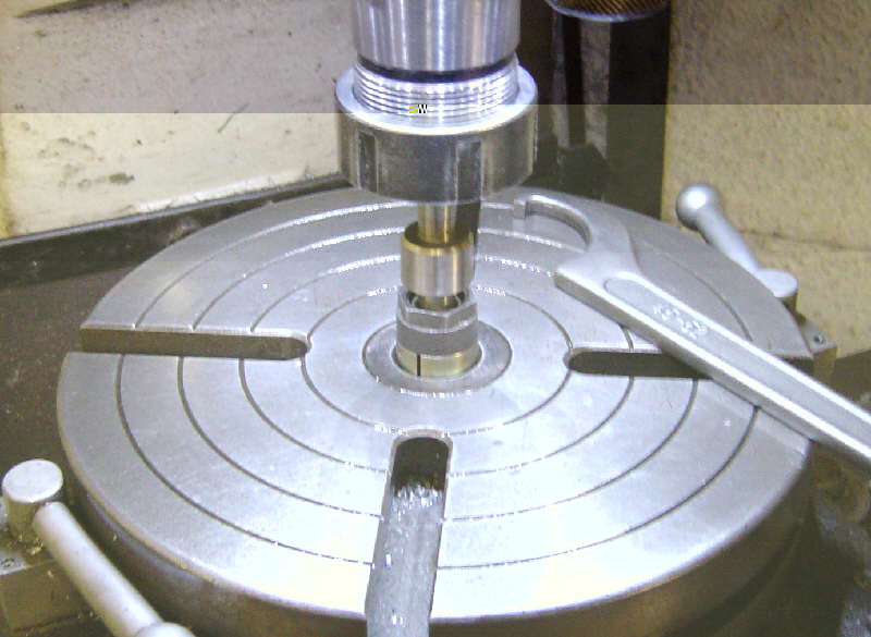

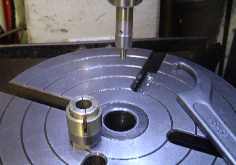

« Reply #26 on: November 08, 2010, 02:35:24 PM »
I thought you might like to see how I quickly centre my rotary table.
I found a expanding clamp, the type used to fix pulleys to shafts, that conveniently fits the MT3 hole in my rotab and fits the 10mm end of my little edge detector.
I can pop the clamp in to the hole in the rotab, lower the edge detector in to the clamp, nip it up finger tight, then by either sighting or feeling the two parts of the edge detector , I can align the centre to about 1 thou" or so.

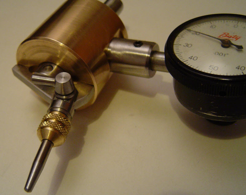

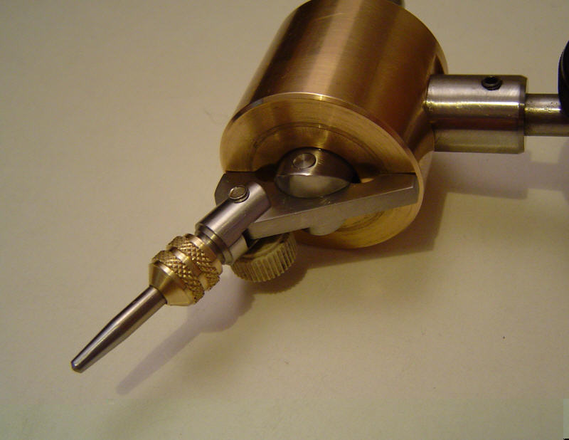

Almost ready to test...
Made the little probe holder this evening. The plastic wheel in the photo will be replaced later with a lever (I think).
I'll nut out some sketches of some sort for interest, maybe for the Mk2.
Sounds good :)
John, Does your Blake device have a spring to bottom the body, or does it, like mine, rely on weight?
« Last Edit: November 09, 2010, 03:56:00 PM by BillTodd »

« Reply #30 on: November 10, 2010, 02:54:07 PM »
Well that seems to work OK  :)
Made a little screw to clamp the probe onto the rocker (worked at second attempt having bent the first one  :hammer:)
Made a simple hook using a 3mm rod and a magnet from a small loudspeaker to hold the indicator still. Then, gave it its first test...
http://www.youtube.com/watch?v=wQYw0c3RN_0
There's a residual ~1/2 thou" wobble caused, I think, by the face out of alignment with the bore. The facing had to be a second operation because of the dual diameters of the bore - I may have another go at it, taking more care this time (MkII will have a straight bore) .
I also noted a tiny 'kick' with the thing zeroed on the mill, the cause of which I have not been able to find - could be a piece of **** in the taper part or ???

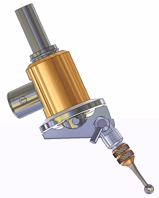

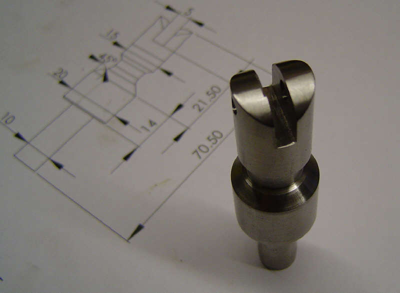

Ok here's the MkII provisional design
A straight shaft should be easier to make and means the critical parts of the body, the bore and face, can be machined in one operation.
« Last Edit: November 11, 2010, 04:38:31 PM by BillTodd »

  • Posts: 1179
Re: Coax indicator design
« Reply #48 on: November 12, 2010, 03:28:32 PM »
Bill,
Can I encourage you to provide a few measurements for your design, please?  Just the main shaft and the bronze sleeve ought to cover it.
No problem Marv
The attached drawing are for MkI - I'm sure you can extrapolate to the MkII if you need to :)
The drawings are as designed rather than as made so, for instance,  I made the large diameter of the shaft 19mm (~3/4") because the A4 bolt I used as stock would not quite give me 20mm once surfaced. If it's easier to make the 15mm diameter = 5/8" or the 10mm = 3/8" , it won't make any difference to the function of the device.
The bearing ball I used was 5mm but  3/16" or even 1/4" would do, just adjust the holes to suit.
I machined the indicator holder to be a press fit into the side of the body - might have been better to thread it.
« Last Edit: November 12, 2010, 03:40:13 PM by BillTodd »
