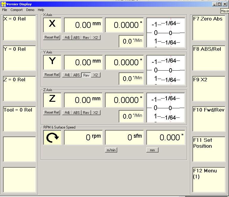

Not to put you off but... (BTDT using VB5 and my own microchip PIC interfaces)
Have a look at Touch DRO for andriod (works fine even on old tablets like HUDL etc) - it uses bluetooth or serial to connect to the scale interface devices (arduino etc.) and will save you a whole pile of grief writing software (at least until you see exactly what you want from the DRO)
For a Pi  you might want to look at Python and Kivy - I'm currently using it for a automated test system project , and once you get your head around the thing , it works nicely (doesn't require the Debian desktop overhead - see picture below)
One thing I really liked on my VB5 DRO  that I haven't seen on other DROs is analogue displays of fractional inches (and simultaneous display of inch and metric) . If you work in both systems it's so much easier than switching scales.
As you can see from my list, simultaneous output of mm & inch (or vice versa) was on my list; I hadn't considered having the fractional readout simultaneous as well. One to add to the options list ;) FWIW, the main criteria of the readout, for me, is that it's clearly visible when I'm at the other end of the lathe peering through a cloud of smoke and trying to dodge red-hot chips :D

I think that if you allow data entry in fractions, then the actual decimal values should be displayed. How will you decide what the smallest fraction denominator will be?
You don't need to decide , the fraction is a simple division function. Data entry in fractions is common in CAD/CAM (as is unit specific entry - solidworks will allow you to enter 1/27" while working in metric or even 1/4mm if you so wish )
On my analogue 'inch' meters, the option is set as part of the VB object's display parameters  , I chose 1/64 as it is about the smallest division in common use .
As I said above I found it very useful and would include it in another DRO .(see video below)

Re: DIY DRO for lathe or mill
« Reply #20 on: June 09, 2020, 06:22:17 PM »
Hi Bill,
That's pretty much what I'd wanted to do with the Python/Gtk (also tried TkInter, but fell out with that one as well - Qt didn't look any better); just building and positioning the controls was an absolute nightmare, never mind moving them on the fly, or cropping them inside a viewport...
Rather than use labels for the fractions, I just use a giant PNG file (6400px & change tall, 50px wide, about 5k in size), which I build with an ImageMagick script (which is itself built with a Bash script); this covers +/- 1" in 64ths (with /128th marks, but no legend). I simply use this as a background image on a fixed-sized div, and change the position to show the correct bit. Had to go with + and - sections, otherwise the tape effect "bounced" between +ve and -ve readings instead of continuing to roll in the same direction...
Your whole number is better than mine at the moment (which is just a fixed display), I'll use a similar technique to yours I think for that - an absolute-positioned field, which gets rolled up/down as the next number comes into play.
I just need to transfer the UI/browser app to the Pi, to see if I'm going to need to use a Pi4 to get enough performance, or whether a 3+ will suffice. I'm hoping the latter will do.
Reliability seems good - I've had the thing running on my desk for several days, powered via the computer's USB port, and it's worked flawlessly - but, then, most of the complex stuff isn't there yet!
Cheers,
« Reply #21 on: June 10, 2020, 05:13:07 AM »
GTK and kivy have a completely different paradigm for form design compared to MS (windows) absolute position: the controls are placed and sized automatically and are only influenced by size-hints (proportions) . There are ways to place and position using co-ordinates but without any Wysiwyg IDE (that I've found),  it's a PITA to design exactly what you want.
I was going to look into recreating the dial in kivy , but got distracted by an email from Doug Self about a German  book publisher wanting to use a still from one of my engine animations  to illustrate a Horse gait  !  to which I had to reply with this:
« Reply #22 on: June 10, 2020, 05:21:08 AM »
I tried using Glade to design the Gtk layout - but even that's a pig to get everything lined up; and (from what I recall) you then use the output from Glade + a library to generate your UI on the fly.
All in all, none of the UIs I've tried for Linux, are really suitable for doing a fixed-layout on a fixed-screen; they're all designed to be flexible - which is great 99% of the time, but this is the 1%...
I'm hoping to get to the point where I can try the entire app end-to-end on the Pi today; if so, that'll give me an idea if I'll got the performance I need out of the Pi3+,
