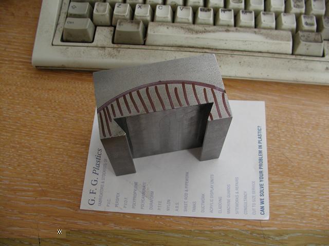

....how _do_ I set one up on the mill, so I know exactly where the centre of the rotab is in relation to the spindle centre?
I have at my disposal: A regular DTI, a finger type DTI, and a small quantity of patience...
basically, I'd like to know when I'm plumb above the middle of the rotab with the cutter, so when I offset by X, I know i'm now cutting a circle with radius X (assuming the work is also centred on the rotary table).
However, this leads to my next question, along similar lines; I need to cut a curved section out of a piece of work (see the attached "metallic 3D" Crap-o-Cad). I don't (yet) know the radius but I'm hoping it'll fit on the rotary table, let's assume it's 8" & my rotab is 12". What's the easiest way of setting the block up so that it'll cut the desired 8" radius? I'm thinking, once I've got the rotab centered, dial 8" of X-axis offset, and with a centre point tool, locate the block square on the table with the pointer pointing at the line, then simply fettling until it follows the right course. However, whilst that should certainly work for my purposes, it doesn't seem like a terribly accurate way of doing things; Surely there must be a better (more accurate) way?

To centre up the RT put your finger dial in the mills spindle and rotate it around the RT centre hole or fitting if you have one.
Then move the x or y axis by the arc you wish to make radius.
Hope that makes sense?

I use an edge finder in the hole. Touch the right hand side of the hole and zero X axis, touch the left side of teh hole and use the 1/2 function on teh x axis. Then repeat for the Y axis. No need to take the dia of teh edge finder into account.
Other option is to turn a bit of bar to a good fit in the 1" hole and at the same lathe setting turn a spigot to say 1/2". Grip the 1/2" spigot in your mill collet, bring the quill down so the 1" end fits into the RT and then bolt the RT down tight and set your DRO to Zero at the same time. You could also tyrn a large conical end if you are not happy about getting a good fit for the 1"
