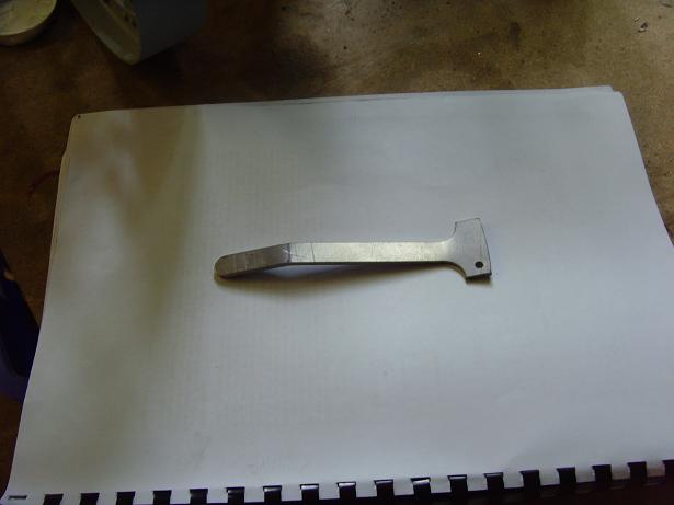

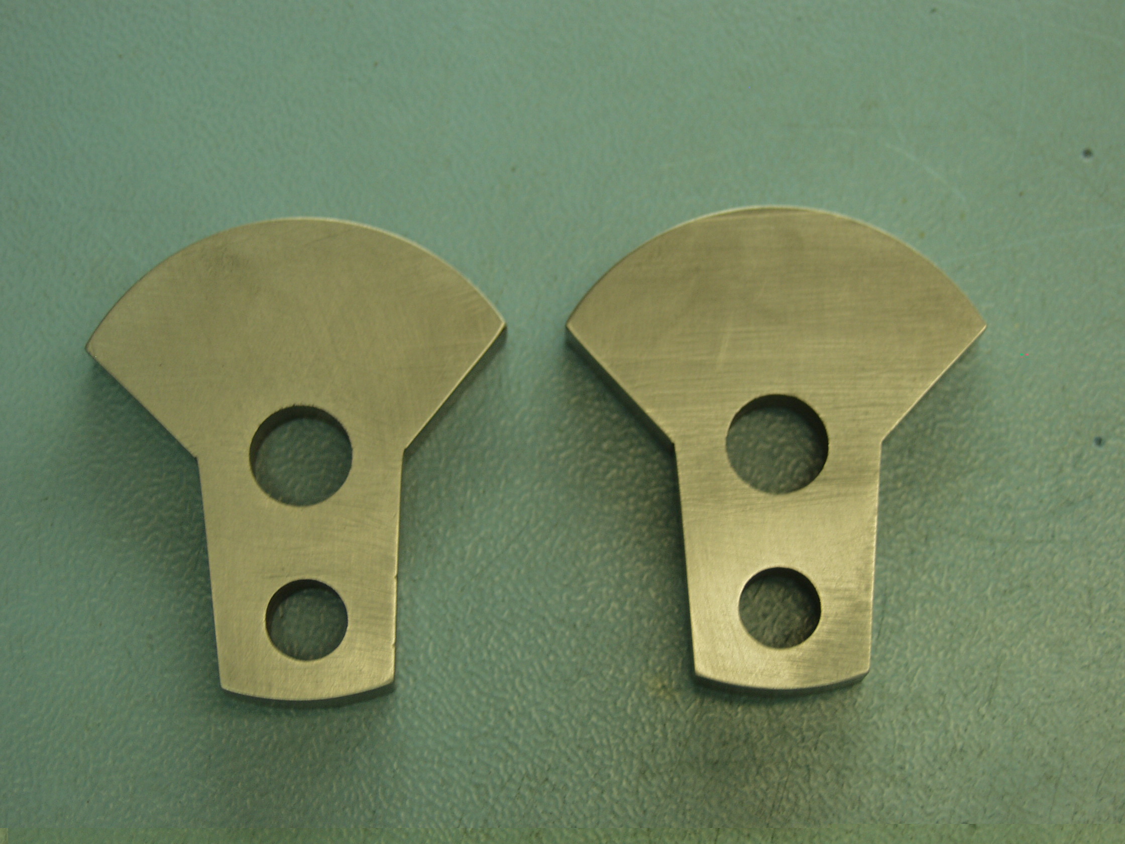

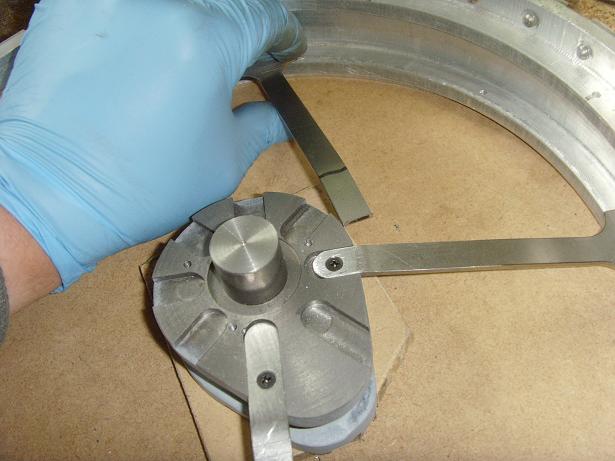

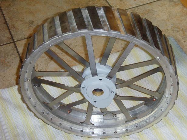

Hi Steve, I was admiring the very fine machining of the cast iron shown in your lathe, and then on to the following pictures, am I right in believing you've taken that cast iron "sheeve", turned it into a wheel hub, and the arm(s) are to be spokes?  I must say, your lathe turns a very fine finish on the iron, and it looks great.  I see lots of small parts and rivets in your future :lol:  that should be a fine looking beastie when she's done.  Very nice work and nice layout altogether.  Looking forward to learning something about traction engines. :beer:  Cheers, mad jack

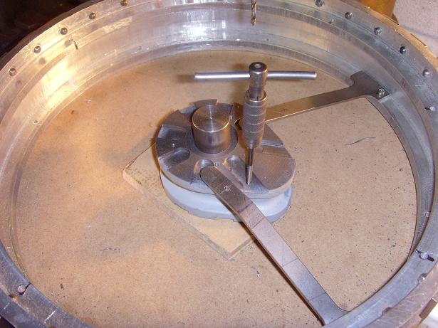

Offline sjb
  • Posts: 21
Re: 2" minnie build so far.
« Reply #19 on: October 07, 2011, 04:31:32 AM »
Hi Jack,
Thanks for the kind comments. The first two pictures show the winding drum which fits to the rear axle and was machined from a piece of cast iron round. The driving centre has still to be made and I think the quality of the material had more to do with the finish than my machining ability!
The next few pictures show the spoke pockets being machined in the wheel hub. The spokes I purchased as laser cut items from Malcolm at Model Engineers Laser (nice guy to deal with, no relation etc). The picture of the wheel in the building jig keeps everything in the right place while bending and fitting the spokes. It also shows the hub with it's cover in place. When I have fitted the first 8 spokes I will flip the wheel over and fit the rest.
I can happily take more pictures of this process if your interested.

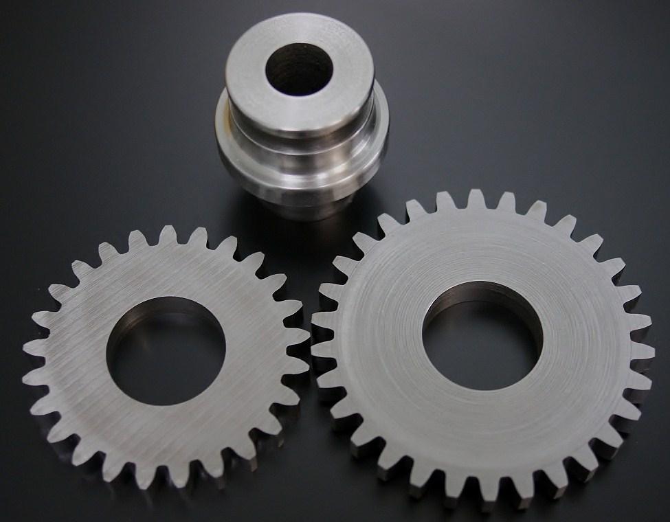

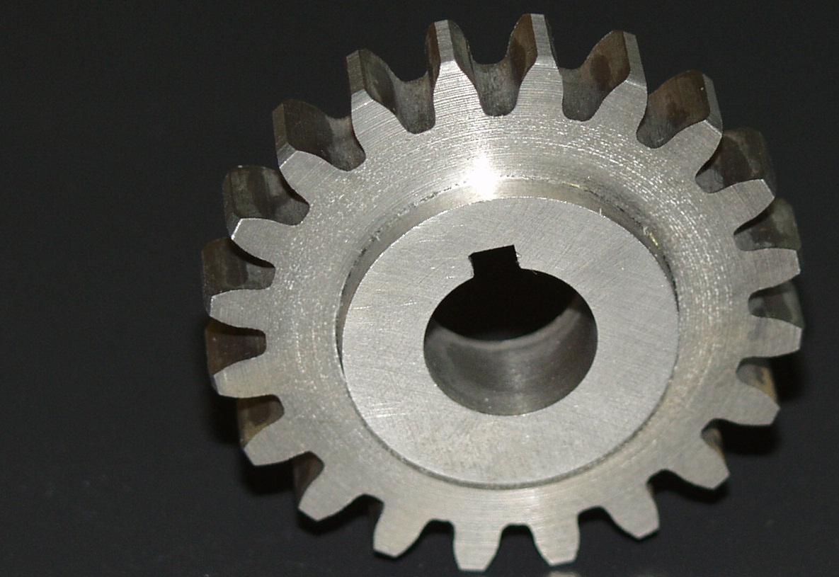

« Reply #24 on: October 08, 2011, 11:14:39 AM »
When you double the scale you half the DP so 10DP would keep all the gear centers in the same place. Number of teeth stay the same.
10DP is a bit fine if you want scale appearance but as its a freelance engine anything goes and its easier to cut 10DP on smaller machines than the 8 & 6 DP on my 2" Fowler.
J

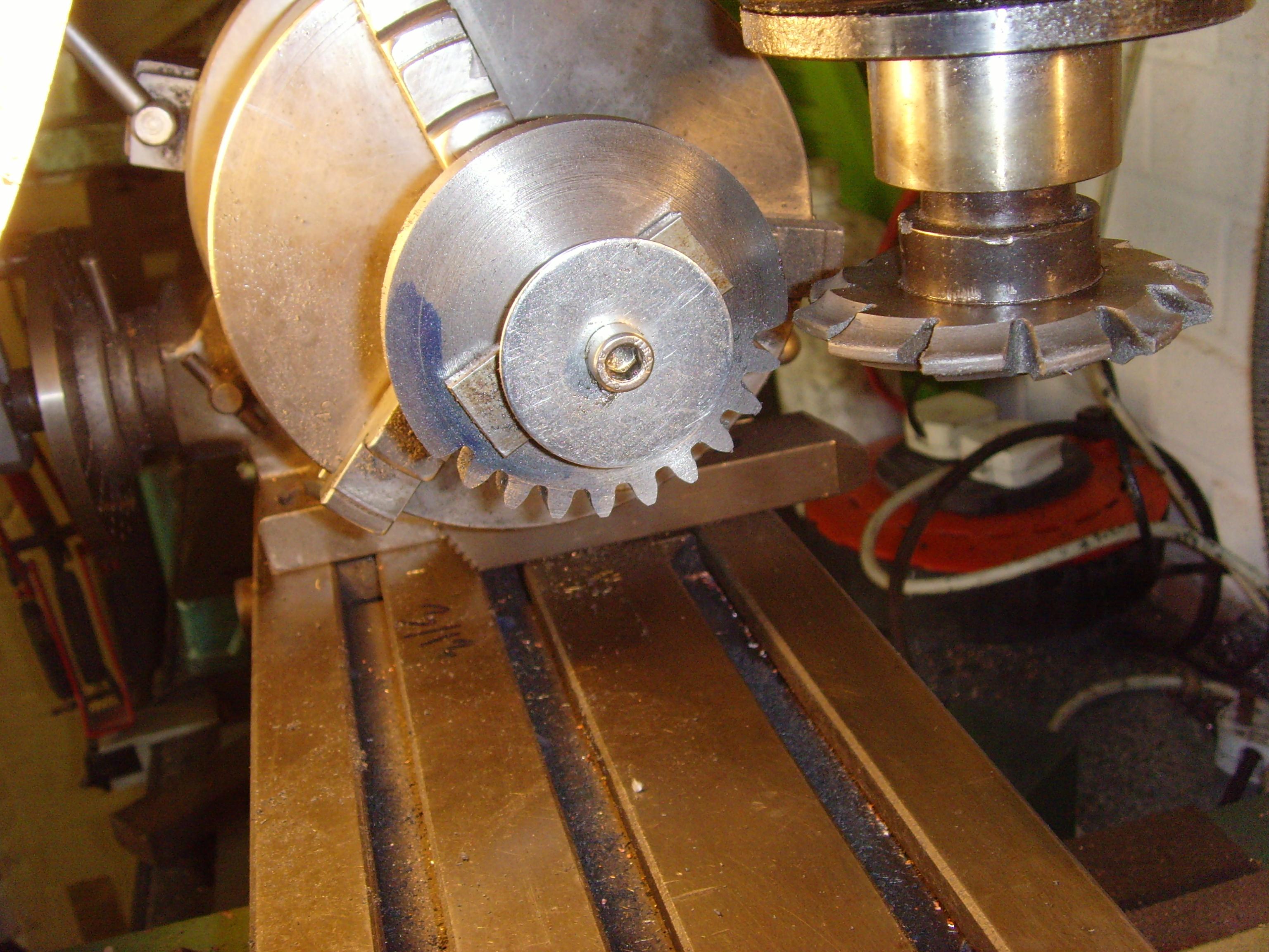

  • Posts: 21
« Reply #25 on: October 08, 2011, 05:40:23 PM »
I have cut my gears 10dp with cutters purchased off EBAY £ 20-00 each. I thought it best to keep to this pitch as I didn't want to get in a complete pickle. :loco: If you look at the picture of the engine on the bench you can see the large 50 tooth wheel hasn't had all the teeth cut because I made a bit of an error... :(

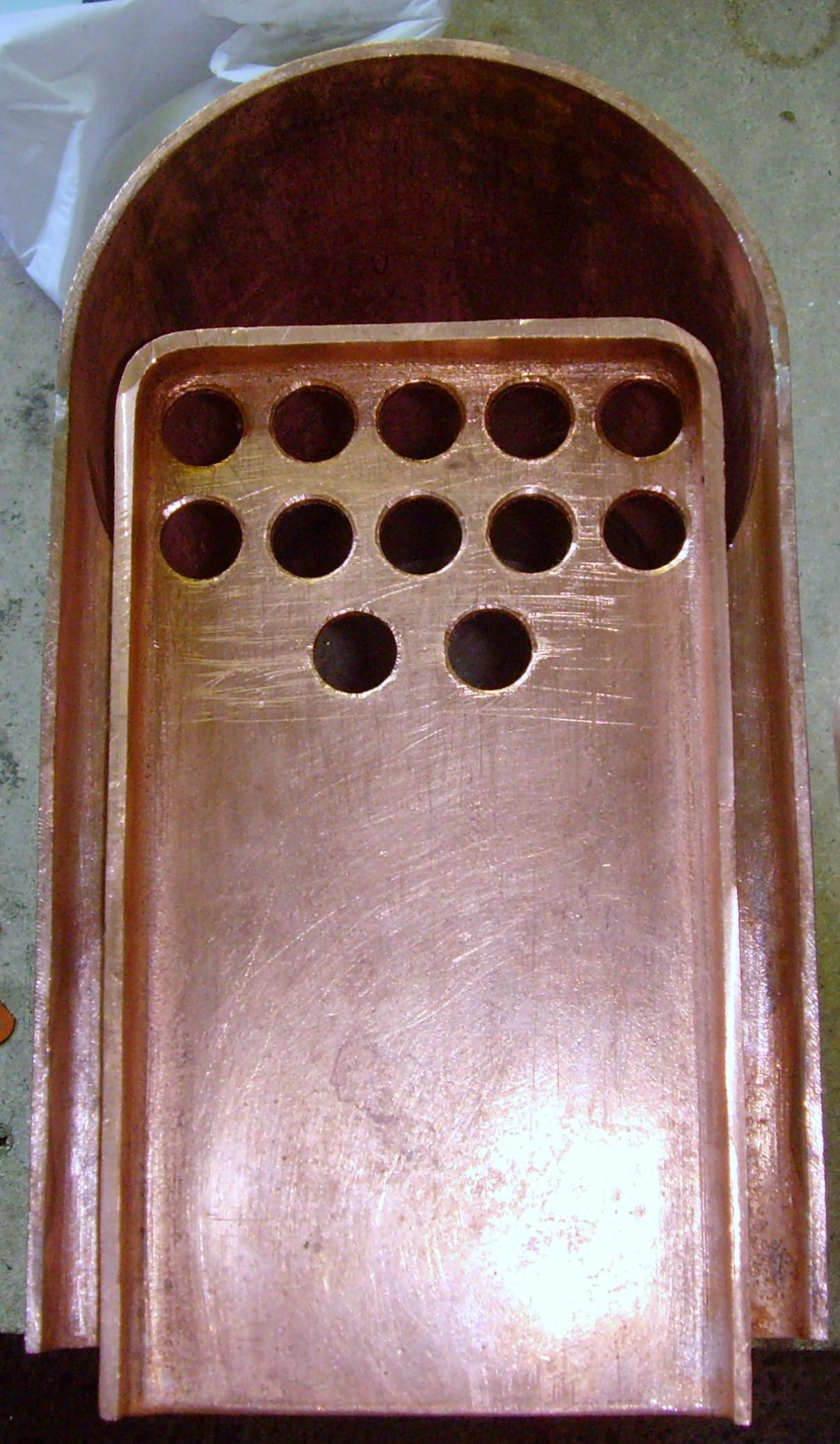

The boiler isn't started I but do have the materials ready. In the main I am using 10 SWG copper plate and as Jason points out you need to play with the tube diameter. It's a trade off between getting in as many flue tubes that are not so small as to get choked or too large as to make the boiler inefficient. Consequently I'm considering using 1/2 inch flues for mine, unless Jason tells me otherwise... :smart:
AndyB. Yes I made my own rollers for the front wheels but didn't really make them big enough so had to heat the metal up bright red to get it to roll properly. The rear wheels were made out of a piece of aluminium tube, not to be recommended!
Steve :beer:

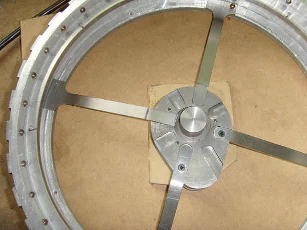

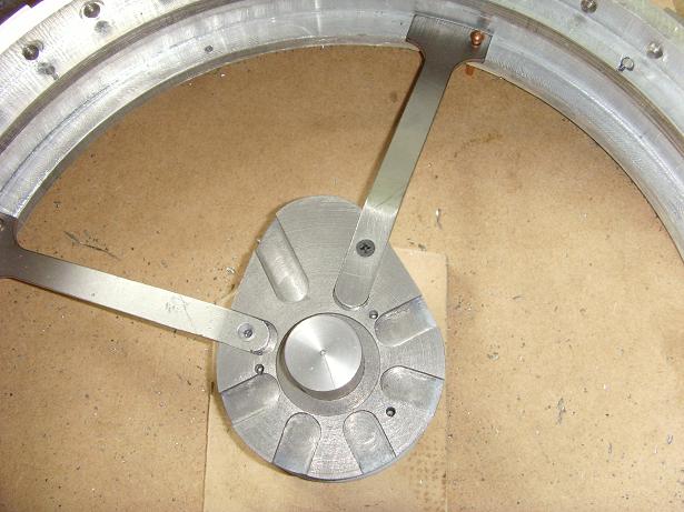

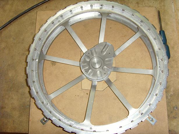

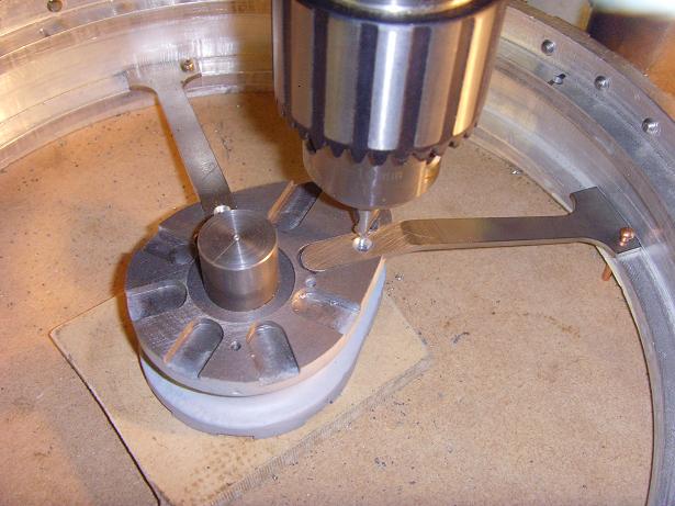

 :update:
Here are some pictures of the wheel buillding process. I pre drilled both the rim and the spokes with one hole only then bent and marked them ready for fitting. It's imperative that the spokes lay flat without any tension or a jallopy wheel will result. I used a rivet for location while the hub was drilled and countersunk. etc finally fix with m3 crews for the moment.
The final picture is with the wheel flipped over ready for the last 8 spokes to be fitted.
steve

 :update:
Voila, ready for rivets  :ddb:

« Reply #30 on: June 26, 2012, 06:36:08 AM »

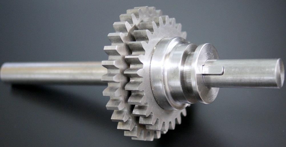

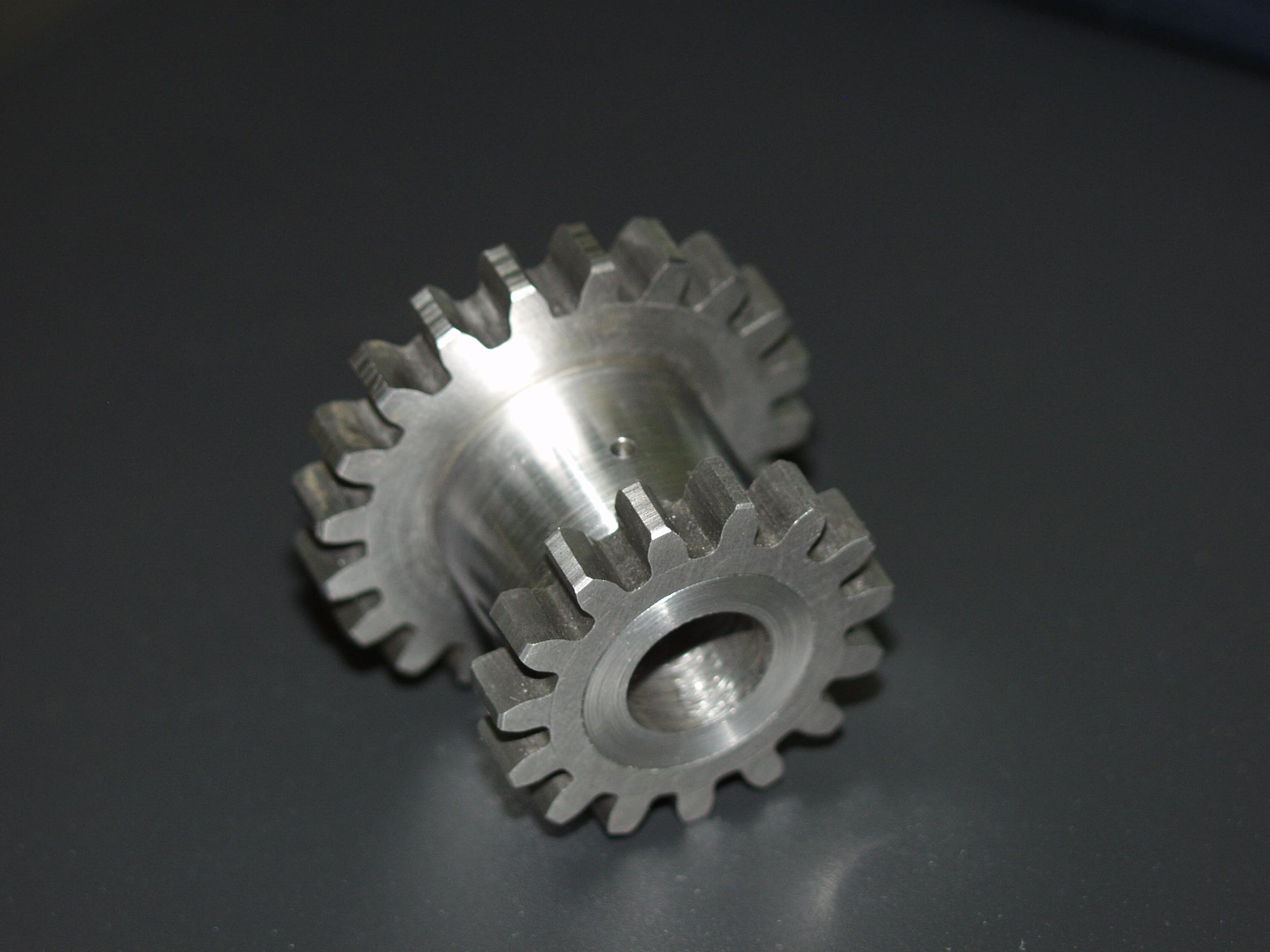

I have been busy cutting the gears for my Minnie. Hope you enjoy them.   :wave:

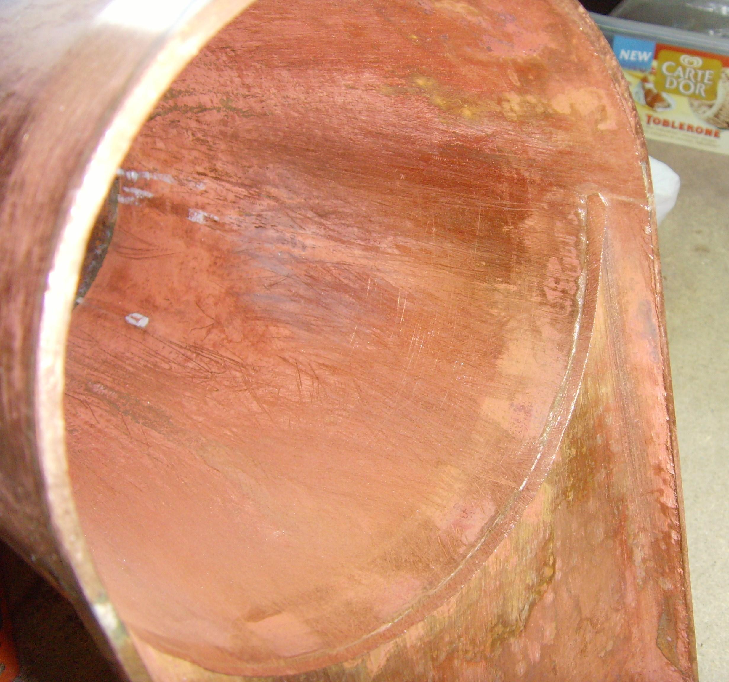

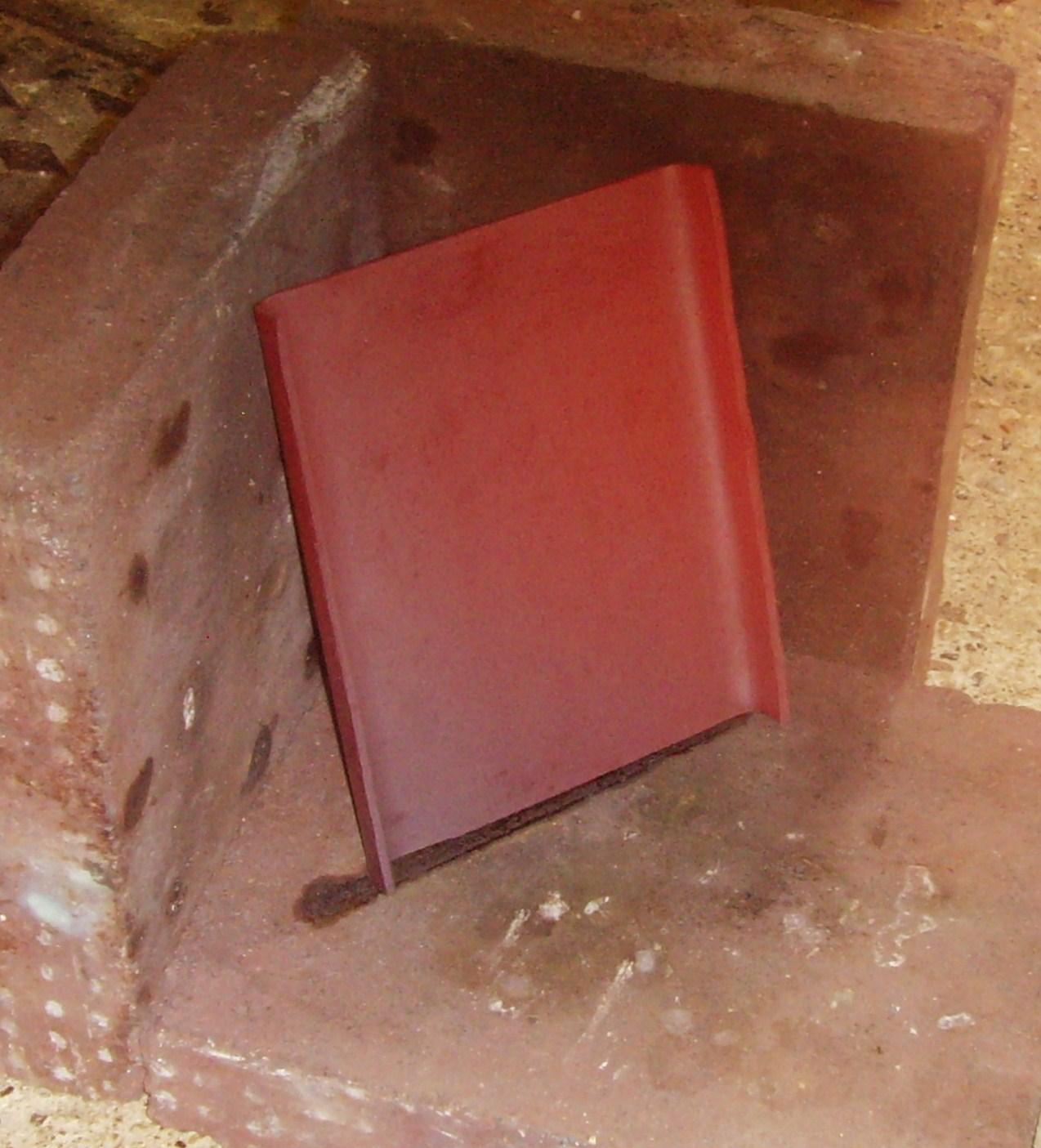

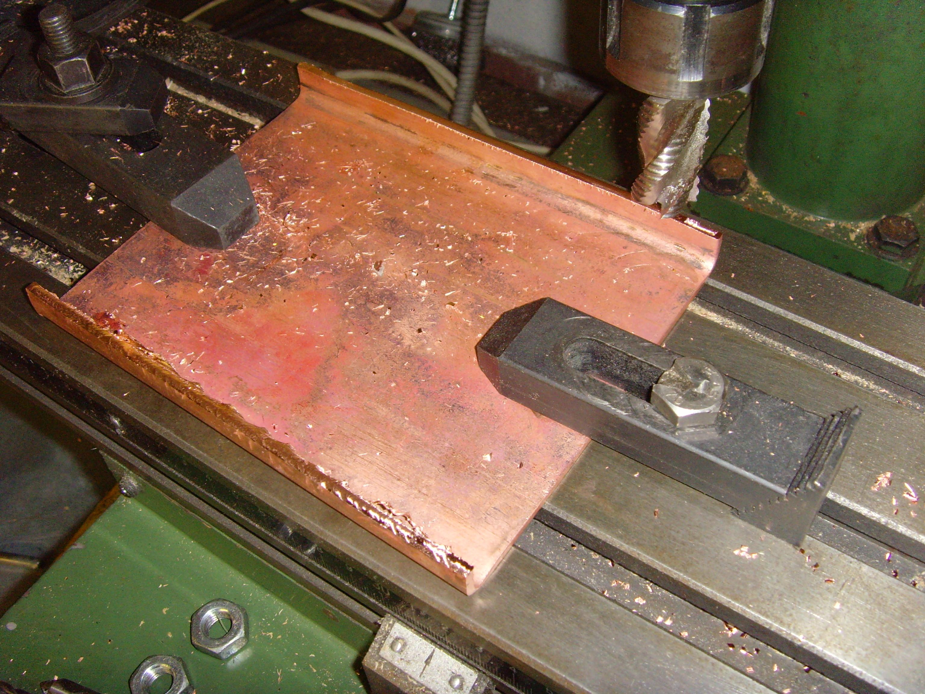

« Reply #31 on: June 26, 2012, 06:38:35 AM »

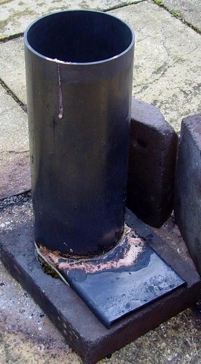

I have made a start on the boiler too.
