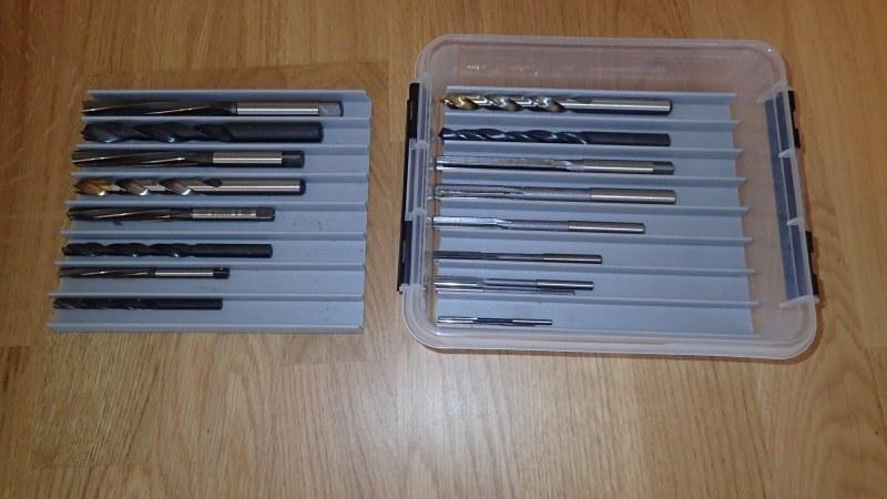

I may be going against the flow, but I don't constantly back off when hand tapping, certainly not the 1/4" turn routine. My reasoning is that because it is universan acepted fact the when you ream: don't back off - you chip the cutting edge. I beleive there is some extent same mechanics totapping too. I may ease a small fraction of the turn on very difficult material, just to assit swarf packing.

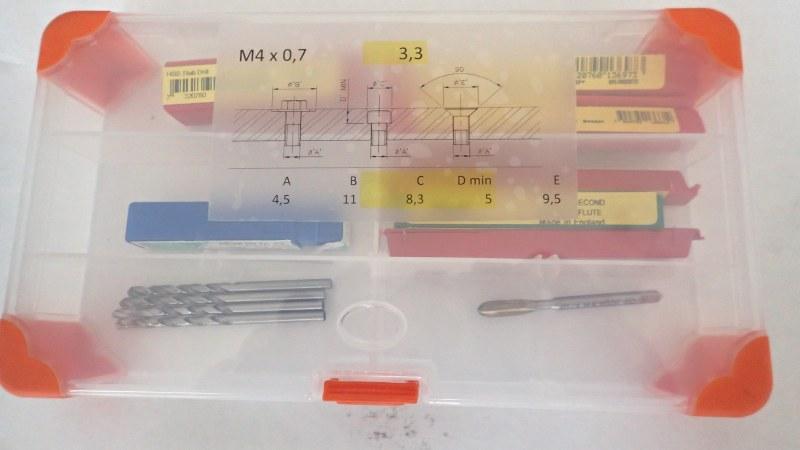

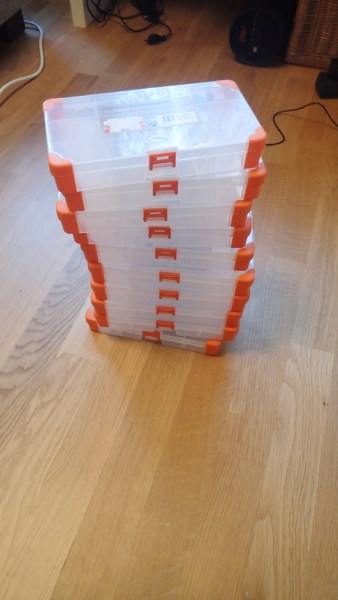

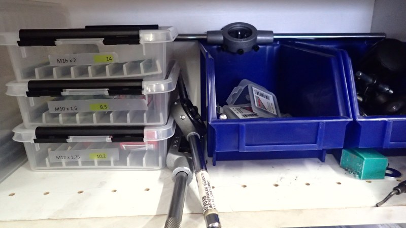

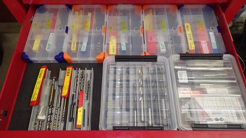

incidently I used some time to get boxes and organisize my tapps. The big idea is to keep one thread size (metric coarse) tools on one box: Taps, tapping size drills (by 10 each size, short), clearance hole drill, countersunk bit and recess bit.

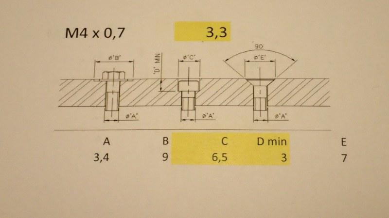

Too some time to design the apropriate sticker, nicked the graphics and all information from three sources.
Boes will stack two high, or I could nest them two rows, two high, but I'm using bigger box to accomondate reamers and their drills and one box for nonstandard taps.
M10 and biger stuff will go on bigger boxes on bigger sellf.

DOH. :doh:
Picture of the "sticker" above was from beta print....it has an error.
Finally I have by taps in order and I put 20 boxes on one tool chest tray.
