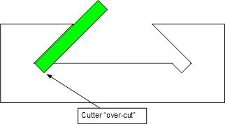

You can always cut the dovetails using a straight end-mill, if you don't mind losing a bit of material out of the back of the dovetail seat (is that the right term?) All you need to do is tilt either the head, or the workpiece, at the correct angle. The attached c-o-c should make what I mean clear.

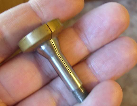

Jim, if you think carbide would help, maybe you could  :proj: concoct one of these:
 http://mikesworkshop.weebly.com/dovetail-cutter.html
I've visited Mike in his shop, and he does get good results with it, though he has to take things slowly on his Sieg X1 micro-mill.
