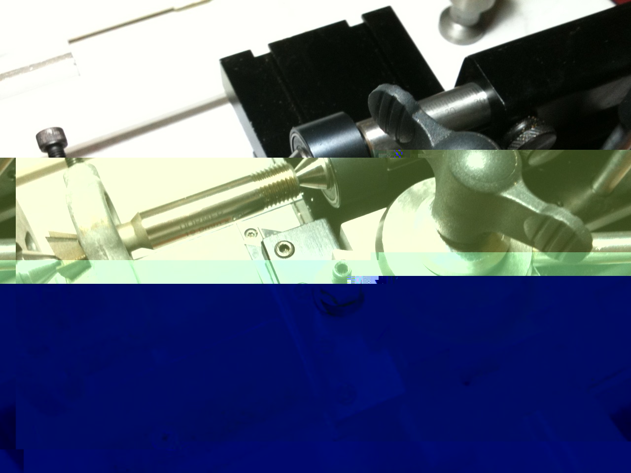

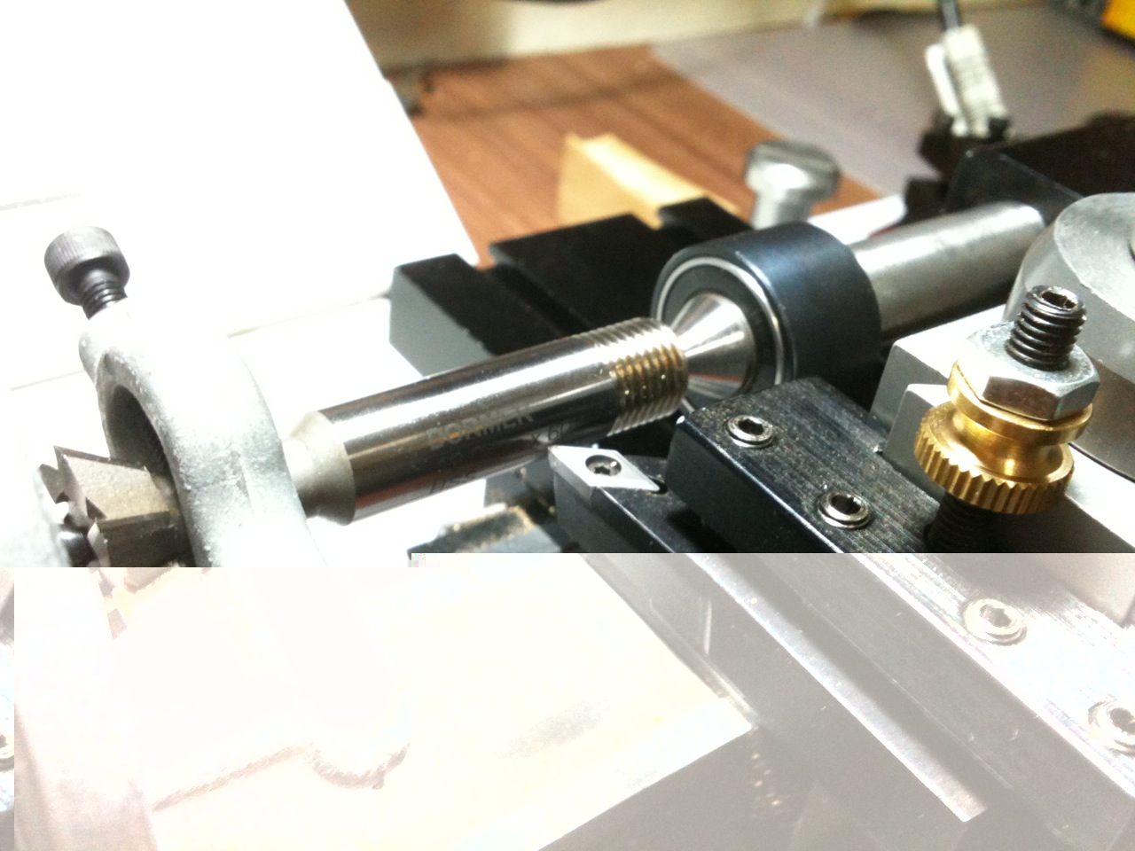

I couldn't stop myself. Couldn't wait for the shipment of the dovetail cutter which is of the right size.  I went over to the shop 2 days ago and purchase the Dormer dovetail cutter.  Expensive stuff but I just have to get something.  While I was there, I also bought a countersink cutter.
The dovetail cutter has shank of 12mm.  There are 2 small holes at each end that I can mount between centers.  I waited patiently till tonight (Friday night) for turn down the shank but I was disappointed.  I'm able to use the dog and surface plate that came with my sherline lathe but I'm not able to move my right hand tool to the end of the shank at tailstock end.  The tailstock spindle was turned to the max.  Some pics attached to show what I mean.
Appreciate any advice.
Thanks.
Wong

Well, one of the advantages of turning between centres is that you can turn one end of he work, then reverse it and turn the other, and things will stay concentric.
Sometimes it works, even for me  ::)
Re: Turning down the shank of dovetail cutter
« Reply #10 on: July 23, 2010, 12:59:13 PM »
Can you not rotate the QCTP so the cutter will reach the end? OK, the cutting angle won't be ideal, but it should still cut.
OR... it's hard to tell from the photo, but is the QCTP mounted in the left-most T-slot of the cross-slide? Could it be mounted in the right-hand T-slot?
Hi Ade,
The QCTP is mounted to the left most slot.  I've tried the right slot.  The body of the QCTP hit the body of the tailstock.  Maybe I'll try extending the tool bit out a little.  Hope it wouldn't flex too much.
Thanks for your input.
« Reply #13 on: July 23, 2010, 04:03:04 PM »
I'd take the quick change holder off and just use the tool strapped to the table with a couple of straps at the proper hight.
If you need a picture of what I mean let me now and I'll set up my Sherline up lathe to show what I mean.

« Reply #14 on: July 23, 2010, 08:02:16 PM »
Thanks Bernd.  Would strapping down the tool hold it firm enough for cutting?  A pic or 2 will be very much appreciated.

« Reply #15 on: July 24, 2010, 12:54:50 AM »
Just put the normal tool post for that lathe on the slide and go at it, Wong.  That QC setup is kind of enormous.

« Reply #16 on: July 24, 2010, 06:15:36 AM »
Thanks Dean. I have decided to dig out the normal rocker tool post to do it when I get home from work.

Finally managed to turn the shank down to slightly below 10mm (not due to my intent but a miscalculation).  The dovetail cutter now fit nicely on my ER16 10mm collet.
I started with the 1/4" HSS tool but after the 2nd pass, it wouldn't cut anymore.  Saw that the cutting edge was gone....  Changed to my carbide tool.  A little difficult to set a good cutting angle (too upright for my comfort) but the result turned out to my satisfaction.
Thank you folks for guiding me on this.  I'll start working on my tool holder for the QCTP so that I can use my little boring tool of 4mm shank.
