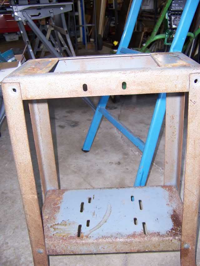

As I stated before I prefer to begin all my restorations by refinishing or building the stand first.  It is nice to have a finished place for the parts to be re-assembled without having to worry about scratching things trying to mount a freshly painted machine.
As it was.  I remembered to snap this shot just before I pulled the last bolts.  The rust and stains are from 59 years of neglect and abuse.
Bugle Bolts.  These are the infamous Delta "Bugle bolts".  As Delta no longer use or supply these I am fortunate that all 16 are present and accounted for.  I clean hardware by dropping it in a vibratory filled with walnut hull and let it run until clean.  After the rust is gone I will paint the heads with aluminum paint mixed with a bit of semi gloss agent to replicate the OEM zinc finish.
After sand blast and first coat of Rust-O-Leum Medium Gray.  I am not totally satisfied with the finish after this coat so I will probably color sand the parts again and re-coat.  The rust pits are showing a bit more than I like.

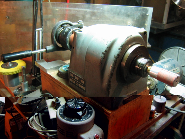

In today's installment of "As The Nut Turns":
I mentioned using a vibratory and walnut hull to clean hardware in an earlier post.  I have a couple of small vibratory cleaners (commonly used to clean ammunition brass before reloading) that I picked up at an estate sale for a couple of dollars each.  One is filled with "plastic media" and the other one is filled with walnut hull.  I use these for cleaning small carburetor parts and other small trim parts around the shop.  The abrasive media is available from Harbor Freight.  "Plastic Media" is small pyramids of some type of resin with a fine abrasive mixed in that is used for corrosion and to de-burr parts.  You need to use water with the plastic media similar to wet sanding.  The walnut hull cleans and polishes surface patina. Walnut hull needs to be kept dry.
For those in the UK you might look around some lapidary supply places for the small vibrators.  The rolling tumbler polishers will work as well but I have heard from some silversmiths that extremely delicate parts can be damaged if too little abrasive is used.
Before and after examples of parts cleaned in the vibrator.
These small parts are the table trunnion castings and the blade tension adjuster.  The parts are die cast Zamack (a zinc/aluminum alloy) and the original paint was peeling off  due to the lack of surface prep.  I simply wire brushed the old paint off, masked off any moving surfaces and degree scale then prepped with an ultra fine Scotch Brite pad (gray pad).
Here is a trick!  I keep a package of bamboo skewers around the shop to use as painting and hand polishing sticks.  The idea is to tape one to the part and use it to handle the part while airbrushing then sticking the skewer in a bucket of sand to let the paint dry.  For parts that have no masking to tape to, I wrap several turns of masking tape around the skewer and then thread it into a bolt hole.  I find that by taping small parts to the skewers I have better control than by hanging them up and having them blow around.  I hate trying to paint moving targets.
In case you are wondering why the silver paint in the photo, it is the under coat of a two coat urethane process.  The top coat is a tinted clear that will flash off leaving a silver gray finish that should wear well.

OK!  It's been a while since the last installment of "As The Nut Turns" so here is the latest installment.
I finally got a few days that I could spend in the shop and the weather finally co-operated so I could finish painting the sheet metal blade guards.
I had painted the frame castings in the last installment and set them aside to cure prior to re-assembly.  Here is the assembled frame with the upper wheel temporarily re-installed.  Sometimes I will temporarily assemble things, knowing that I will need to back track some for final assembly, just to get parts off the shelf and/or floor.
View from back of saw.
I did not take any pics of the painting process since it is just more of the same.  As the sheet metal parts are seen both sides the painting took a couple of days, first to paint the interior surfaces so that any marring from resting on the paint stands (plastic coffee containers) would not show when assembled and ready to run.  Once the inside surfaces were cured, I flipped the parts over and shot the exterior surfaces.  As the weather was kind of chilly it took a full day for the paint to cure.  Once cured, I re-riveted (OEM was a couple of plated brass rivets, but since those are hard to come by I shot and bucked a couple of dead soft aircraft skin rivets) the Delta tag to the upper blade guard and re-assembled the saw.
A closer look:
A view of the back:
The paint is not flawless and does have some dust and a few bug tracks, but the Asian lady bugs were swarming like crazy and the farmer across the road decided that it was time to chop silage just as I was starting to spray.  Since my first intentions were to do a "50 foot" paint job I am pretty satisfied for now.  I may redo the sheet metal after I get the motor situation squared away.
I am planning on bolting a 1/2 HP motor on just to dial in the cuts and check blade tracking and tire crowning.  Once that is set and the saw is cutting wood and aluminum, I am working on the variable speed treadmill motor package.  Stay Tuned!
Oh well, as the old saying goes "Beat it to fit, Paint it to match!" :hammer:
