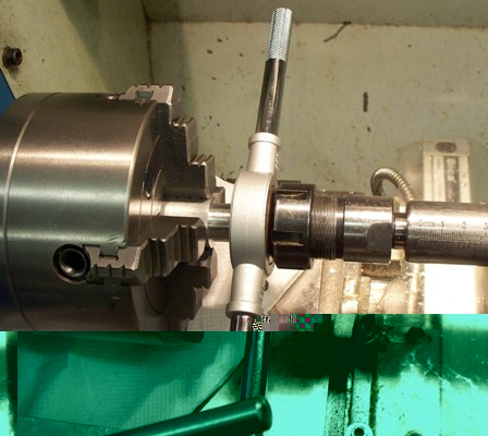

Not sure if you can do it with your machine, but I have used the front of the tailstock quill to get dies on squarely.
See attached pic.
In that pic (grabbed from someone else's site), he's using a collet chuck in the tail stock, rather than the front of the quill.  However, the front of the quill should do a good enough job, assuming it's big enough.

if the quill isn't big enough pop the tailstock chuck in and wind the jaws right into the body.
See attached pic.
No1_sonuk,
How was the die held in the pic?  Or it is just being pressed onto the stock?  Can't see that from the angle.
Wong

I also use the tailstock to press on the die/holder, as shown in the above pics.

« Reply #8 on: June 17, 2010, 11:01:37 AM »
Thanks for clearing this for me.
Appreciate all the responds.  Now looking for step by step pics on how to install the Thread Cutting Attachment.  I'll get the larger diameter steel/aluminum to make a die holder.

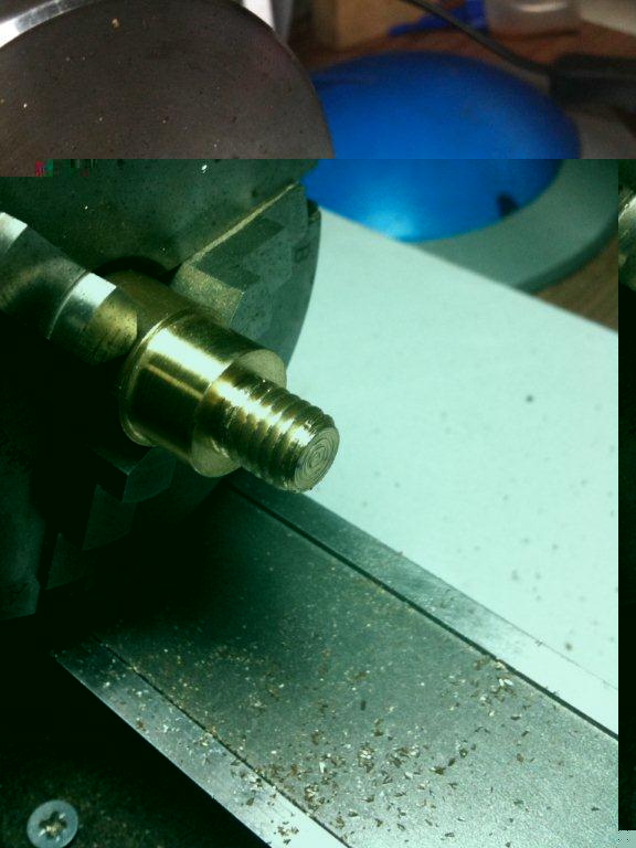

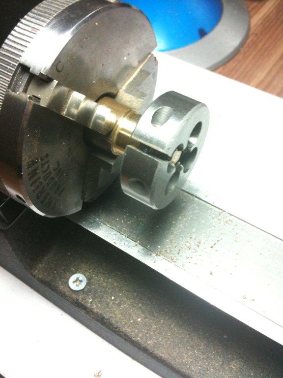

Offline wongster
  • Posts: 242
  • Country: sg
Re: Threading by hand
« Reply #13 on: June 18, 2010, 12:34:15 PM »

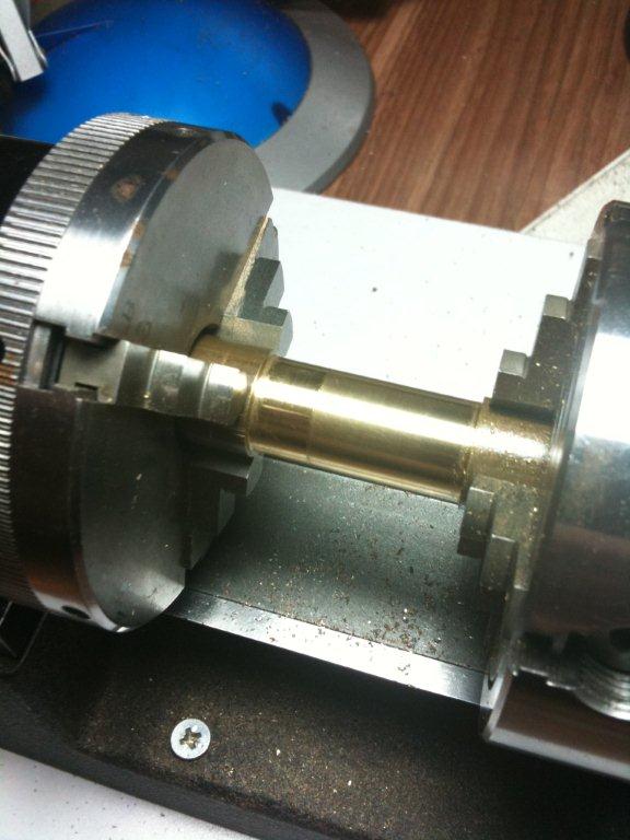

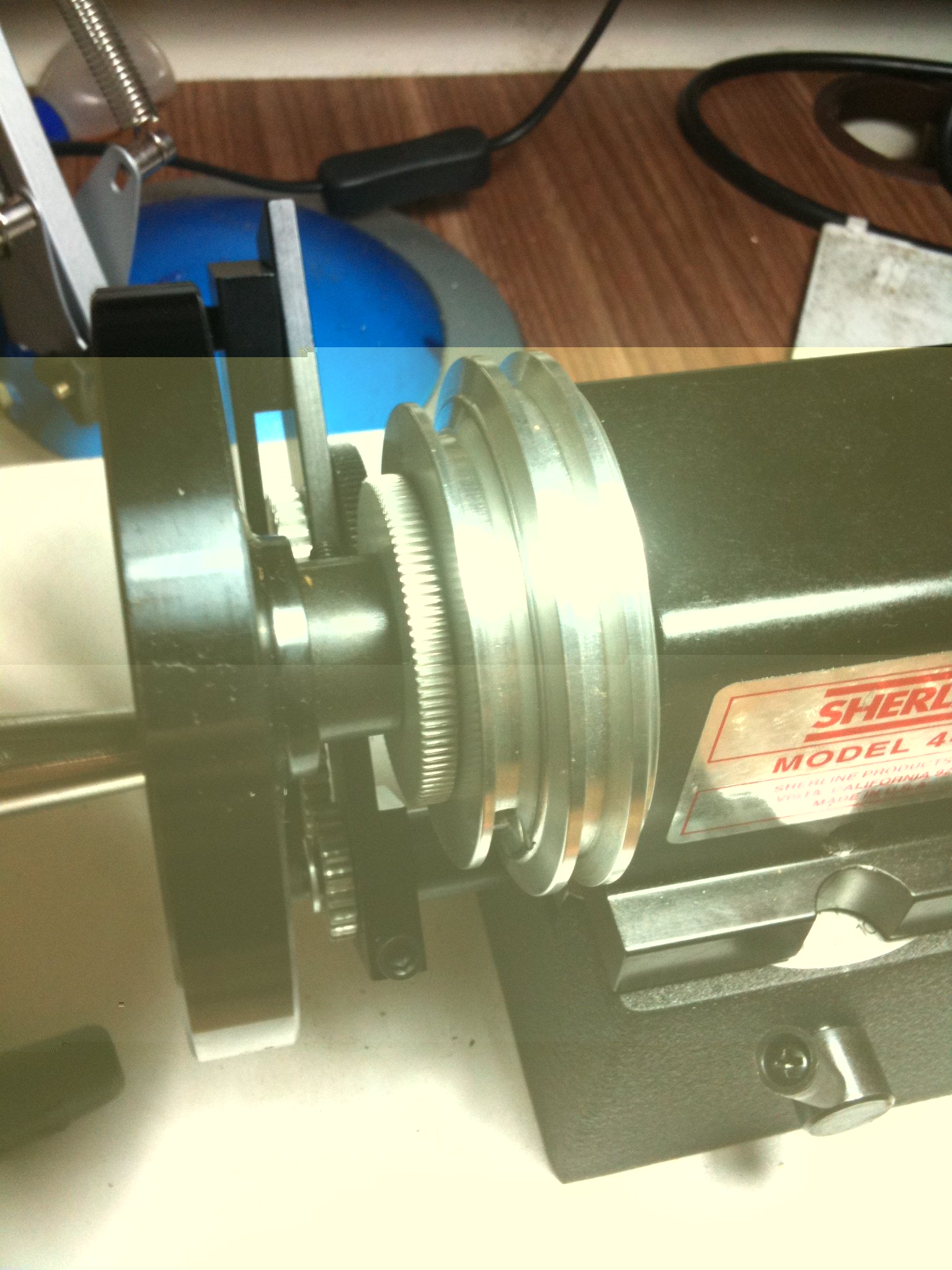

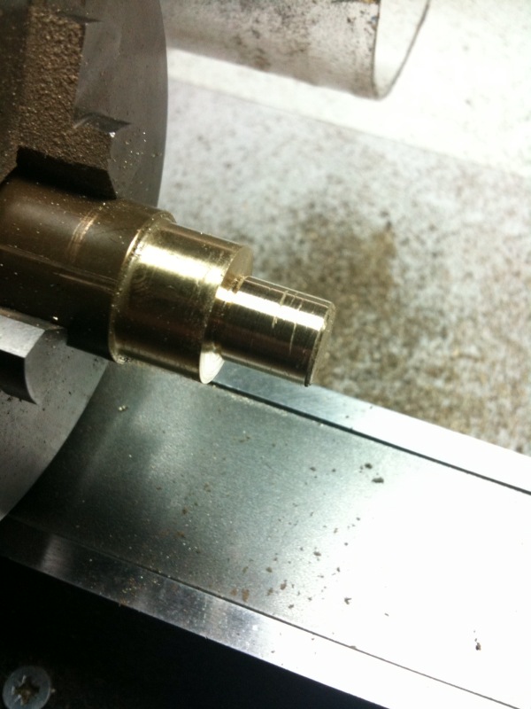

I managed to install Sherline's Thread Cutting Attachment but encountered a problem right after the first pass (0.25mm).  A little pin on the attachment snapped on the 2nd pass of the same depth.  I was scratching my head thinking what's going on with this threading business.  I found the snapped off pin and measured its diameter to be around 2.5mm.  Found a pin of almost the same size (2.3mm) from the pile of salvaged printer/scanner parts.  Hammered in the pin and trimmed off the excess.  I'm back in business.  The thread was done without further problem and I've my first threaded part!!!
I've taken some pics and posted them here.  The threads are not that nice looking but it threaded into the torch body without problem.
I've bought some 40mm aluminum stock today.  Will try to make the die holder as it is more convenient than having to install the Thread Cutting Attachment and remove the motor to the spindle everytime I need to cut thread.
Thanks for all your help rendered so far.
Regards,
Wong

« Reply #14 on: June 18, 2010, 11:12:57 PM »
Congratulations, Wong!
Threading seems to be one of the machinist stepping stones.  You're a step higher!
Dean

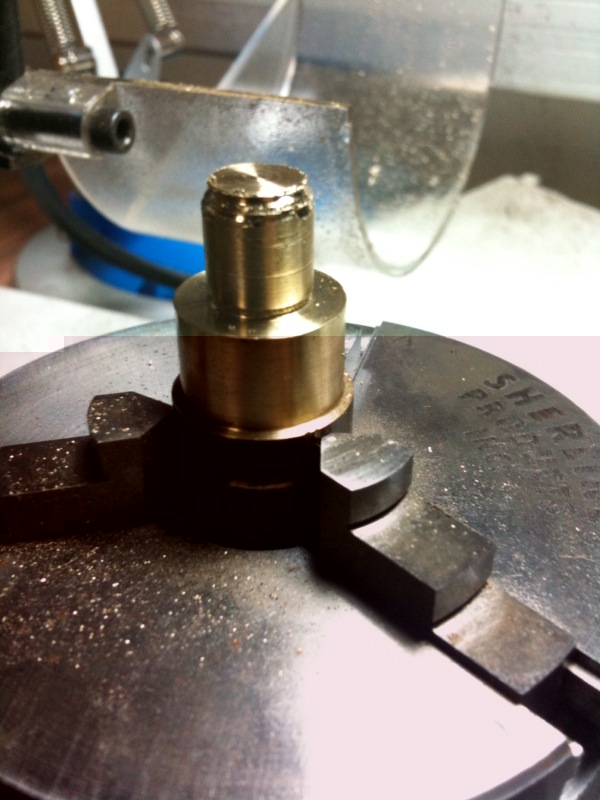

Offline wongster
  • Posts: 242
  • Country: sg
« Reply #20 on: June 19, 2010, 11:00:16 AM »

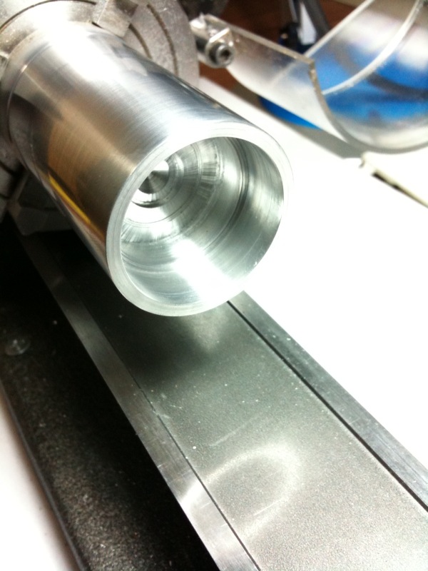

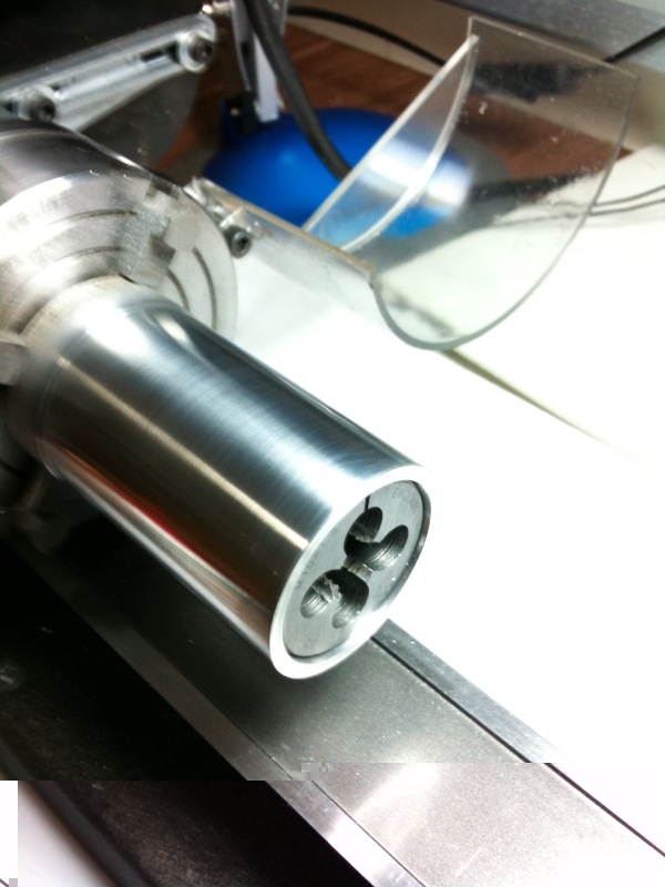

I've finally completed the boring job....  Some pics attached.  I was so carried away with it that the bore is almost straight through without the step to hold the die.  The final result turns out to be ok except the hole is a little bigger than the die.  Difference in size is less than .5mm.  Hopefully a couple of set screws will hold it right.  The interior of the hole looks bad.  As I was creeping up to the final size, the cutter suddenly took a deeper cut than the usual .05mm I set.  The smooth finish was destroyed in an instance.  Some sand papers were used (from coarse to fine) to touch up the error.  The workpiece must have moved out of position to cause this.
As I've no success so far in parting off on the lathe, I think I'll likely to turn down the other end from 40mm to maybe 9mm to fit in my 3/8 jacob chuck. If this is not advisable, I'll cut off the back portion using my vertical bandsaw.  This may be tricky as my V-blocks can take only max of 25mm.  Any advice on what I should do?
Regards,
Wong
Offline Reckless_Engineer
  • Posts: 16
« Reply #21 on: June 19, 2010, 11:19:05 AM »
Looks like it should do the job and certainly looks the part:thumbup: Grub screws will take up theslack fit of the die and also allow you to adjust the die.
The last cut sounds as if you had push off from the boring bar over the previous cuts and then it bit in on your last cut taking it over size. Next time take a second cut of the same dia. on your 2nd to last cut.
Also is there any reason you held it with the jaws that way around?? You have got alot of material hanging out of the chuck(another cause of the vibration) and the jaws would of been better the other way arond.
  • Posts: 16
« Reply #24 on: June 19, 2010, 12:24:50 PM »
I see why you had them that way around now lol :doh:
What you have is fine theres no point re-doing it the other way around.
When boring the boring bar has an habbiot of wanting to push off and flex away from the metal instead of cutting it! Hence the reason for using the biggest bar you can fit in the bore. If you put on a thou cut it may not cut at all, then another thou again not cut. It may do this lets say 4 times you measure again seeing a thou needs to come out so you put another thou on and now the bar doesnt push off and takes the thou and the previous 4 thous that didnt cut taking 5 thou off leaving you 4 thou over sized.
Im not the best person in the world at explaining things im sure someone will correct me if i have wrote something wrong but at least you get the idea.
Oh and on the reckless part, I know more than enough to class myself as Dangerous :zap:

Ah... I got what you meant now.  Strange that it was cutting at every pass of the same depth and suddenly the cut deepened.  Maybe it was cutting less than the amount I dialed and the accumulated amount kicked in all at the offending pass.
Any idea how I should drill the hole to hold the die without a rotary table?  Or I should get one for this and future projects? The Sherline's rotary table cost quite a bit and there is still the decision whether to go with the CNC ready or manual version.

I found the hardest bit was to position the holes for the setscrews which hold the die in place. They have to be the right distance from the bottom of the counterbore; too close is better than too far away, because in the latter case the die isn't properly supported from behind and can tilt slightly as it is forced on to the work. If doing it again, I think I would drill the holes first, then bore out the counterbore to the right depth while making trial fits with the die.
Another problem I had, being merely an amateur tinkerer with no rotary table, was that though the three screwholes were at 45o to each other on the outer surface (and for me, marking out for that was easier said than done) they certainly didn't come out that way on the inside. I ended up enlarging the holes so I could get a silver steel (drill rod) punch through to mark for three new holes at the correct angular spacing on the opposite side of the inner surface of the bore, then following up with a drill to drill from the inside. That rescued the job, once the unwanted holes had been plugged.
By the way, it looks from your pics as though the body of the holder is long enough to bore out for a different size of die at the other end. My dies are all either 13/16" or 25mm, so I made my dieholder double-ended.

....The die I have has a slit for a long pointed bolt and 2 dimples at 45 degree.  I'll get the first hole right and hopefully don't need the other 2 dimples to hold the die in place while turning the holder. ......
Hi Wong,
you really should try to accomodate all three setscrews when you're actually using the dieholder.
The two dimpled ones are the main securing mechanism, but the central one which bears on the slit has a different function - the conical point acts as a wedge and gives a measure of control of the size being cut by the die.
If you screw in as hard as you can on that central setscrew, it opens out the split in the die, so the circumference is greater, and the finished thread can be a little oversize; relax the wedging pressure in the split then when the other two main securing setscrews are tightened, the split is closed and the resultant thread is slightly undersize.  Also, because its in the split, the central setscrew does give some rotational anchor, but doesn't have great holding power axially.
The normal method is to apply as much pressure as you need to the central setscrew, and then tighten the other two to (a) hold the die in the holder, and (b) push in against the wedge effect of the first screw that has pre-set the amount of open split.

Had a little time earlier this evening to spend some time in the shop to complete the Die Holder.  The back was drilled and tapped for 3/8"-24 for the MT0 adaptor.  I took the easier way out for this die as its OD is different from the set I bought.  I may go with the floating die holder next, but that will be after I finished at least 2 brass torches.
A couple of pics attached.
Thanks for all the help I get.  Appreciate them.
Regards,
Wong

Nice job, Wong - I'm sure you will find it very useful.
In the background of your the photo, is that a chip shield made from locally sourced materials - a bamboo curtain, no less?

Thanks Andy.  I'm quite happy with the result despite the "ugly bottom".  Wanted to face it off but have no confident of doing it right. Since it can't be seen with the die on, I left it alone.
The "chip shield" is a window blind bought from Ikea many years back.  We're using them in the bedrooms as we're too lazy to wash curtains made of fabrics...
I just realized that I posted this thread in the wrong section... Thought I clicked "How Do I"....  Pardon me for this.
