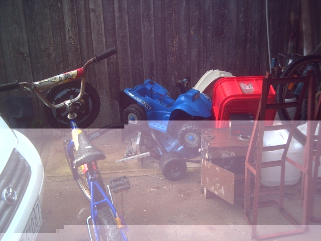

003 Awaiting suitable sized front wheels hub motor from crashed escooter 36v 200watts.
001 - 002 ebike in construction 24v 250 watt motor chain drive to old mini bike wheel used as friction drive to
         26" standard mountain bike.
004 Donor vehicle pile.
 It amazes me the quality of the stuff that gets thrown away.
My philosophy "It doesnt need to be pretty, its nice if it works, but it must be FUN to try"
br

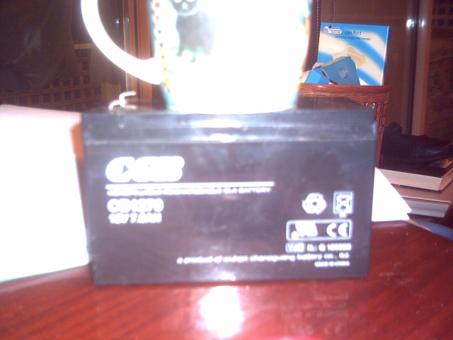

Another find at the scrap yard last week. Heap of 12volt 7ah sla's.
Coffee mug is to give some idea of size.Story is local security firm services their customers alarms every May
this entails changing out the standby batteries, as they have been on tricklecharge all the time the majority are perfectly good so I grabbed 12 at $2 each.
Did I mention I'm a pack rat?
The motor on the mountain bike is 24v so I may try 3 bats giving 36v The scooter hub motor came with a 36v pack and controller again perfectly good I may try 4 bats for 48volts.
The only thing I have had to purchase new is a Hall effect throttle $14 on Ebay cos the the controller wont work using a potentiometer.
Should be ready to test the mb on monday will try to make a video.
