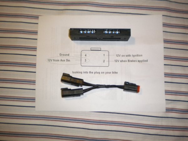

I made a power bus for Harley's or any other low voltage machine, I have it in patent pending mode right now, the purpose of the device is to give the user a place to pick up voltage to run all of there extra equipment on the bike, it keeps them from having to remove everything above the battery to connect to it. I named it the SR9..

I have a good friend that some very expensive Harleys and his need to add heated gear, GPS and a few other accessories inspired me to come up with that device, it is made out of ABS and the bus bars inside are made in aluminum with 10-32 NF socket head screws to hold the wires in place.
