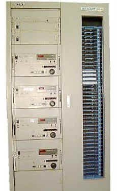

 Hi Rob ,
     like this sony betacart  that used to give me nightmares several years ago
 both the betacart and the 4 vt players had several  8bit Z80 cpu in them
