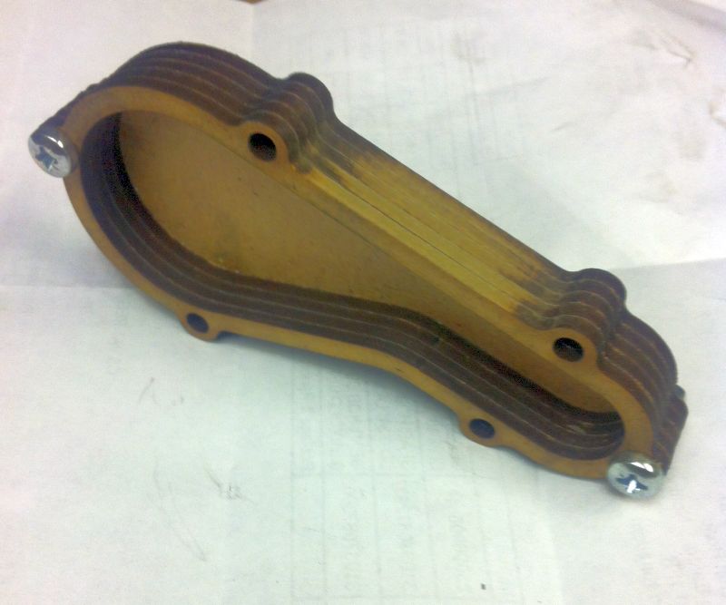

Well   :proj: has struck again ,,,,,,,,, Now that most of my machines are sort of done and the furnace is up and running , i thought i better start yet another engine project , well i wanted some excuse to do some casting , I bought the plans for the R&B Gas engine a few years back because its a nice big-un  ,,,,,,Then when i looked at the plans i found out i could not cast the parts due to the size of my old furnace  :bang: :bang: :bang:.
So this afternoon i made a start on the patterns for the bed casting , The bed plate as drawn is  some what plain ,so i re drew the bed adding a bit more detail , it should look like dis , i hope
Progress so far ,,,,,,,,,i only use the straightest / close grained MDF for my patterns .
Regards Rob

Re: R.W Gas Engine
« Reply #1 on: May 16, 2010, 04:05:32 PM »
The grain is running the wrong way on the mounting feet  :poke:
John S.

« Reply #3 on: May 16, 2010, 06:37:32 PM »
Im watchin ... Im watchin..... mdf is crap to work with isnt it.... 'specially that 'straight grain stuff'....
Thats a complex plug mate, you gonna pull it apart for us so we can see up under its skirts? I find this part fascinating... visualising something so you can make it removeable from the sand is not always easy. In essence you are working to create a reverse image.... I think you have to be a bit of a nutter to be able to do it well.... sort of twisted and axxse about.
Hurry up n fire up the furnace...  :clap: :bow: :beer:

Hi John ,,,,, :lol: :lol: :lol: so it is  :lol: :lol: :lol: :lol:
Thanks shoey51  :thumbup:
Hi Rob ,,,,,,,,, yep MDF is pretty crappy stuff  :lol: :lol: :lol:,, but its the only stuff that dose not warp , NE UK is a tad damp  :bang: :bang: ,, I have done a fare bit of head scratching  today on this one  :scratch:  , There will be one pattern and two core moulds , when moulded i will stick the two cores together ,,,,,,,,think it will work
Cheers Rob

« Reply #11 on: May 18, 2010, 02:58:42 AM »
Rob, is it just the photos or have you not put any draft angle onto the parts?
And just a point about the MDF it can easily swell in width in a damp enviroment, the MR MDF (moisture resistant) is a lot better in thar respect anf generally a lot better to work with.
Jason
Only way to find out is go! So lets go..... this is a very complex pattern mate, looking forward to seeing it all come out of the sand.....

Hi Lads
Thanks David and Dave  :lol: :lol: :lol: :lol: :lol: :lol:  David ,, starting on your job as soon as i have given this one a coat of paint  :)
Hi Jason,,,,,,,, yep  most of the draft is on ,,,, still a few nights work left on the pattern ,
Hi Rob ,,,,,,,,, Your right there mate , allot of work in making patterns , i could have welded this up in half a shift  :lol: , i hope you get those shaper patterns , building a shaper would be a great project
Cheers Rob

Hi all, fine looking pattern, I expect you must have got all the draft right cause no one would try to pull a pattern that complex out of sand without being sure it was going to come up without the sand. :lol:  I've only made a few patterns in my life, and machined lots out of billet, it seems making the pattern is as much work as machining the billet, but not so dodgy on accuracy, and once it's cast, lot's less machining, since the casting has its pattern established in, well, the pattern.  I'd sure like to see pictures of the ramming up and pulling of the pattern, and certainly the pouring.  Looking forward to this build, looks right interesting. :thumbup: mad jack

« Reply #17 on: May 18, 2010, 04:45:27 PM »
Hi Mad Jack ,,,,,,,, i hope i have it right  :smart:
A few more photos ,, its now split into what will be the Pattern and core box's ,,, i still have all the fillets to do .
Cheers Rob

« Reply #20 on: May 20, 2010, 04:53:54 PM »
Hi Lads
Thanks Eric ,  :thumbup: your more than welcome
Hi Dean ,, I will post up all the steps in the moulding and casting process , plenty photos ,few words   :lol: this build could turn into a long post .
Tonight work , the pattern is just about finished , it still needs the lettering done , filleting,and a coat of paint , about a good nights work still left in it.
I must put an M&M in the shot for scale  :lol: :lol: :lol: :lol: .
Then i had a brain fart ,,,,,,,, will the core fit in the oven  :bang: :bang: :bang: :bang: :bang: nope ,,,,,,,,, :bang: ,,,,,,,,,, looks like plan B ,,,,,,,, i will have to get some sodium silicate to use as a core binder .
Cheers Rob

« Reply #22 on: May 21, 2010, 02:44:18 AM »
Rob another way would be to stack 4 casting boxes one on top of the other, the middle two would have to be exact height of the pattern you could then pull each pattern from the mould and save making a core. Though it may not pour so easily on its side

Hi Lads
Cheers Rob .T ,,,,,,,,, :lol: :lol: :lol: :lol: I have the same problem now i have extended my workshop ,,,,,,,, :bang: IF big IF i finish my 4" Tasker Tractor i cant get it out the garden  :lol: :lol: :lol:      Yep thats the stuff  goes of with CO2 . :thumbup:
Hi Jason ,,,,,,,, I had thought of using CHEEKS ,,,,,,,,,, boxes that go between the cope and drag , but opted for coring ,,,, I may get away with a green sand core ,as they are fairly large ,, The only way to pore this is on its side  , fingers crossed
Cheers Rob
