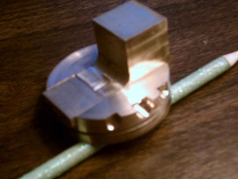

« Reply #3 on: May 09, 2010, 09:06:54 PM »
Ball turner
« Last Edit: May 09, 2010, 09:11:24 PM by johnny123 »

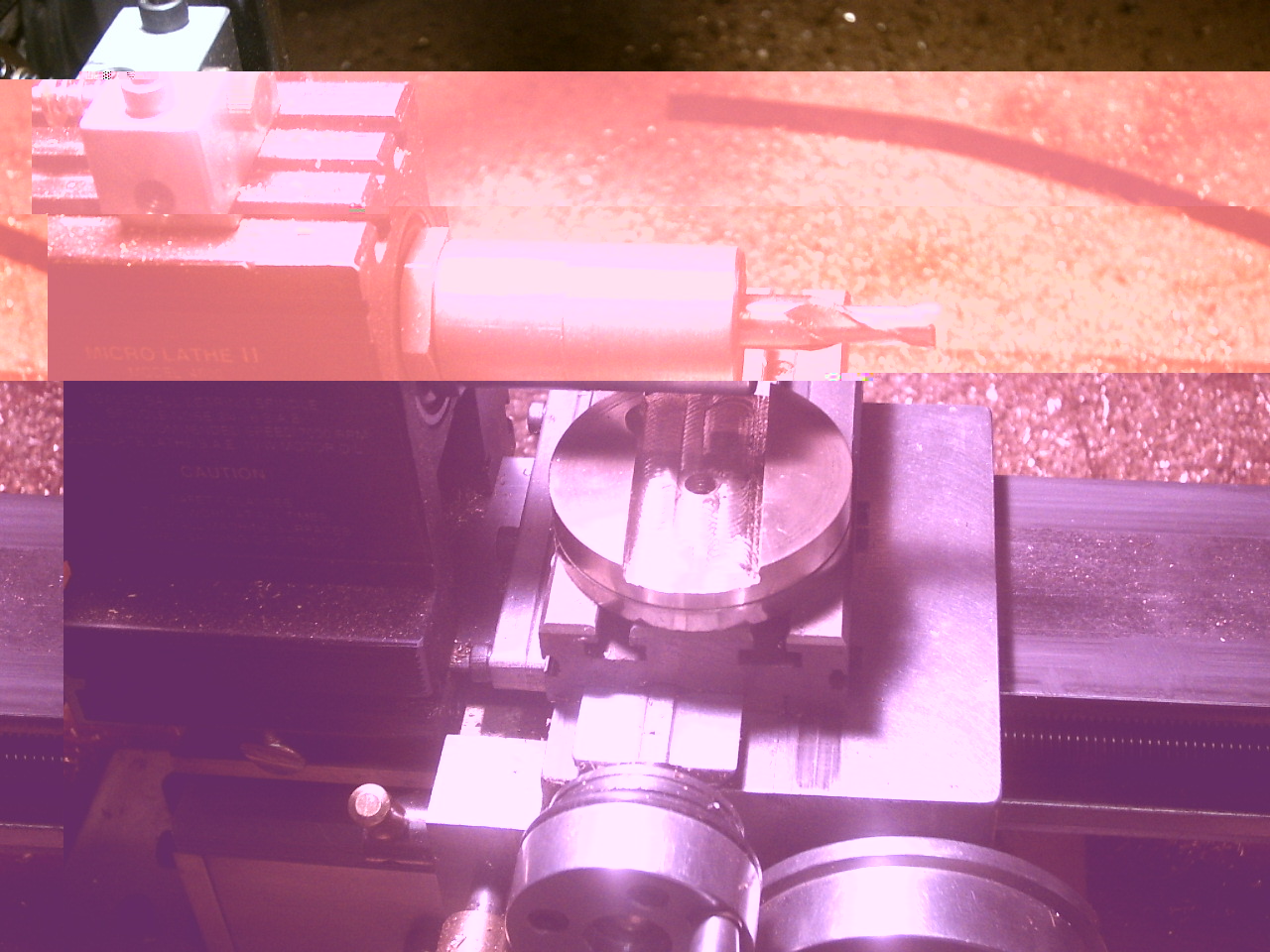

« Reply #4 on: May 09, 2010, 09:24:25 PM »
more stuff
Parting out,and my big wheel for the quill!
« Last Edit: May 09, 2010, 09:26:30 PM by johnny123 »

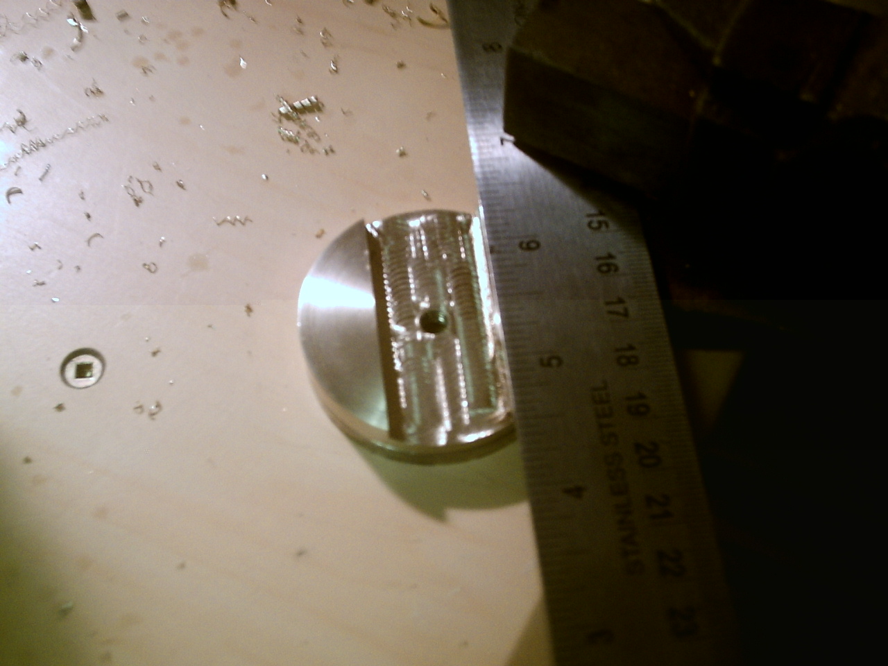

« Reply #5 on: May 09, 2010, 09:31:11 PM »
Mor ball turner

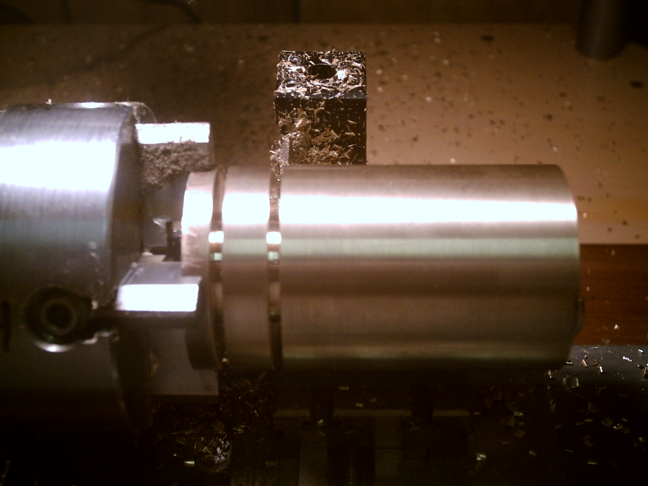

« Reply #7 on: May 13, 2010, 07:40:11 PM »
Still Roughing it out!

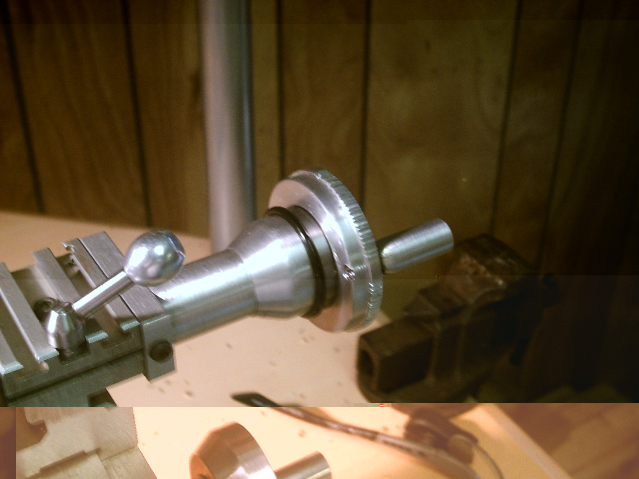

Hello everyone, Finally finished the ball cutter and it works great!!
Offline johnny123
  • Posts: 77
Re: Ball Turner
« Reply #18 on: June 02, 2010, 08:08:37 PM »
Sorry that last one I forgot to resize. Here is one that fits the screen. :lol:
Offline Stot
  • Posts: 66
    • Chrono Connect - Ballistic Logging
Re: Ball Turner
« Reply #19 on: June 03, 2010, 02:42:07 AM »
My thats shiney. :clap:   Did you use it to make the ball knob on the handle already?
Stot

I sure did make that ball on the handle with it. As you can see by the quality of my photos my video would be interestingly poor.
Offline madjackghengis
  • Posts: 717
  • big engine
Re: Ball Turner
« Reply #22 on: June 03, 2010, 08:11:40 AM »
Hi Johnny, I guess you didn't need me to do drawings, from the looks of things, you got everything done nicely, and given its already produced a ball, you have officially finished off a successful ball turner, congratulations, it looks good, it works, and its shiny, what more could a man ask for? :ddb:  I think you'll need to keep an eye on keeping oil between its "ways", but the fact that all the real force is downward should mean you won't have problems with flex or the brass being less than up to the job.  I'm glad you got it without pictures, because I haven't learned how to make drawings and such, much less post them somewhere.  I'm still a tadpole in computerland, and not much in a hurry to change that, not any faster than I need to.   :bugeye: :clap: :thumbup:  Now you've got to let us in on the next project, and what you intend to do for an encore.  Great job and I appreciate the build log :headbang: mad jack
