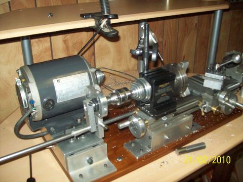

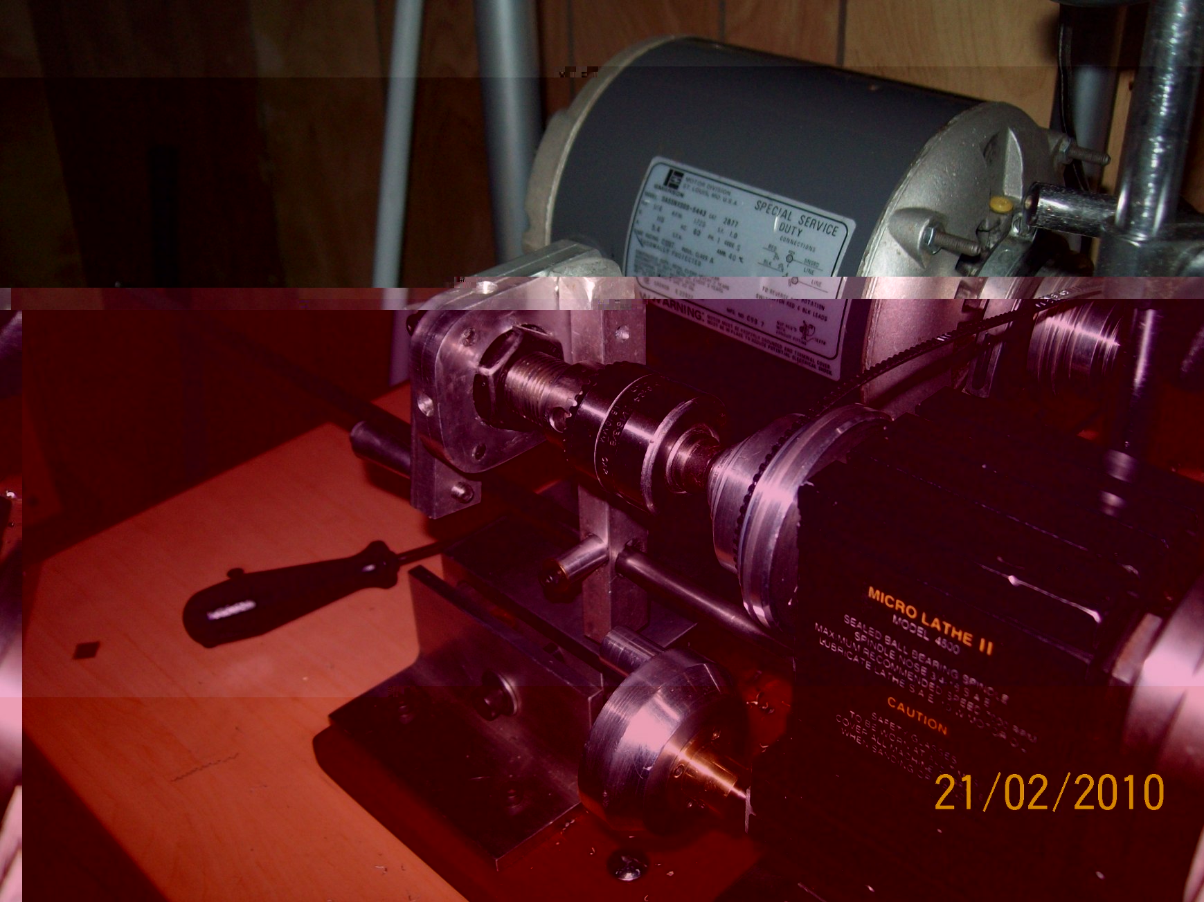

And here is my version of a threading duplicator which originally was for 3/4-16 threads so i could use my taig chucks on the aa109 lathe :thumbup:

Gotta explain this one to me... how does it work?  :scratch:

Eric, it's a chaser that uses a master thread to move the carriage via a bar behind the bed.  It's become kind of popular with some of the Taig folks.  Unimat used similar in the 50's-60's, and some of the early precision makers in the late 19th and early 20th centuries.  Pretty neat, once you have a number of masters made up.
I think if you search "Keith Brooks threading" you will be able to get a good look at the works.
