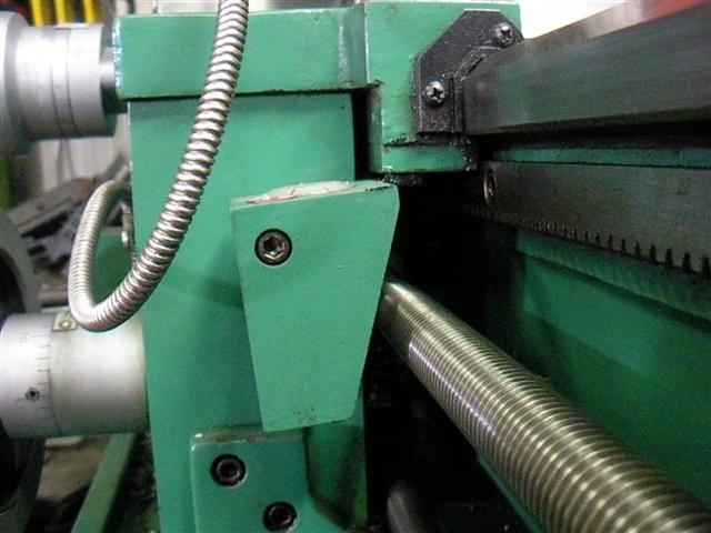

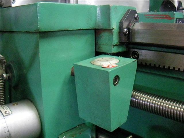

Here are some pictures from my 12x36 Chinese lathe, it should be the same. The hole is 75mm down from the top and 50mm in from the front.

« Reply #7 on: April 19, 2010, 08:26:43 AM »
One more photo
Also the hole is above the oil level, so no worries there.
