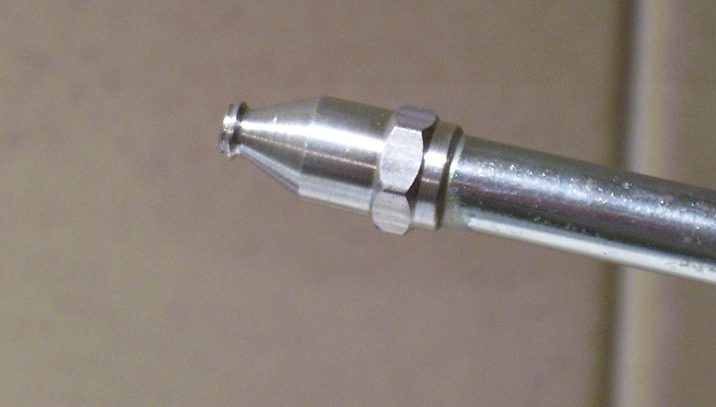

I use one of these little things.  You can push down that annoying little ball and slip the needle right past it.
Then oil to your heart's content, and it all goes in the hole!
You can buy them at supply houses that deal in parts for small mechanisms.  Clock supply, camera repair,
 electronics suppliers, and like that.
Hope this helps.

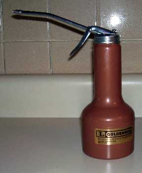

Here is the oil can I use on all the oil nipples on my lathes. There is another similar pump type made by Plews that works as well as the Goldenrod.
