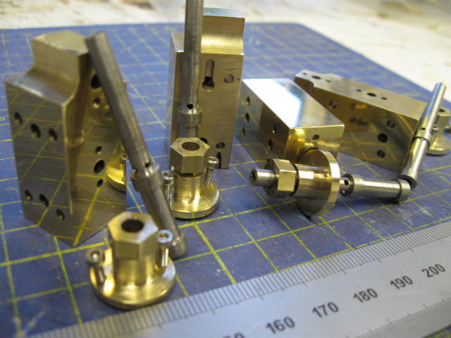

Anyway, this pic shows cylinder blocks in CI, pistons and rods, top covers and bottom glands. Also is one brass block machined square for a crosshead, others not done yet. (the line on the block is a machine mark - to be polished out later)
Ian

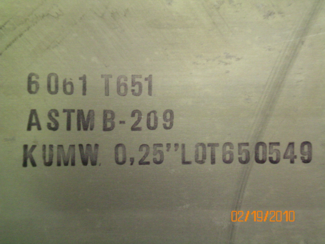

Re: Yet another paddleducks engine build
« Reply #11 on: February 19, 2010, 09:18:54 AM »
Interresting specs. They say international, yet I don't see a spec for 6061 plate.
I've attached a pic of the 1/4" plate I have. It's just for point of interest.
« Reply #12 on: February 19, 2010, 10:36:39 AM »
Bernd - I believe 6061 is an ISO designation; but 6063 - I was told when I spoke to Mersey Metals last - supercedes 6062 which, in turn, superceded 6061. I presume the formulations are very subtly different, but I can't tell for sure.
If you want, I can ask a specific question or two of them on Monday, when I go to pick up a bit of steel I've ordered.

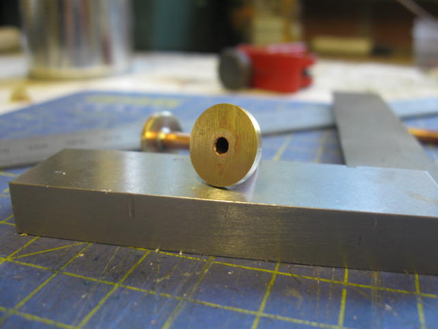

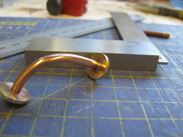

Managed to get a few hours in the workshop today. Spent 2 hrs figuring out how to mill a radius using the dro, then realised I wasnt taking into account the dia of the tool DOH!
Had one misshap, fortunately, no damage to the mill or tool, just some dints on the work piece oh and I escaped injury!
What happened, got my climb milling and conventional milling mixed up. Ripped the brass out of the vice and sent it across the workshop - lesson learnt! ( it was only a 0.2mm cut as well!)
Anyway, the pics show some brass hacked out of a length of round bar, first into rectangular blocks, and then into 2 croosheads - only 2 more to make now :thumbup:

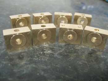

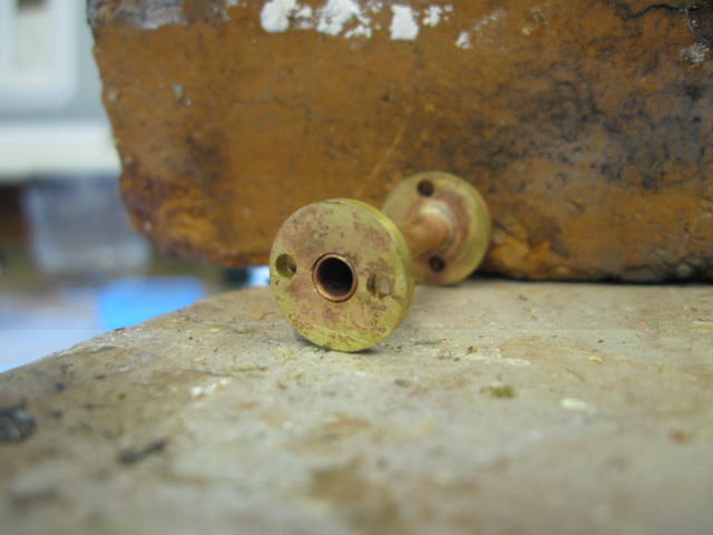

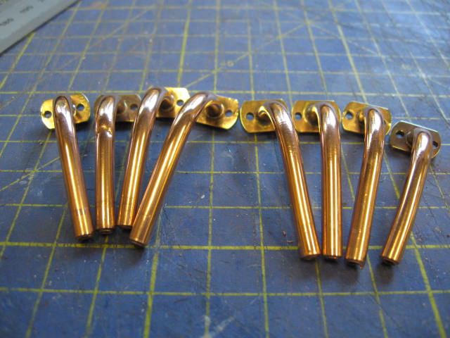

I got a day in the workshop today, so thought some steam engine work was in order.
I started out with a length of bronze as you see in the first picture, and after several hours of hacking, sawing, swearing, filing and drinking coffee, I ended up with the items in the second picture. These are the bearings for the engines, they are not quite finished yet, they need a cosmetic cut just to make them prettier.
Ian

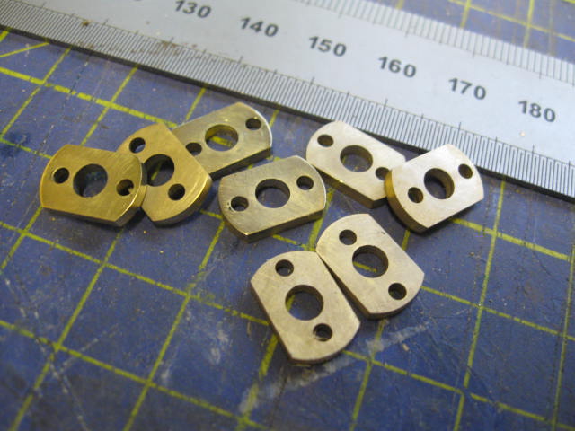

I gave the bearings a nice cosmetic cut today, the first pic shows them with a set of crank web blanks.
The second pic shows one set of ten webs almost finished.

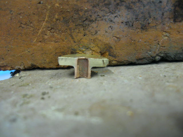

So, this morning I went out to the workshop thinking to have a practise with my shiny new slitting saw, ready to do a cut on the crankwebs.
Not to be! I mounted the arbor and saw, ran it up to the test piece only to find it wasn't running true. Investigations found that the R8 arbor had been machined too long at the top, preventing the taper from engaging properly.  >>:-(
So, a call to the supplier and a replacement is on its way.
Meantime, I decided to have a go at the cylinder base and crank base plate.
The picture shows the results.

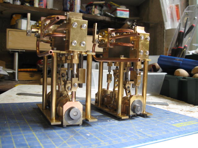

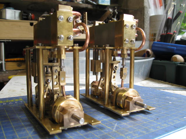

« Reply #29 on: April 28, 2010, 10:39:12 AM »
Well, I spent the morning fiddling, fettling and polishing, and now I have one crank complete, except for eccentrics, and it even rotates! Need a little bedding in, but it will be ok.
Kvom, yup, done the sharp edge bit! Been there got the scars to prove!
Ian
If it works, take it apart and find out why!

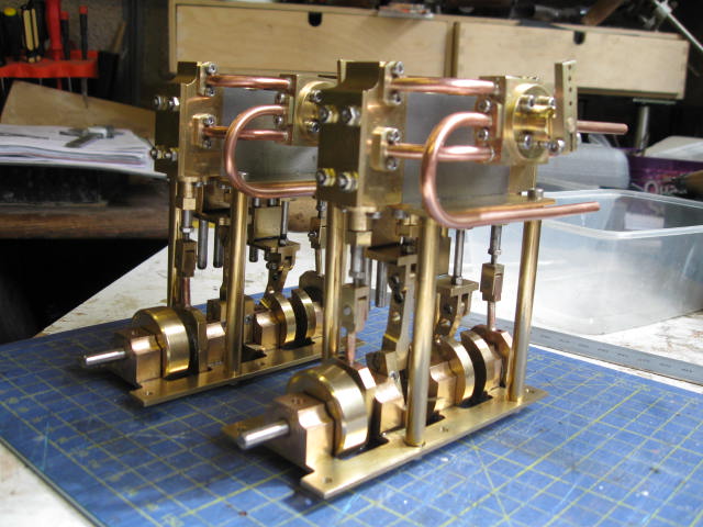

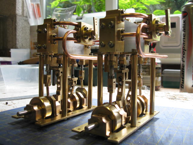

« Reply #30 on: April 29, 2010, 07:39:29 AM »
And then there were two.  :thumbup:
(only loose assembled at the moment)
« Reply #31 on: April 29, 2010, 07:46:06 AM »
A really nice pair of twins!
Taking shape nicely now Ian....  :thumbup:
« Reply #32 on: April 29, 2010, 09:42:54 AM »
Looking real good there Ian.  :thumbup:

Managed to finish the steam chests, then went on to make the steam spindle couplings, the steam chest blanks and the eccentric webs.

« Reply #36 on: June 09, 2010, 04:48:54 PM »
Update!
I set out to make the steam valve spools and had problems. The first one came out ok, but no2 somehow came out off centre >>:-(, as did no 3, no4, no5 and no 6. >>:-(
So, I left them for a while and tried again, this time with success, all 4 are ok, I think!
So, next job was to drill and tap the base of the steam chests to take the spool gland, first chest drilled ok, then first tap (m2) snapped in the hole grrrrr  >>:-( >>:-( there is no way that is coming out, or so I thought. Then I found out that taps can be dissolved without harm to brass using a solution of aluminium potassium sulphate (alum), now awaiting delivery of the magic powder, I will update on results later.
I then thought I would do a simple job, so made the flanges for connection to the steam chests.
Having succeeded with those, I thought I would tackle the steam control valves next, that went well, although time consuming getting them right.

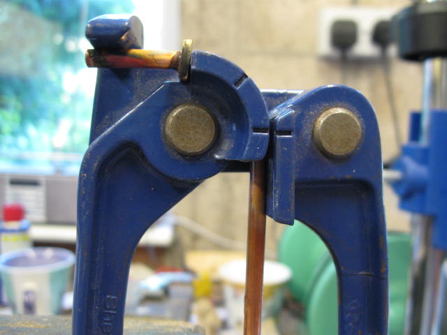

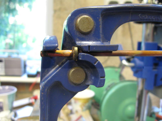

Today I thought I would have a go at some steam pipe and silver solder.
Not having done much ss before, I decided to do some practise items first. The first pic shows a flange blank ss’d to a short length of copper pipe and cut in half. As I wanted to be sure to get full penetration (ooeeerrr), I cut the item in half to have a look.
Success, it appears to have gone all the way through!
I then cut 2 more blanks and had a go at soldering from the pipe end,  pic 2 shows the result, not so good, think again.
 I then turned a flange with a spigot for the pipe to sit in with the idea of putting a ring of ss in the bottom of the spigot, apply heat and let it do its job, but, the pcd of the bolt holes is too small to let me do this with the design requirement of 4mm pipe, so, think again!
I then soldered blank flanges onto a length of pipe from the open end of the flange, filed back to near flat and finished on a flat plate – success, pics 3 and 4 show the results, with some added bling!
Next I needed to work out a way of getting 4 bits of pipe the same. Pic 5 shows a flange positioned 20mm or so from the end of the pipe., with flux and ready to solder.
Pic 6 sees that pipe in the tube bender, using the flange to locate for length, and pic 7 shows the pipe after bending.
Pics 7 and 8 show the finished and polished pipes. These will need to be cut to length to fit into the control block at a later stage.
Overall, I am happy with the results, they aren’t as good as some I have seen, but they’ll do!

Here we have both engines completed, assembled, run in on air but awaiting strip/clean before steam run.
« Reply #48 on: July 16, 2010, 12:13:56 PM »
Very well done. Now you need to build two boilers and two boats to put them in.  :D
« Reply #49 on: July 16, 2010, 05:35:11 PM »
Ian
Great job on those engines Ian. They will certainly enhance any boat that you decide to put them in. I am sure a great many of us will be watching for updates on the engines and the boilers.  :ddb: :ddb:
