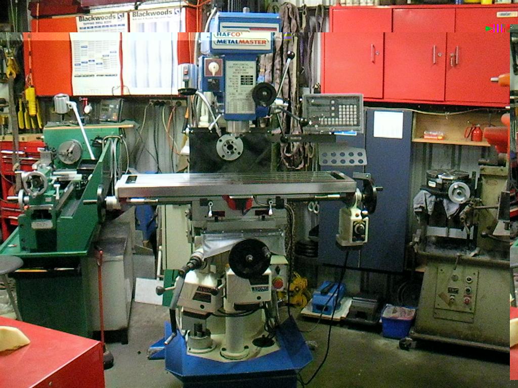

Hi Rob, this is my mill. I have fitted a DRO to it with the X axis DRO scale to the front and the extra Y and Z power feeds. I have another DRO off my old mill that is ready to go on the quill and ram, all I need is some time.
I know how you guys loves pictures so I thought I'd thow some in.

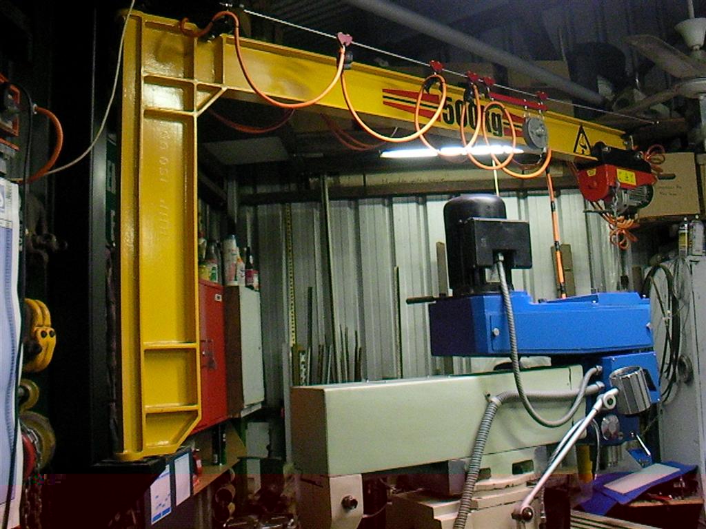

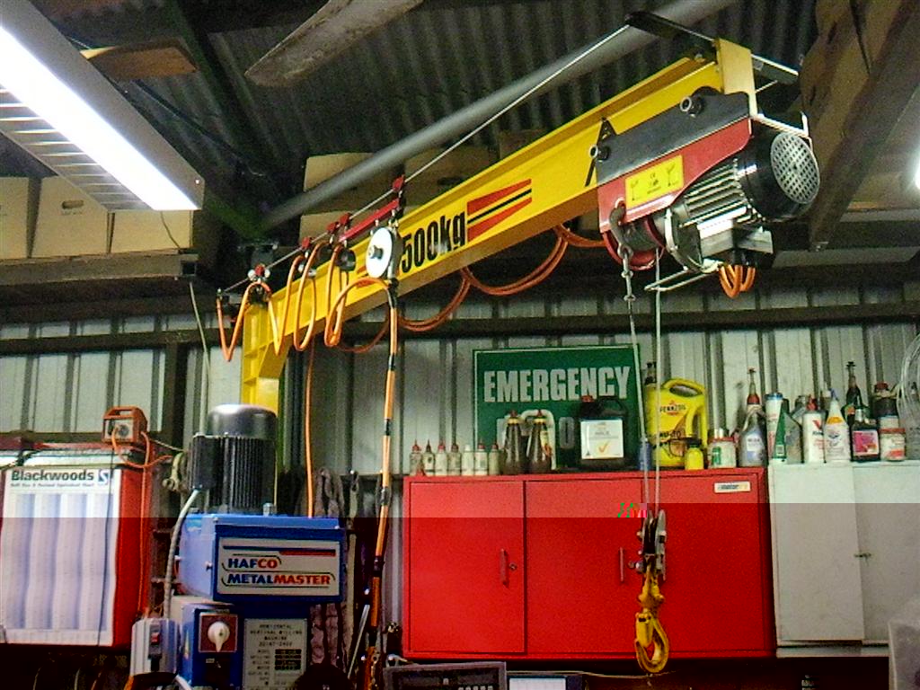

The next 2 pictures is of my latest project from over christmas a homemade 500kg jib crane with an 500kg electric winch.

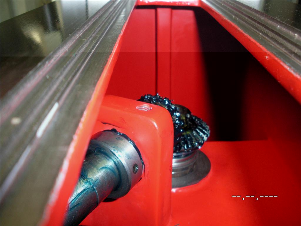

And the last picture shows the cleanup I did of the inside of the inside knee. I have cleaned up most of the insides of casting on the whole mill as they were really rough. The out side will come a bit latter as it took me the best part of 3 months  :doh: to do what I did, but thats the hardest part out of the way. I went that far cleaning it up because I am going to CNC it and want a clean base to start with.

Hi Davo
Thats a very nice setup you have there , :thumbup:  , your mill looks like it will make a great CNC ,very solid looking , There was allot of crap on the inside of my mill castings ,lots of sand, I now have crane envy , yours beats my steel beem and pull lift  :clap: :clap: :clap: :clap:, Great job
