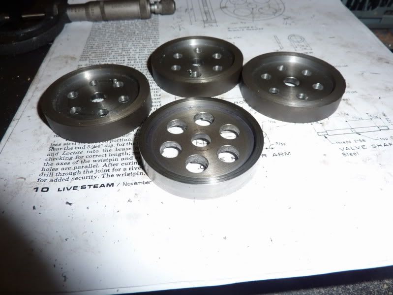

I’ve finally got my self back into the garage for a couple of hours and made a little progress. Things seem to keep getting in the way of this project.
I started by facing all the flywheel blanks to about 10 thou over thickness to leave a little to skim at the end.
Seeing as though I have a few of each part to do I am trying to do a sort of mini production line on this job, completing operations rather than the part. So I left the lathe saddle where it was and faced across each blank. They came out within a few thou of each other so I scribbled the sizes on so I knew how much to take off on the next operations.
I then centre drilled one of the blanks and drilled out to 5/16” hole ready to turn the recess. I thought I’d be able to do this with my standard carbide tool that I now seem to be able to use for most jobs! After struggling on for about 10 mins I got a 20 thou deep recess that my 1 year old son could have chewed out better with his few teeth! The tool just didn’t have the right clearances, I don’t know why I thought I’d get away with it, it was just rubbing far too much everywhere.
So I decided to take a step back and think about it for a few seconds, then grind an HSS tool just for the job. This sketch shows the angles I ground it to:
This now worked an absolute tread, was very pleased with myself! Don’t know why but it was satisfying to watch it cut, I could cut 30 thou at a time with no chatter or anything. So I quickly turned the recesses on a couple of the flywheels, then got a bit tired and bored and came in. It took little time to do though so not worried about that now.
Here is a pic showing 2 flywheels, 1 has a larger recess in 1 side to clear the cam and roller.
It is only now that I realise how light these flywheels are and probably one of the reasons poppin runs so fast. There are 4 9/16” lightening holes called for on the drawings but I’m going to go for 6 smaller holes as I can use the 3 jaws of the chuck to divide those. I will probably turn up a mandrel to mount on in the milling machine and drill in the same way I did the cylinder holes. Should be really quick to spot them all with centre drill then open up that way.
I won’t be getting much more done on this in the coming days – family do tomorrow,  might get a bit done sun night but then away with work until thurs night when I should hopefully pick it back up.
Might go for the crankshafts for a change after these flywheels are sorted.
Nick

« Reply #36 on: March 03, 2010, 07:10:17 PM »
Hi guys,
The lathe is a fair size and more rigid than most Dean, it's a Harrison L5 9 x 24" but the capacity doesn't tell the full story, it's bigger than it sounds! It's been a good purchase, I wish my milling machine was of the same ilk but you win some you lose some!
Well I've had a couple of short sessions in the workshop since my last post. For some reason I just can't get motivated / finding it hard to find the time, then when I do I'm in by 22:00 where as before sometimes I was in the shop until 2am - that's probably not good I know, but still got more done that way!
Anyway, onto the build:
The first job was to get all of the flywheels to the same stage with the recesses turned out, remembering to do 2 flywheels with the larger dia. recess on one side to clear the cam disc.
I then blued the flywheels and marked them up for the lightening holes by using the jaws of the 3 jaw chuck to index the 6 holes.
The idea then was to set about making an arbor to hold the flywheel on – this way I could set the milling machine to the right place then simply fasten each flywheel to the arbor in turn and index around lining up by eye with the markings, tighten nut, then drill. There would still be a bit of manual adjustment but only 1 adjustment for each hole.
Threading arbour in lathe with tailstock die holder:
Here is the arbour:
So I plonked it in the milling vice, centred the quill and wound it out to the rad that the lightening holes lie on and started drilling:
I soon realized that this method was still taking a while – I had to drill 24 holes, 6 on each of 4 flywheels but opened up gradually too. As soon as I started opening the holes up it became less easy to find the centre of the hole by eye.
Luckily, I had a brainwave – I say luckily because by chance I had made the arbor from hexaganol bar – my indexing method was sat there looking me right in the face and I couldn’t see it!
So with a vice depth stop in place (thanks Tim!), all I had to do was clamp the flywheel onto the arbor, slacken the vice and index around onto the 6 flats of the hex bar! This made if very quick to do.
Here are the flywheel s at similar stages:
Once I got to the larger size I was having massive problems with getting the drill to cut – It did a little then just refused, with or without cutting oil, tried regrinding etc but it was making a right mess chewing through the steel on the first flywheel  I did. So I used a slot drill instead, this worked much better, quicker and cleaner.
Once all the holes were drilled I put the arbor back in the lathe and turned a parallel register on the other end. Turned it around and turned a new location diameter for the flywheels  (see last pic) I then left the arbor in the chuck and clamped each flywheel on in turn to true up the OD. This should make them run true.
Here are the two pairs of flywheels, I’ve left the centres as they came from the lathe so I can paint.
Offline Dean W
  • Posts: 571
  • My kingdom for a lathe!
    • Projects web pages
Re: 'Poppin' Flame Licker
« Reply #37 on: March 04, 2010, 01:33:47 AM »
It's going well, Nick.
I can't remember which forum I'm watching you on, from one day to the next.  Some here, some the other place.
Anyway, still watching your build!
