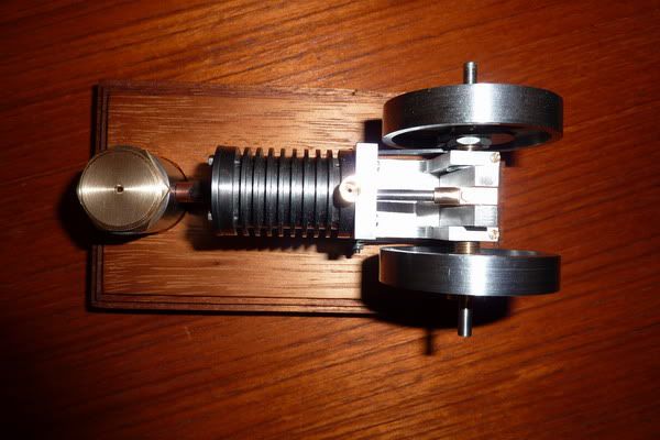

Looking quite good now I think, should look good when on its base. The question is, do I stick to my red flywheel scheme?! I deliberately left the centres of the flywheels rough so I could paint them.
Flicked it over a few times to get a feel for any tight spots, & whether everything seemed to work. It sounds promising, I can hear some suction and in fact it sounds just like Rick's from HMEM! Time to call it a night now, can't wait until tomorrow ...................
http://www.youtube.com/watch?v=4gkViVZm4WQ
Yeah right!!!  :lol: ... I've had you going long enough - I admit, I couldn't resist trying it to see if it would run!
Here are a few attempts. I missed the first one, I put the camera on but then didn't have enough hands so it just ended up pointing at the wall! I should have made the fixture for putting it on the mag base as Bogs suggested - will still do that soon.
I should point out that these are warts and all videos and unfortunately I've realised I waffle just as much in real life as I do in these posts. I seem to be mumbling quite a bit and probably not even making sense so apologies for that but anyway, you'll get the picture!
http://www.youtube.com/watch?v=pkMiXoXjBYI
http://www.youtube.com/watch?v=QlhpRWZ5OyM
http://www.youtube.com/watch?v=q4TQvSpKZMA
 :D :) :ddb: :ddb: :ddb:

Nick,
I bet you woke up still with a big grin on your face (if you managed to sleep that is).
That is a great result and proof that your machining techniques and problem solving are improving all the time.
Now just settle down, no rushing, do your little fiddles and tweaks without any bodging, and you will be able to enjoy your hard work for a long time to come.
Fantastic work

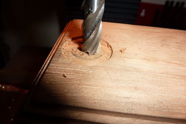

Marked up for engine mounting holes and drilled:
http://img.photobucket.com/albums/v287/NickG24/Poppin/2011-01-2216-12-06_0012-1.jpg'Poppin' Flame Licker
The beauty of this is, you don't need to clamp, just position by eye and because the cutting force is low and the bit of wood relatively large you can just hang onto it and quickly drill through.
Turned over to counterbore the holes as the 6ba screws aren't long enough to go right through.
http://img.photobucket.com/albums/v287/NickG24/Poppin/2011-01-2216-19-33_0013-1.jpg'Poppin' Flame Licker

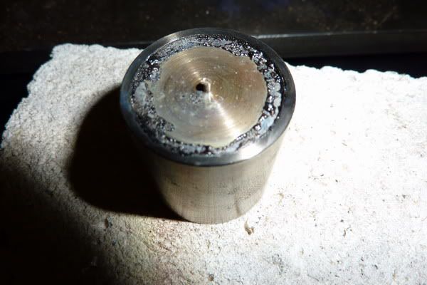

Ready to solder in, I would just soft solder this as it shouldn't get hot enough to melt and doesn't need any massive strength, just be leak proof. I use this soft solder paste as flux that I found in my grandad's garage for soft soldering. Seems to work well, only thing is, it gets solder wherever you put the paste. Doesn't need to be too neat this though as underneath:
http://img.photobucket.com/albums/v287/NickG24/Poppin/2011-01-2217-23-23_0015-1.jpg'Poppin' Flame Licker
Heated up and a bid more soft solder fed in:
http://img.photobucket.com/albums/v287/NickG24/Poppin/2011-01-2217-25-29_0016-1.jpg'Poppin' Flame Licker
This didn't work. It's stuck to the brass but hasn't taken to the tube whatsoever. So all this had to be cleaned off.  :scratch:  :bang:

I had decided I would silver solder the base and wick tube in now - but that didn't work either. It just wouldn't take to the steel for some reason. I was sure I'd silver soldered stainless before, or at least seen it done?  :doh:
So even more of a mess had to be cleaned off now. I was mulling over what to do and decided that being as I had a good fit on the parts, I would loctite them together. Don't know whether it will work long term or not, I was going to use some epoxy glue like araldite but I didn't have any and didn't want to wait for ages for it to dry.

I have no boring head so I used the flycutter to outline the recess / sort of trepan to depth:
http://img.photobucket.com/albums/v287/NickG24/Poppin/2011-01-2221-45-50_0032-1.jpg'Poppin' Flame Licker
Then used an end mill to carve out the middle to the same depth. This was tricky, kept forgetting which way my hands were turning if that makes sense!  :lol:
http://img.photobucket.com/albums/v287/NickG24/Poppin/2011-01-2221-51-55_0033.jpg'Poppin' Flame Licker
I should have used the biggest end mill I had but never thought at the time.

Here is the finished engine no.1. I should have mentioned, since this is my dad's present, I decided to just put some emery cloth and oil on the flywheels to stop them going rusty rather than paint them:
http://img.photobucket.com/albums/v287/NickG24/Poppin/2011-01-2222-18-59_0035.jpg'Poppin' Flame Licker
http://img.photobucket.com/albums/v287/NickG24/Poppin/2011-01-2222-19-08_0036.jpg'Poppin' Flame Licker
http://img.photobucket.com/albums/v287/NickG24/Poppin/2011-01-2222-19-19_0037.jpg'Poppin' Flame Licker
http://img.photobucket.com/albums/v287/NickG24/Poppin/2011-01-2222-19-30_0038.jpg'Poppin' Flame Licker

p.s. Just noticed that in those photos at the end, it looks like the engine overhangs the wooden base. It doesn't it's been carefully measured to ensure there is a nice border all around it. I've got OCD when it comes to things like that!  :lol:
Also, the pic of the stainless tube, must have been sawing it off before I'd faced the end, think I was sick of showing pics of facing off!

Great run Nick  :thumbup:
:clap: :clap: :clap: :clap: :clap: :clap:
 :nrocks: :ddb: :nrocks: :ddb: :nrocks:
Nice job with the brown stuff as well, I can't touch the darn stuff I've developed an allergy to it and just swell up.
