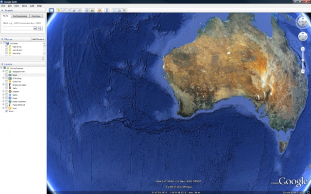

31°57'S 115°51'E  (Perth - Western Australia) That's the big island that counter balances the world so it doesn't topple over and through us all off.  :smart:
