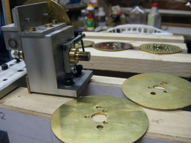

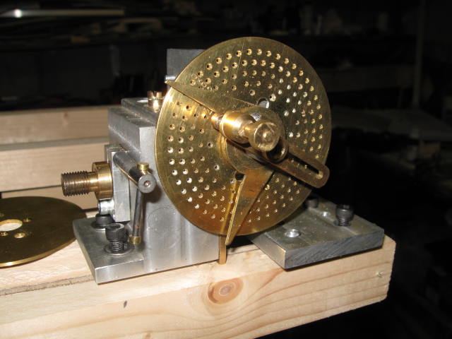

A few years ago, I decided I wanted to try and cut some gears, for an idea I had, so, I needed a dividing head!
I already had a peatol lathe, and found plans for a div head by Tony Jeffrie.
At the time I had access to a mill at work, but since then the 'elf & safety police have locked down all the machine tools, so now I am buying one for myself.
So, off I set and ended up with what you see below, along with some gears I cut with 0.5 mod cutters.
Sorry, there are no interim pics to show.
Ian

Hi Ian

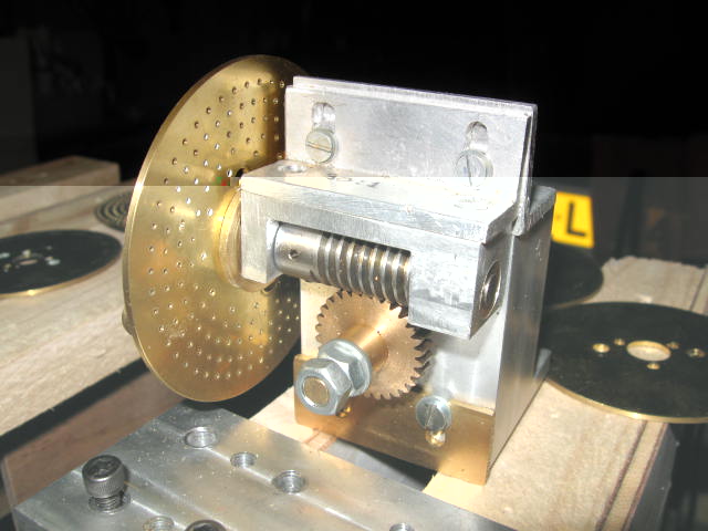

Thats a nice bit of tool making :thumbup: did you cut the worm yourself ?.

No, I didnt cut the worm drive - wouldnt know where to start with that!

Nice work, though I don't envy you drilling all those holes Ian  :scratch:

Drilling those holes was  a real P I T A, and, marking out the protractor wasn't much better.

I've had dividing head on my todo-list for a long time, but that wormy thing has kept me away from it, as I'm not sure if I can make it properly. But someday..

It is that wormy thing that is one of the easiest gear sets to make.
At a push you can get a length of trapezoid thread in the diameter you want, use one piece for the drive and another piece to make a cutter.
It is very well documented on the web.
