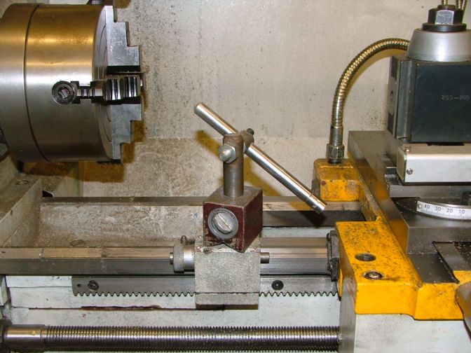

I do not understand the advantage of the single point dresser over the block-on-the-handle type I already have?
John,
What you have to realise that what you are making isn't something you are going to be grinding paving slabs with, it is going to become the equivalent of a precision tool, in fact more so, because sometime you will be using it to put cuts on of less than 1/10th of your normal measuring range.
The single point wheel dresser is the only way you will be able to dress the wheel fine and true enough.
Say you had a bit of Kiwi meat stuck in your teeth, would you use a pickaxe or a toothpick to remove it?

Now about this stone dresser, I assume the tool has to be fixed to some sort of stand on the lathe and the stone moved across it?  Surely hand holding would not get the accuracy.

I mounted mine on an old mag base that can be stuck onto a rigid part of the lathe, then the wheel is fed against the diamond tip using the axis control you will be using for the grinding, or 90 degrees to it if you are going straight in. That dresses the stone so that it is prefectly in line with what you are going to be grinding.
If I get a chance later, I will take a piccy of my grotty old setup that works perfectly.

Thanks John, I have a couple of clamps and I might be able to adapt one for the purpose, no spare mag bases though!

As promised John, here is a shot of my bodged up wheel dresser that works a treat.

Thanks John, I should be able to manage something like that!
