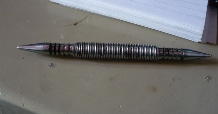

Malc, the scrappie called round today and brought a tool to show me that he's picked up.
It consists of two hardened punches and a tension spring, what you can't see is that one punch is longer that the other inside the spring and they are touching at the internal ends.
It's an automatic centre punch, you put one end on the mark and pull the other end to expand the spring and let go.
Depending on which end you pull determines the weight of the pop mark due to the differing weights.
So simple and fool proof after these normal sort we are used to that never bloody work or if they do the pop mark is so minute it's a joke.

John, my guess is that one end also slides inside the other so it doesn't bend on the spring?
Nice idea .....  :thumbup:
So it's not just me then that can't seem to get those auto punches to work properly ....  :scratch:

General Tool has been selling them, over here for years. and another of the cheapy tool makers/ sellers had them for sale as snap punches. I have had one for years.
And I have the same problem with the 3 auto center punches I have. They never seem to work more than 3 or 4 times then miss.
They are also sold as wood nail starters, and sets

Bought mine off Ebay a couple of years ago.
I find it`s much easier to use than position the punch &, "where`s the hammer gone?"  :bang:
Used it to mark all the bolt holes on my carport roof...... Then 1/4" of the large end broke off, in fair service..... It was as hard as glass!  :bugeye:
Sharpened again..... It`s still in use!  :thumbup:

i've had one for about 20 years, never had regrind it!!
main benefit of this design is that it doesn't get used for anything else!!
