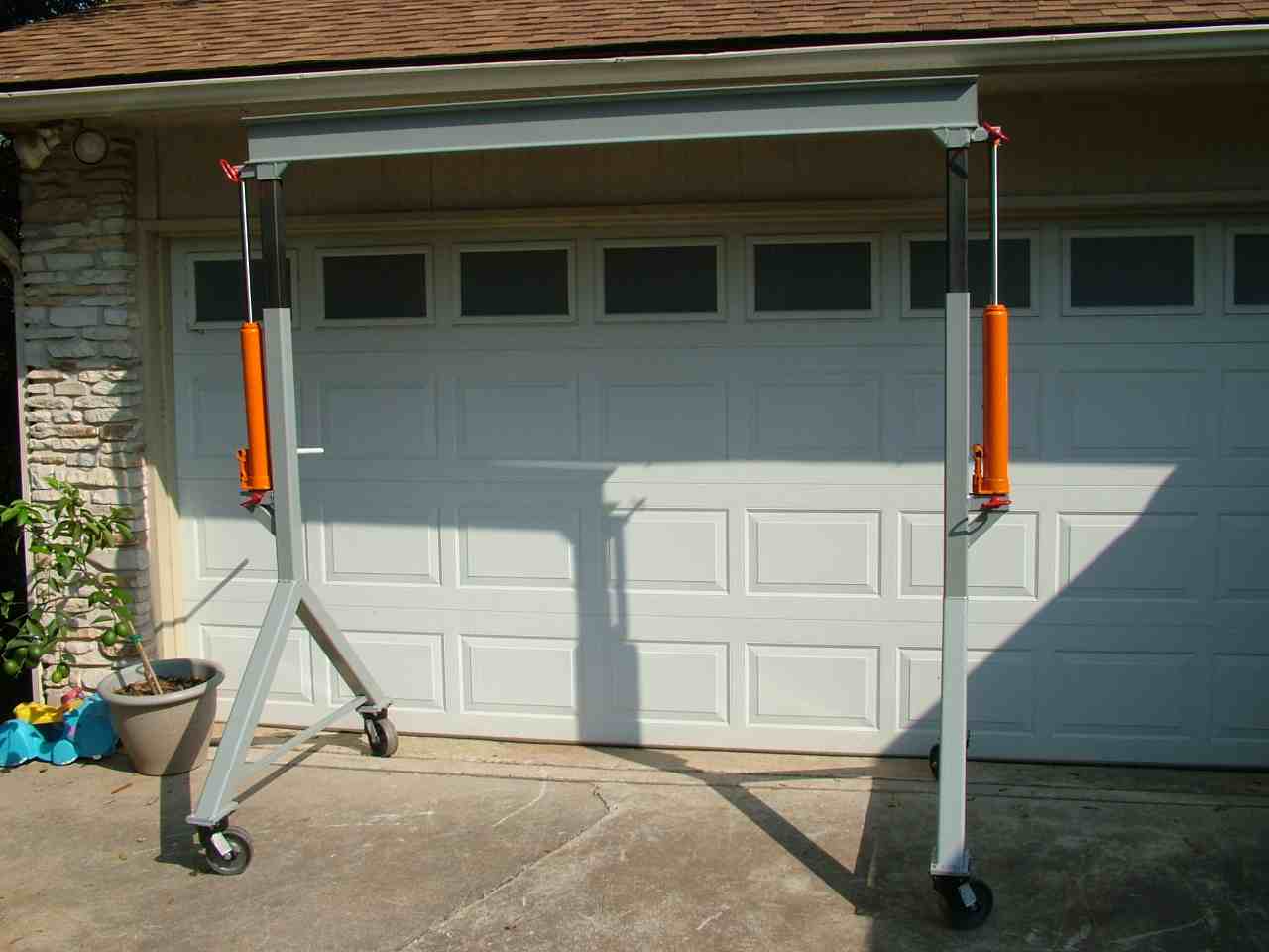

Here is the design I am working to.  My legs are different, but the rest will look pretty much like this.
The guy even supplied a cut list for the steel.
From an early age my father taught me to wear welding gloves . "Its not to protect your hands son, its to put out the fire when u set yourself alight".
Forget about the price of gold and oil, its the price of beer that matters.

Here it is.  My legs are different, but the rest will be pretty much the same.

Yep, that's the one....... :clap:
Looks a handy piece of kit...... :ddb:

« Reply #11 on: August 30, 2009, 10:11:42 PM »
I fear I am missing something here..... :scratch:
You put this astride something heavy (like the crate with your new mill in it) then extend the jacks to lift the crate so you can wheel the whole thing into the garage?
I fear that if I tried that I would get it rolling and two of the wheels would hit something and the whole thing would collapse,  just how strong are those top corners?
« Last Edit: August 30, 2009, 10:22:44 PM by John Hill »
bogstandard
Re: Gantry build
« Reply #12 on: August 30, 2009, 11:19:49 PM »
My thoughts entirely John, plus the offset wheels don't help.
It is only the strength of the box section that is stopping it doing the 'splits' or collapsing over one way or another.
I for one wouldn't even consider it, a totally bad basic engineering design, no matter how many people, or how much weight anyone else has got away with.
Bogs
« Last Edit: August 30, 2009, 11:21:28 PM by bogstandard »
Offline Darren
  • Posts: 3795
  • N/Wales
Re: Gantry build
« Reply #13 on: August 31, 2009, 06:40:25 AM »
I think it's just for lifting and lowering, not moving....lift out of a trailer, move trailer, lower onto a pallet truck or sumsuch.. :ddb:
Just one of many lifting facilities.

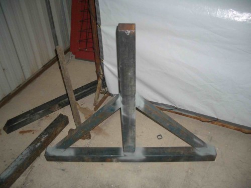

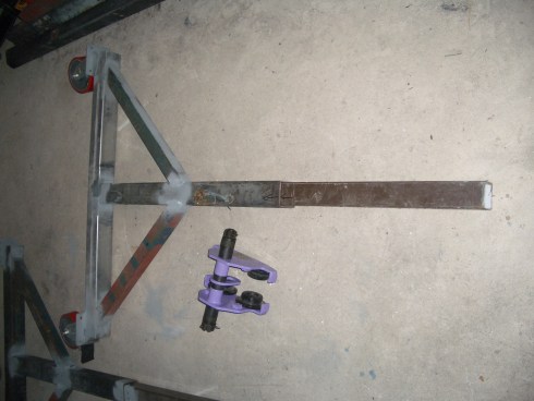

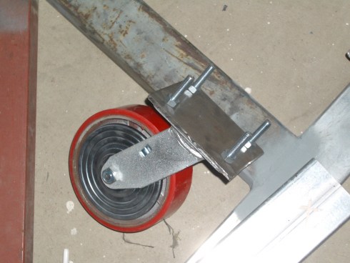

Sourced myself some HT bolts for the casters.  3 of the four casters have locks.  What can I say I got a really good deal on them, especially considering the locking ones are normally dearer.
Made my legs longer to allow more support for the telescoping SHS running thru the centre.

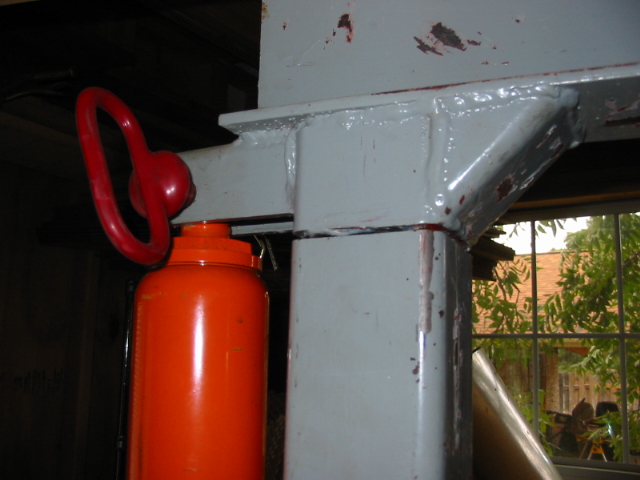

Currently doing some mock ups to work out how I'm gunna support the rams.  I need to be able to see something in the metal to work out how I will actually do the job.  No not using the thin stuff that's shown in the pics.  Somehow dont think welding ally to Mild steel will work for starters.
Pics show my current ideas for the top and bottom mounts.  The large piece of flat on the top mounting represents the I beam.  Another foto shows the telescoping SHS.
Add a gusset to the bottom mount and some 10 mm flat to connect the clevis pin to the ram.

Hi Jatt, as Darren pointed out , the wheels are the weak spot in most gantrys of this design...I would go for an all steel wheel with roller bearings built in...not that much more in price really...I have witnessed the results of using the cheaper plastic or nylon based wheels and believe me you do not want to go there.

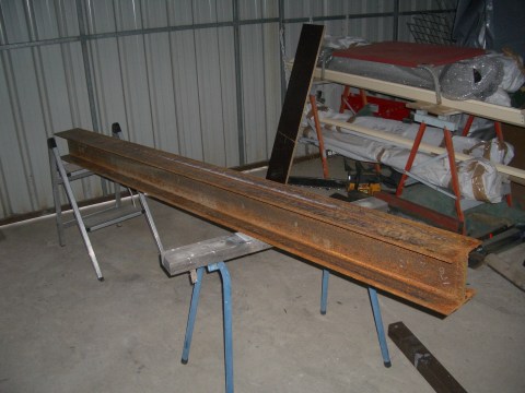

Here is where I am up to with it.
Used 16 mm HT bolts to attach the I beam to the top.
