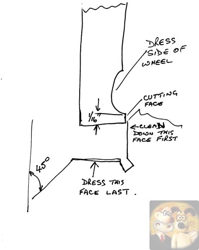

« Reply #2 on: August 20, 2009, 04:21:34 AM »
Bernd,
Because you are only removing a very small amount of material from under the casting face, there is no need to go buying an expensive side and face cutter.
You can use what you already have, a flycutter. You will need to grind the faces to cut in the opposite direction. See attached C-o-C.
The most important thing when doing the job is to make sure the feet are clean underneath and the top faces of the ways are set up perfectly level to the bed, a DTI in your chuck and sweep the whole length of the casting. Shim up under the feet if you have to, to get it perfectly level. If it is a good topgrind and no shims are needed, then just a good table cleandown between swapping the casting around will be fine, otherwise, if shims are used, then for the second sweep after moving the casting, you will have to use a mag base on the head to get it level, as you cannot move the cutter.
Once you have the cutter set to depth, the table and quill is locked up rigid in the Z axis, and the casting manouvered around the cutter for doing both sides.
Bogs

Re: Modifying a Grizzly 9 X 19 (G4000)
« Reply #3 on: August 20, 2009, 10:18:30 AM »
Bogs,
Thanks for that. I never would have thought of using a fly cutter upside down. Ingenious. Thanks much again, you saved me about $50 USD for the cutter and who knows how much for an arbor to hold it.
Were do I send the donations to?  :lol:
First I need to find that thread you did and reread it on how I go about this.
Pics and detailed info will be posted Gerhard.

It is a shame you don't live a little closer, as I have a large 90 deg milling cutter that would have done that easily. You could use a 90 deg countersink but I don't think it would leave a good surface finish.
Or mount the whole job at 45 degs and use a standard end mill.
The way to get a superb finish is to use your surface grinder. Mount the part up at 45 degs, gently scoop a bit out of your wheel sidewall to a width just slightly wider than the depth of the face you will be cutting.
See attached C-o-C
Bogs
