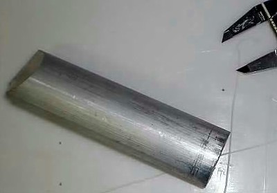

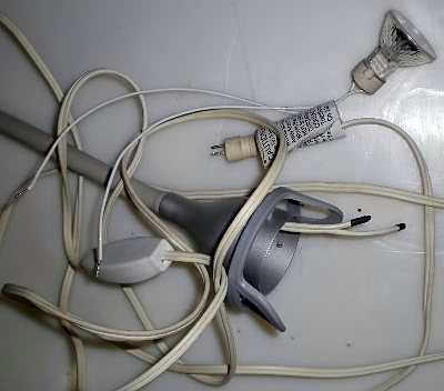

One broken Ikea lamp ($7):
One Ali bar end ($free!):

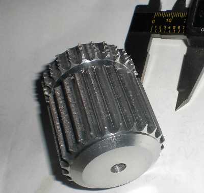

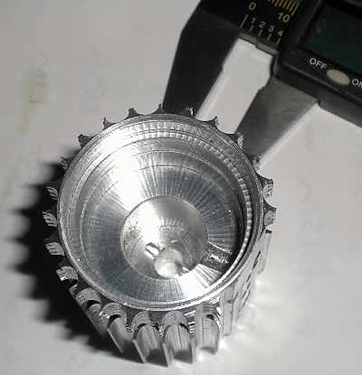

A little turning and boring (boring bar chattered like mad)
Plus some quality time on the mill with a 24-space indexer and 3/16" ball end mill.
Result:

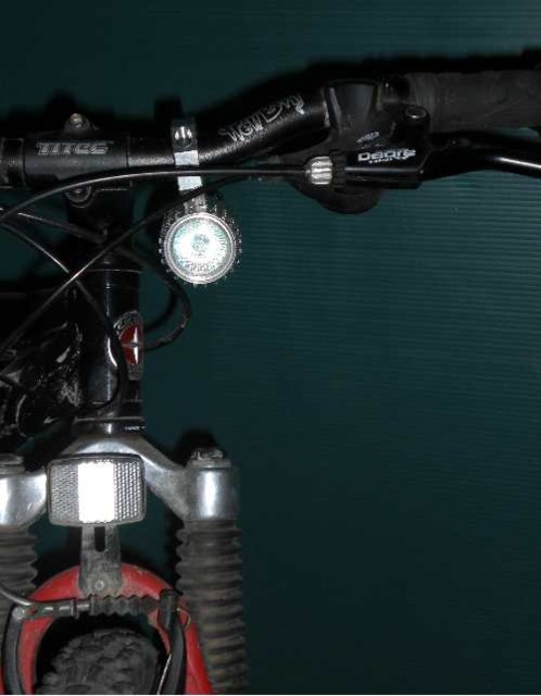

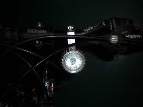

MadMod Bike Light:   :zap:
25 watts of light for an hour using a small 12v SLA battery (I've got loads from an old server UPS).  Works better than the $150 commercial model it's replacing.
The same concept applied to the end of some flexible conduit would make a nice machine light.

« Reply #8 on: August 18, 2009, 09:15:30 PM »
I like that.
A couple would look good as riding lights on a motorcycle  :thumbup:
How are you holding the lamp into the holder?
Silicone sealant-- used for waterproofing and shock absorbing and it's not hard to pick out when the bulb needs replacing.  I thought about a bulb-closer over the front but decided not to bother this time around.
FWIW the MR-16 bulb is reported to be more efficient and can be had in up to 50w sizes-- it's about 2" across vs 1-3/8 (the MR# is the number of eighths of an inch across the bulb is).  I may try turning one into a machine light here in a bit.
