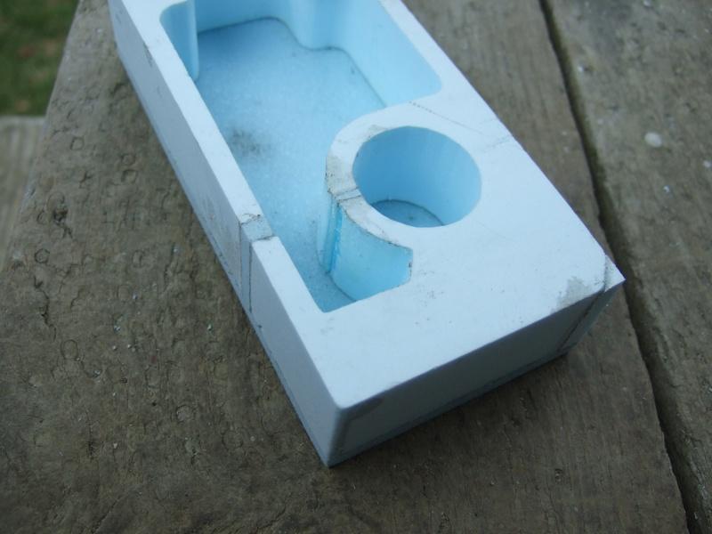

For the present, I'm still working with an average 1" bore size engine, as a test of lost foam methodology. I drew up the shape I wanted in the old free Google SketchUp and then through a long series of graphic transformations got that shape into a cutting file for my old foam wing cutting software, JediCut. This runs on my CNC hot wire foam cutter.
I won't go into all the work I had to do just to get that shape to cut, but it was NOT the most fun part of this project! I could have made 10 wooden patterns by hand in the time I spent eventually getting one CNC foam pattern cut :doh:

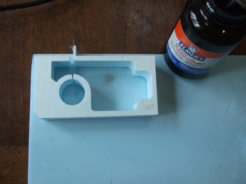

Anyway, here it is, finally....with some flaws. There's a piece of excess at the top, a bad lower left hand corner (defect in the scrap foam piece I was cutting from) and two gaps where the wire had to cut through to get to interior hollows. Those will all be plugged with glued foam bits.

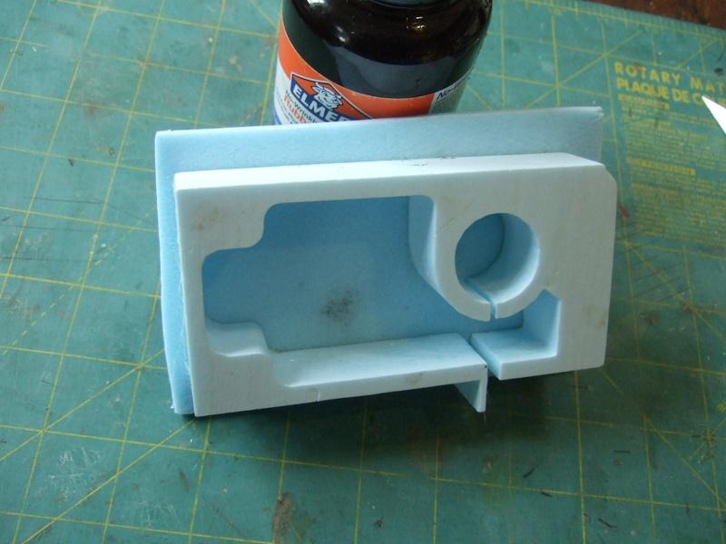

This pattern actually needs a back, so I used a piece of 1/4" fanfold foam for that, and glued it in place with rubber cement.
Then trimmed close to the pattern:

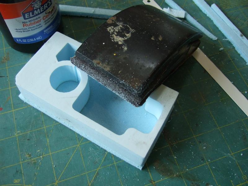

Then sanded. I hate the sanding dust that foam makes, so I try to minimize this by first cutting VERY close to the line with a used hacksaw blade. The same tool I used to make my full sized rowing boat -- and many model airplanes over many years. Rubber cement for foam is also a long used glue for me when assembling foam planes.

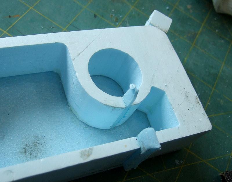

Here I've glued in the foam bits I needed to correct the pattern. I used offcuts of fanfold foam, which has a somewhat different texture and density than the regular Dow foam I made the rest of the pattern from. This may show up in the finished part. Probably will....
Then sanded again...

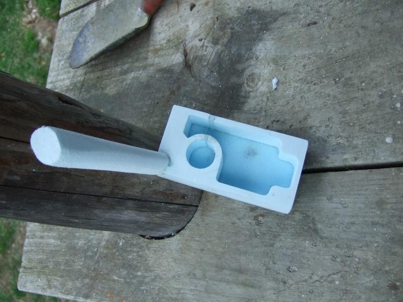

Then I added a sprue that I just shaped by hand out of a piece of foam. Again, more foam dust, only this time I moved outside on the porch to do it. Nevertheless, static electricity tends to stick it to you and everything else nearby. even in a breeze, as there was. The sprue was attached with hot melt glue, since the joint was irregular shape and hot melt is good at filling in small gaps -- unlike rubber cement, which produces a very thin glue line.
