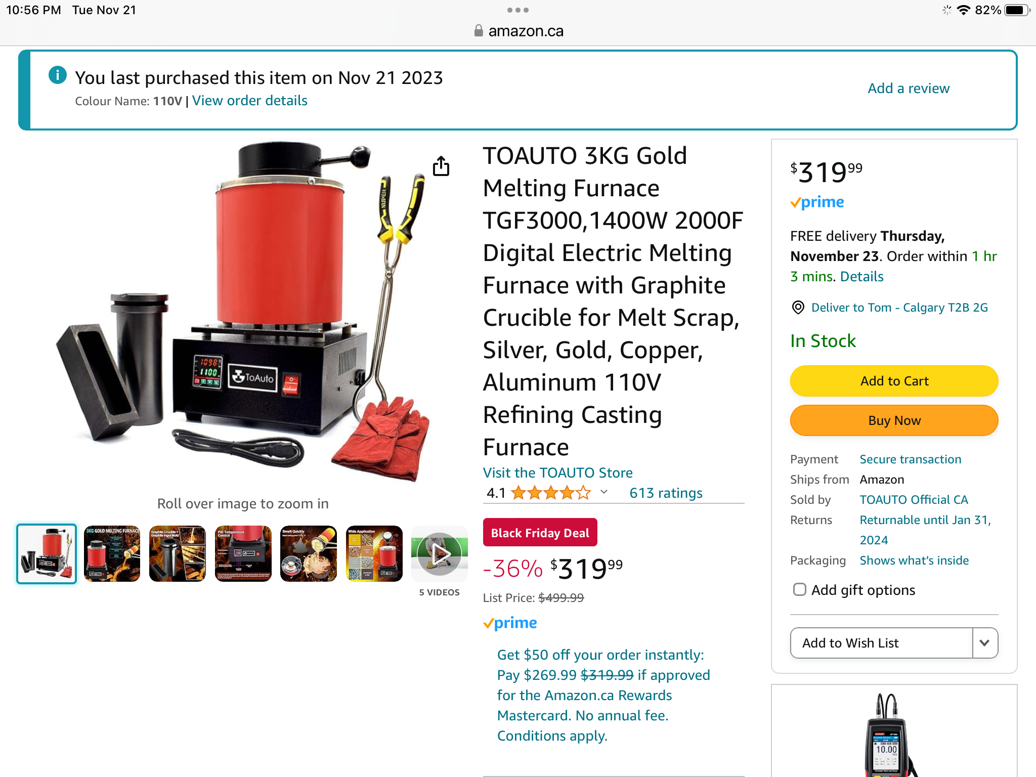

« Reply #16 on: November 28, 2023, 03:05:55 PM »
Well Black Friday got me and I picked up one of the furnaces along with a Resin Printer, Resin and Wash and Cure Station! Wish me luck! lol
