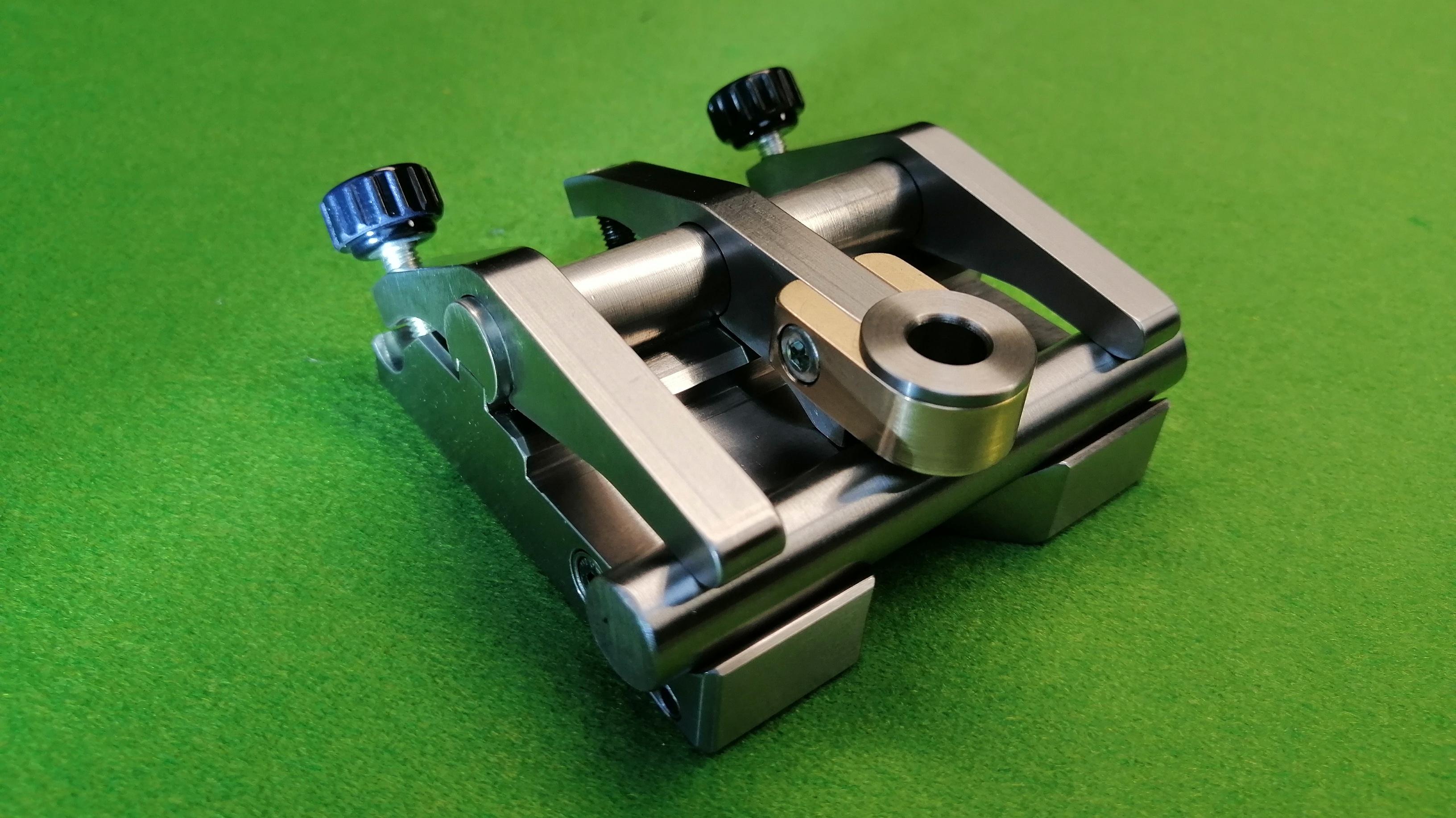

Strap clamps can get a bit high with the raised clamp knobs sometimes well above the workpiece. This system uses pivoting, sliding clamps with the clamp knob below the clamp top allowing easier access for tooling. The main body incorporates a vee + step + pivoting detent end stop for accurate part location.
A  separate movable arm can be locked in any position along the centre of the vee for drilling through the centre of a bar.
The video shows grinding, drilling & milling operations on small parts of different shapes & in various materials.
This principle can be scaled or lengthened to suit smaller, larger or multiple components.
Link to video -
