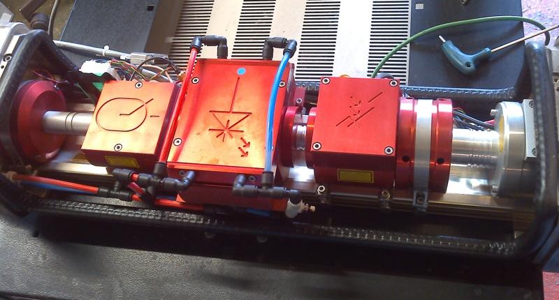

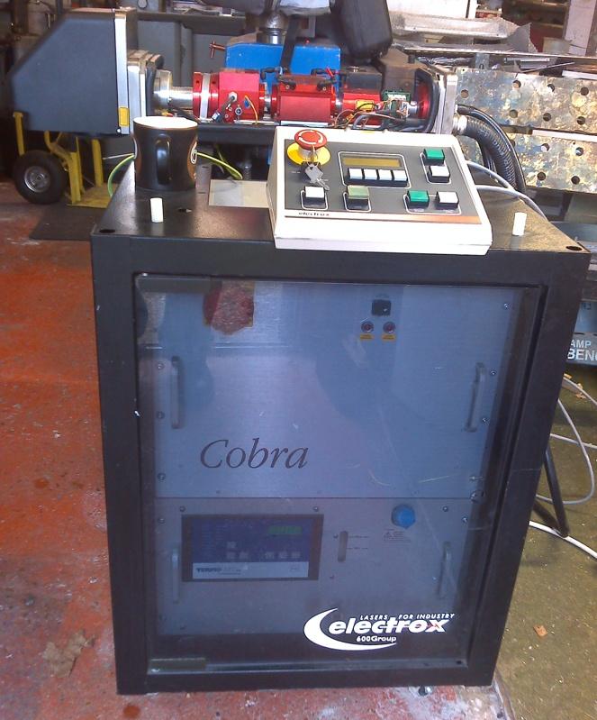

I've just been given a pro laser engraver. Its a bit of a monster (150W  @ 1084nm  2.2kW psu with cooler) and broken so I'll probably break it, but I thought I d ask if anyone has  YAG laser experience.
The machine was scrapped with a 'diode low power' fault. I'm guessing this means the 808nm pumping diode has dimmed.

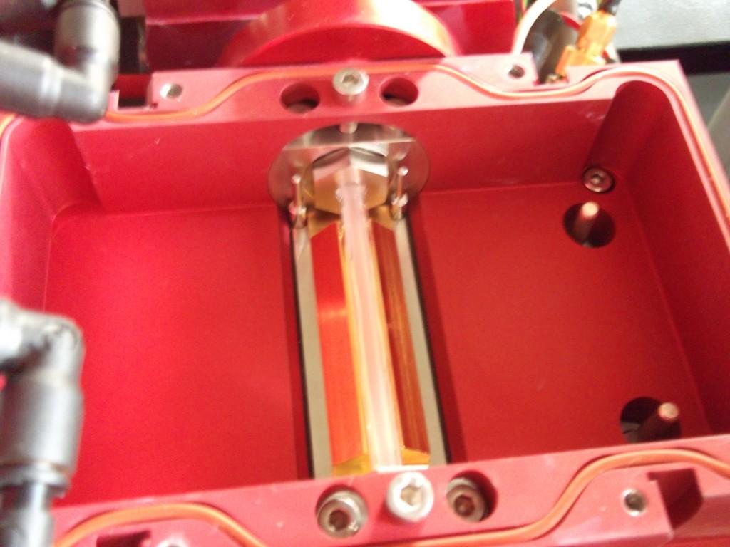

Under the lid ..

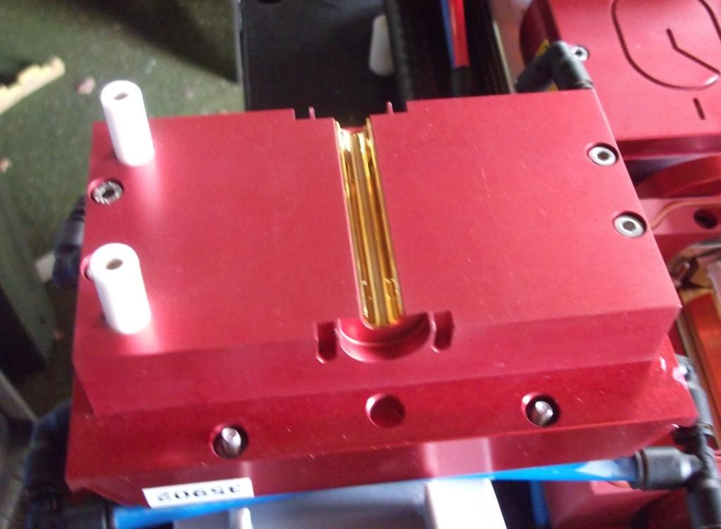

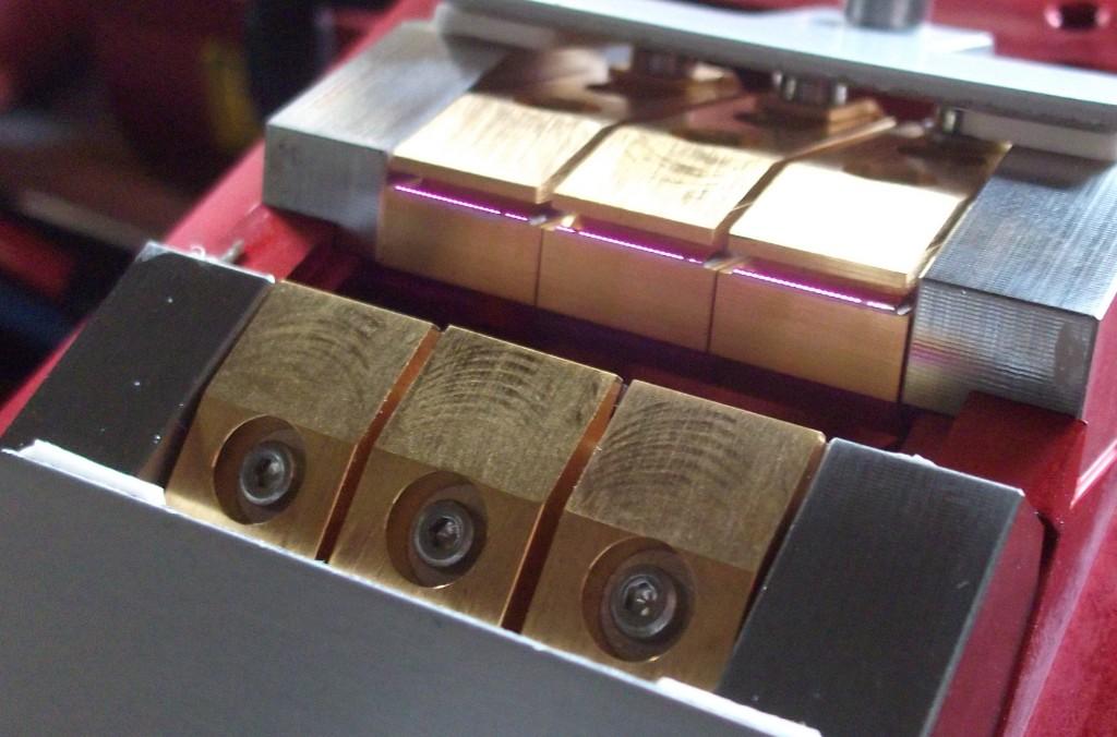

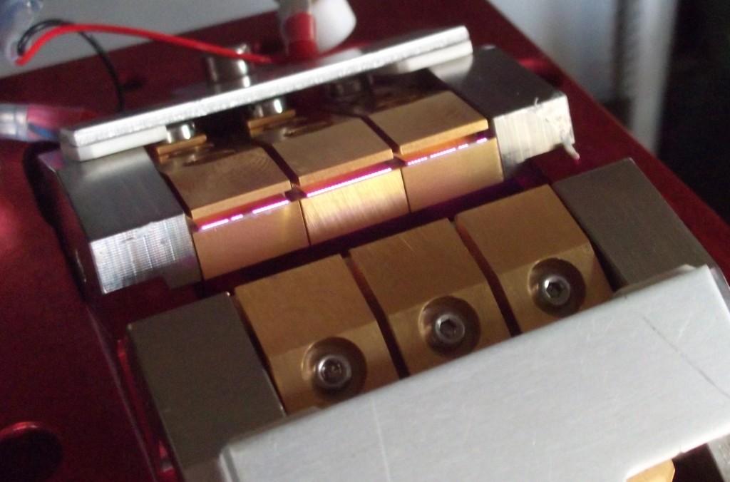

I opened the diode pump box and investigated:
The pump consists of 6  laser diode banks each with 25  chips .  Driving it with a constant current supply I can see a good few chips not working .
The voltage across the array was only 9V or so at 2A - given this is driven by a 50A 45V supply , I can see the need for water cooling.

BTW these diodes shine down on to the YAG (yttrium aluminium garnet) crystal which is encased in a water jacket for cooling. The red laser light pumps up the electrons in the crystal . When the electrons collapse to their rest state (controlled by a Q switch) they release Infrared photons , which burn the crap out of what ever gets in their way.
