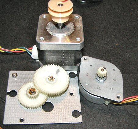

Anyways, I have few bipolar stepper motors, one from old printer and another from HP scanner and also Nema 17 ones, which I used to test as hand-cranked generators.
I think I'll stick with Nema 17, as it's easier to find specs for them.
Specs that are in the motor itself:

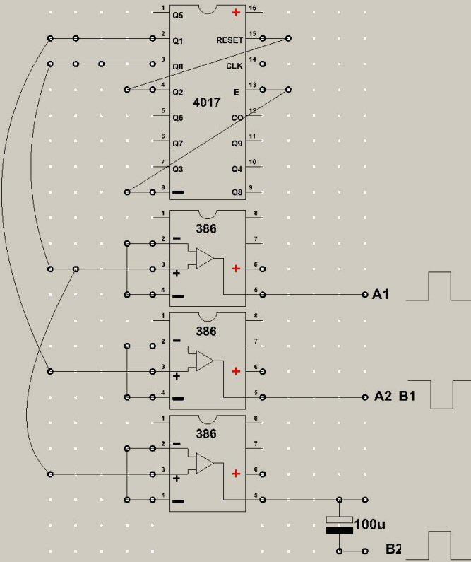

Anyways, that gave me an idea to test a schematic of 4017-386 based circuits to get a working sequence to run the this bipolar stepper - it's been (again) like a guessing game - like building something out of Lego blocks - whatever produces desired result, is a keeper.
It was positive surprise to see, that by using those wimpy audio amps, it is possible to drive this bipolar stepper(Nema 17-04) with 400mA at 5-6 volts without burning out involved components.
So far, this is the simplest circuit after some testing. 4017 uses function generator for supply and signal, and 386 uses bench psu (For clarity, I have omitted supply connections and spike-reducing diodes):

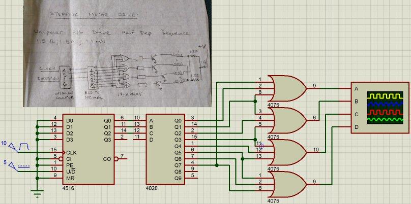

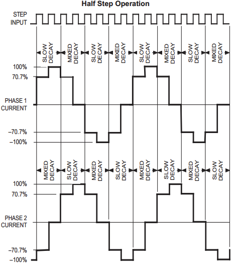

What I'm also trying to find out, if I can make something, that produces a half-step sequence using only discrete, analog components. If I manage to do that, it's fine. If I don't, that's also fine. Be it either way, next step is to see what plan B has to offer.
In 1984 I made some 1/2 step drivers for a plotter I was building. They just used cmos chips to generate the 1/2 step sequence.
The basic circuit:
The power circuit (to use constant current):
(Transistors used BC107 and BD645 Darlingtons)
And the finished board:

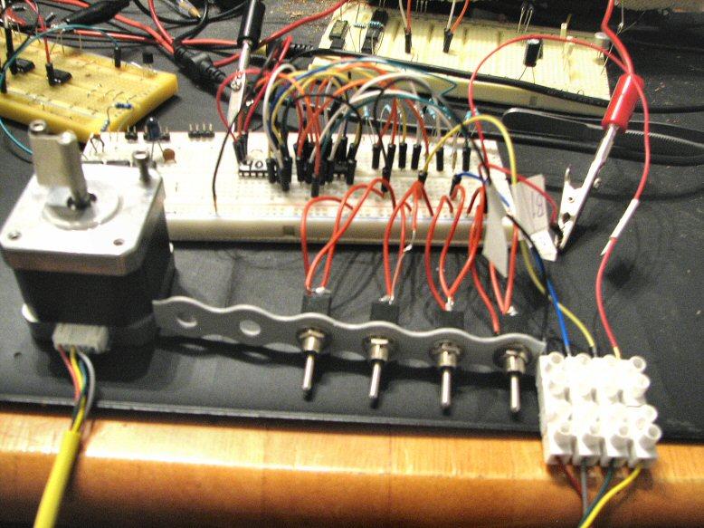

I had to test, how to 'emulate' a correct sequence, to get a 'hands on' -feeling, using four spdt switches.
Finally, I think I got it right, as the stepper rotates in the same direction - step by step, when turning the switches on and off in certain order.
First image(stepper_and_switches_1) is just to show how I connected switches and stepper motor's wires, while the second one is the actual breadboarded circuit(rest of the breadboard wires and stuff isn't involved):

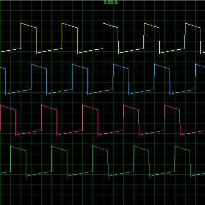

Anyways, I simulated Phil's circuit to see what kind of waveforms it makes:

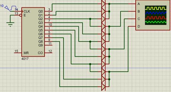

As I don't have 4028's and 4075's, it was time to test how to make similar-ish waveforms, using 4017 and some diodes:
Then comparison, first is Phil's circuit and second one is 4017-based:
 [ You are not allowed to view attachments ]   [ You are not allowed to view attachments ]
It seems to be kind of there, but after all, it's just a simulation.
I'll do breadboarding and see how it goes.

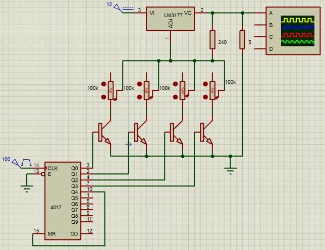

I've been testing how to keep stepped waveform - to preserve its form - when there is a load.
I guess, when there is enough current, that's what gives the voltage(be it in stepped form, or whatever) "power" to maintain its shape under load (Nema 17 stepper coils are about 4 ohms).

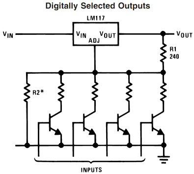

Circuit that I used for testing, is based on LM317's datasheet, which has several examples of how it can be used. One of them is "Digitally Selected Outputs":
That led to using 4017 to make a sequence:
It keeps its waveform under load, after adjusting the pots. I had to put a heatsink to 317, as I was using max 1300mA. So far so good, but then I realized, that the waveform appears only as a positive voltage. I was like: "how to get the dark negative side involved?"

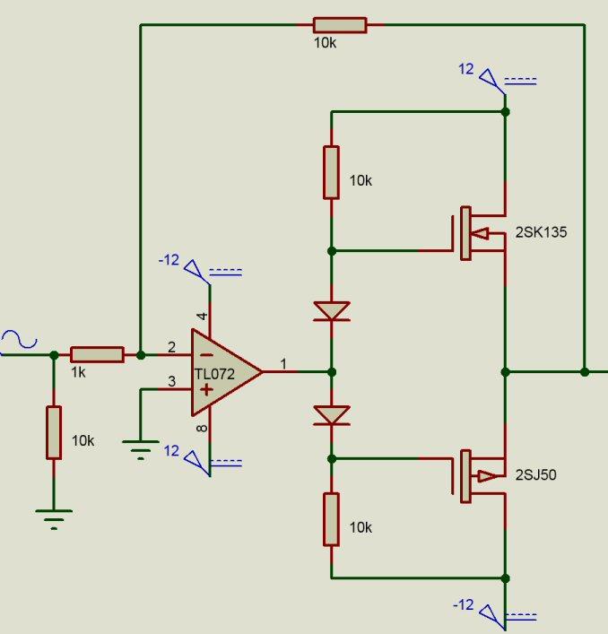

Next thing that came to mind was, "how about little more grunt, if some future project requires it".
Besides, I'd like to use something else to run the stepper, than function generator.
So I'm trying to figure out, how to amplify a sine wave against 4 ohms load.
What comes to that 90 degrees phase shift, I already have an idea, of what to try - one or two stages of an op-amp based phase shifter, which was originally controlled with ldr-led based optoisolators, and was intended for musical use.
Earlier I breadboarded that phase shifter(four stages, everything else stripped, most basic version of it), and yeah, it was rather easy to use just pots to adjust difference between phases.

After some testings with Nema 17, there is still a problem with vibrations it makes, when  driven with amplified sine wave. I guess it has to do with something like 'flywheel effect' - in other words, mass of the rotating part(rotor?), which would need a specific driver to compensate that(slow decay, mixed decay and that kind of stuff), in order for it to run smoothly.
Since I'm looking for a lot simpler way to accomplish what I have in mind, I thought that why not try the smaller stepper from HP flatbed scanner:
When using same setup(with pesky LM386's), as it has far less mass, it might be more suitable for the purpose. And when used with gears on the picture, it obviously has more torque.
This stepper's coils are about 3,5 ohms.

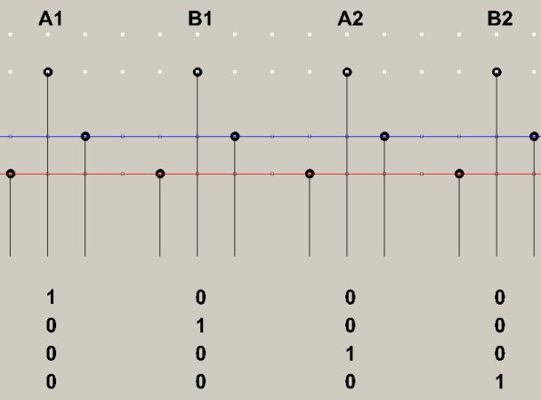

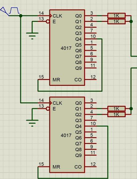

I've been looking ways to make something that produces 'quadrature' wave forms. Not 'quadrant', a term that I mistakenly used.
There are some schematics online, of how to use a D flip flop to make waves, that are 90 degrees apart, but although I have 4013's and 4049's, I just can't figure out how to get desired output.
When testing, they(4013's) give only 'flip', and therefore they flop(pun intended).
Anyway, there seems to be at least one other way to get quadrature waveforms.
In this case, it takes two 4017's (Decade counters, and a generator to run them), and four 1K resistors:

sorveltaja- How do you provide the 4 outputs for a stepper motor? - Phil

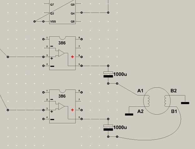

The setup that I'm testing, uses two 4017's that are fed to two 386's. It's just two stepper wires connected to ground, and two other are connected to signal outputs. I've noticed that this circuit has a serious drawback: sometimes the stepper starts to rotate in opposite direction than previously, although I didn't change its wiring, or anything in the circuit.
Re: Simple way(s) to run a bipolar stepper motor?
« Reply #13 on: August 26, 2023, 12:46:59 PM »

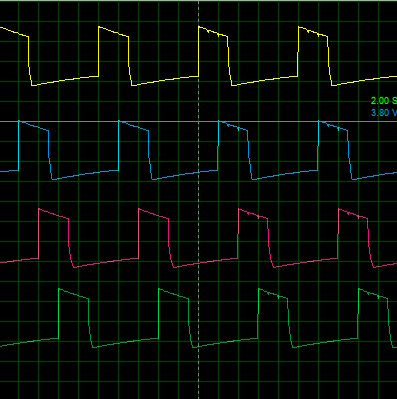

What waveform(s) do the coils see?
An awful lot of trouble to spin a stepper when you can buy 5 driver boards off eBay for £7.90: eBay item number:203578822101
Offline sorveltaja
  • Posts: 645
« Reply #14 on: August 26, 2023, 07:46:40 PM »
The waveforms are rather distorted, although there are some faint(perhaps imaginary) remnants of waves 90 degrees apart. I should have taken scope screenshots of how crappy they are.
But I already removed involved components to test another setup(one can never have too many breadboards). Reason that I use infamous 386's instead of power transistors, is that they can take a lot of abuse without burning out(unless intentional or mistake). It's like a sort of first step to using more current, than I've used in any of previous projects.
So I guess one thing is the current demand of low ohm coils, that distorts the signal of already mis-used 386's. I have to admit, that it's quite steep learning curve for me.

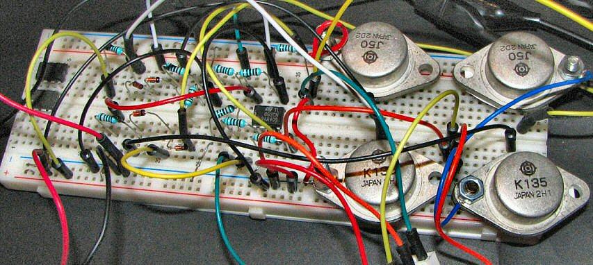

I have some power transistors, but as they require proper setup/circuit (to not use them simply as heating elements), I'll save them for later use, if I get some sense about that current stuff.
Phil, I appreciate your view, and yeah I know that it's a lot of trouble, but I just have this need to re-invent the wheel, and to show others, who might be looking for 'simple ways' to drive/run a stepper, of what kind of problems newbie(like me) might face, while at it :beer:

Bit more testing - this time something that uses split power supply. First one was a simple 'class B' or push-pull amplifier using dual op-amp and two pairs of transistors to feed the stepper coils.
It sort of worked, but the output was far from being smooth, causing the stepper to rumble quite badly.
From what I understand after some searching, transistors are current devices, while mosfets are voltage devices. I have no idea what that might mean in practice.
Anyways, I remembered having some old mosfets, J50's and K135's, and that they were meant to be used as complemetary pairs.
So I started to look info about 'mosfet push-pull amplifier'. One of the simplest circuit I could find is just that - simple.
That circuit might work without an op-amp, but it would have cross-distortion, unless there is something else to alleviate that issue.
I breadboarded a "stereo" version of that circuit, and so far have tested it using two 9V batteries in series to form a split supply.
Quite a mess at this point, but for some reason it seems to drive the stepper coils  smoother, and when the outputs are viewed on a scope, they retain sine waveform a lot better than any other circuits I've tested.
Also there appears to be plenty of torque (again, using finger meter), so perhaps the driving voltage and current follow each other more closely?
Working frequency range of that circuit appears to be from 1(and perhaps below that) to about 100Hz, when nema 17 was driven.
I'll take scope shots once I get more permanent split power supply hooked up.

You have to realise that stepper motors need to be current driven, rather than voltage driven. Most drivers regulate or limit the current once it has reached the level needed to index the motor to its next position. If they didn't do that, there is nothing to limit the winding current in the motor. If you had a 30V power supply and a 3 ohm motor, you would end up with a steady state current of 10A (for a fairly short time!). Instead, they typically use a full bridge with PWM modulation to limit the current and hold it at a sensible (programmable) level.
When you control the position with multiple microsteps, you come closer to driving the windings with 2 sinusoidal currents that are 90 degrees out of phase. However as noted, these need to be currents, not voltages and they need to be a sinusoidal function of the rotor position, not uncontrolled.
As the motor speed rises, you need more voltage to overcome the inductance. Or if you like, the motor develops a back emf (voltage) that is proportional to speed - and when that back emf reaches the power supply voltage, you can't drive any current into the windings. As torque is proportional to current, that means your torque has fallen to zero. This is something that often gets overlooked when people focus on the headline (stall) torque, not appreciating that the torque will fall to zero with speed.
That opamp circuit with the MOSFETs is a (linear) voltage driver, so not really suitable. Ideally it would be a current source, either PWM or linear.
Take the time to study a modern microstepping driver IC, like the I've linked to here. You may not want to take the easy route out but if you digest the datasheet and application notes, you will gain a better understanding of what is needed to successfully drive a stepper motor.
https://www.allegromicro.com/-/media/files/datasheets/a4988-datasheet.pdf
