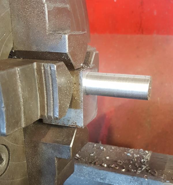

I turned a 16mm shaft onto it, when I got to the hole and saw cuts I got a bit worried about thinning material down so much that it bent and damaged something so used the hacksaw to get rid of them.
After the shaft was to size I drilled a 9mm hole right through it.

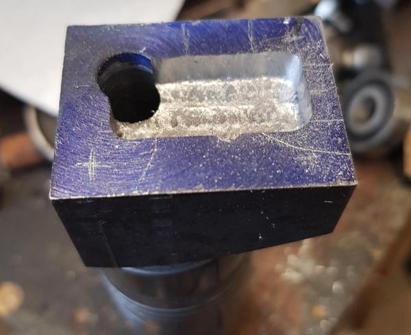

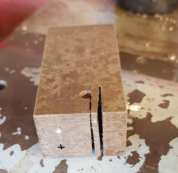

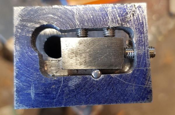

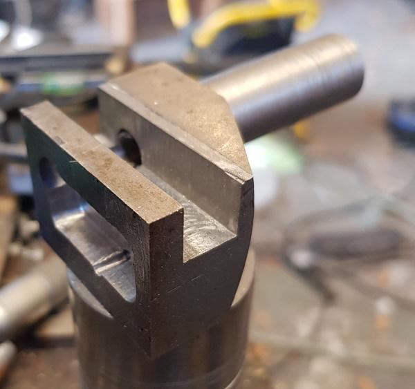

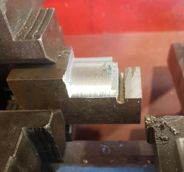

Next I drilled a hole to accept a 3mm needle bearing which will act as a pivot point to allow me to centre the tool and I milled (quite badly, dont judge  :lol:) the opening for the cutting tool. A channel to clear the swarf was also needed PIC2 but after taking this picture I realised I had not milled deep enough so put it back on the mill to remove more.
Last pic shows the tool in place, as you can see the two top screws can adjust the tip up or down as needed while the back one sets the depth of cut.

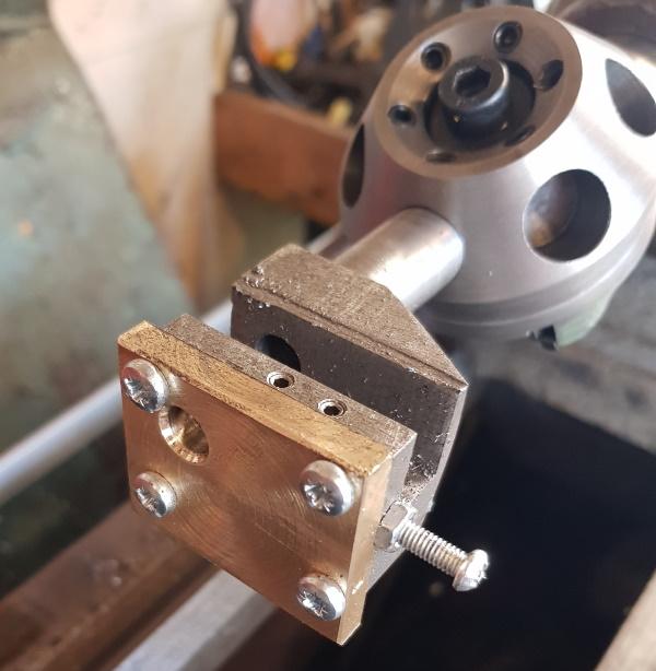

Now I moved on to the front for it which holds the bar secure. I broke a tap in the first hole but managed to remove it thankfully.

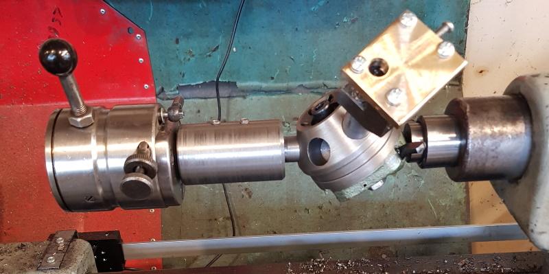

Heres a couple of pictures with it mount in my MT3 turret attachment and I have to say it works a treat I tried to get a pic with the diehead mounted on the turret too but phone is not cooperating for some reason.
So my process to make my 7mm LH screws is cross slide in with a stop set in one tool post, withdraw bar to stop and tighten collet, reduce bar with box tool, flick lathe into reverse and cut threads with the diehead on rough cut then finish cut, and finally part off the screw with parting tool mounted on qctp.
Nice and easy and takes just over a minute each.

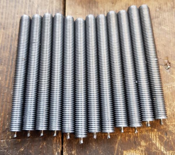

Got phone to cooperate and heres a pic with the diehead on the turret along with the results of 25 minutes work  :D. There is a slight problem with the box tool in that the first 10mm or so curls up the swarf in such a way that it gets pushed into the shaft so I have to remove it after 3 or 4 to clear it but I think grinding the tool differently will solve this problem.
