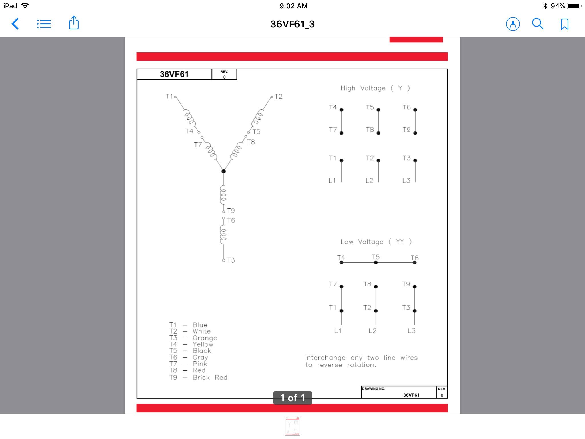

THE LATHE - We were able to change the transformer taps on the lathe with no problems.  We ran into trouble on the lathe motor.  There only one junction box on the motor, with 3 wires on both the line side connections, and the motor side connections in this junction box.  All the instructions in the junction box are in Chinese, as near as we can determine the instructions tell us how to hook up the motor in a Wye or a Delta configuration.
THE MILL - When we opened up the control panel for the mill we found that the manufacturer's label for the control transformer had fallen off and been disposed of.  The prints that we found for the mill show that the transformer has a split secondary, with both 110V and 24V connections - but no other information on the transformer.  The mill motor's junction box on the other hand DID contain the information for the 460V connections - in English.
So, we've got a lathe that we can't rewire to 460V because of the motor connections, and a mill that we can't rewire to 460V because of the transformer connections.  I'm wondering if there's anybody out there with one of these lathes, or mills, with it running on 460V 3 phase that can show me what the required wiring changes would be?  My electricians don't want to let out the magic smoke and neither do I.

OK, it runs 2xx V 3 phase or 4xx V 3 phase….that suggests it’s a dual voltage motor with 9 leads….3 per phase…you should be able to configure it to run off the higher voltage by having the winding in series…

For the lathe, there are only 3 leads going into the motor windings, that's what's thrown us for a loop.  The diagram inside the lathe motor junction box shows us how to connect the lathe motor in either a delta, or a wye configuration - but no mention of voltage.  Unless that is what the Chinese characters are trying to tell us, but that's not very helpful.  The lathe's control transformer still has it's ID tag so we were able to determine how to rewire it to a 460V primary.
The mill's control transformer is the one with the missing ID tag, and it has at least 8 tap connections on it.  They are numbered, but without the tag we've got no clue how they are inter-connected.  Or how they should be re-connected to configure the mill for 460V.  The mill's motor does have the normal number of leads coming out of the windings, AND a connection diagram in English, so we could easily re-wire it to 460V.

If there are three leads going into the box, then it sounds like it’s wired in Star for HV, the Star point would need to be brought out and the ends separated to connect it in Delta ( that would be 6 leads…)  that would be the LV option….but that’s not how it’s running at the moment is it?
You might have to swap out the motor for a proper 460V job….and the mill….a proper 460 V control transformer….as there’s no supporting docs for wiring…
