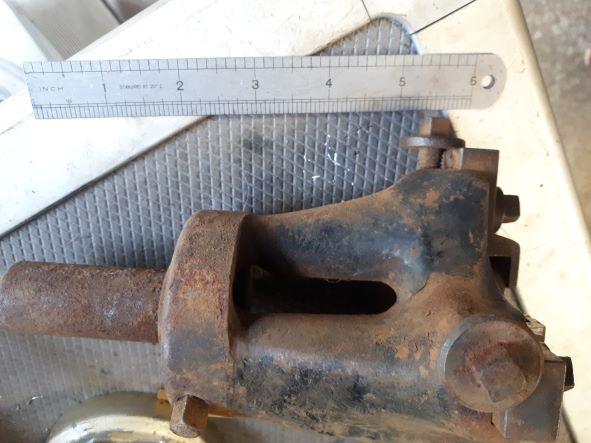

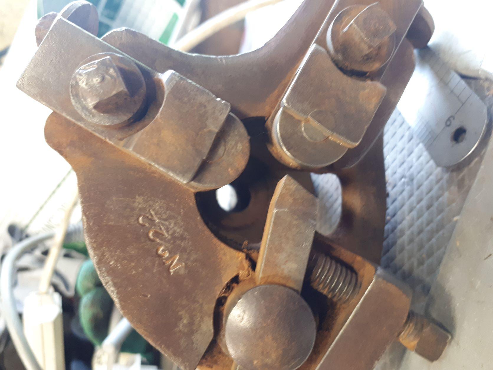

First one, is either for turning small diameter rod or maybe thread cutting ?
I have not seen anything like it before,
Can anyone put a name to it? it has a "No22" stamped on the face, the arbor (?) is approx one inch diameter with maybe 1/2in. bore

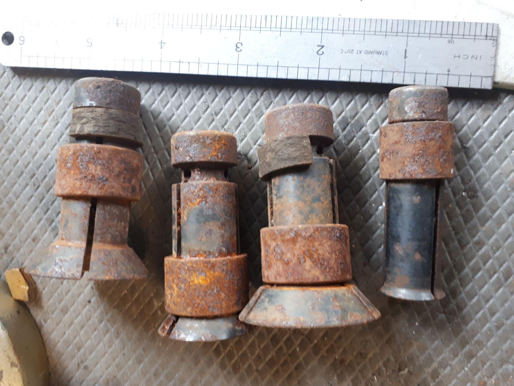

Second, are some type of collet similar to those expanding blind bearing / bush pullers ? but I have no idea what the rest of the "tool " should look like

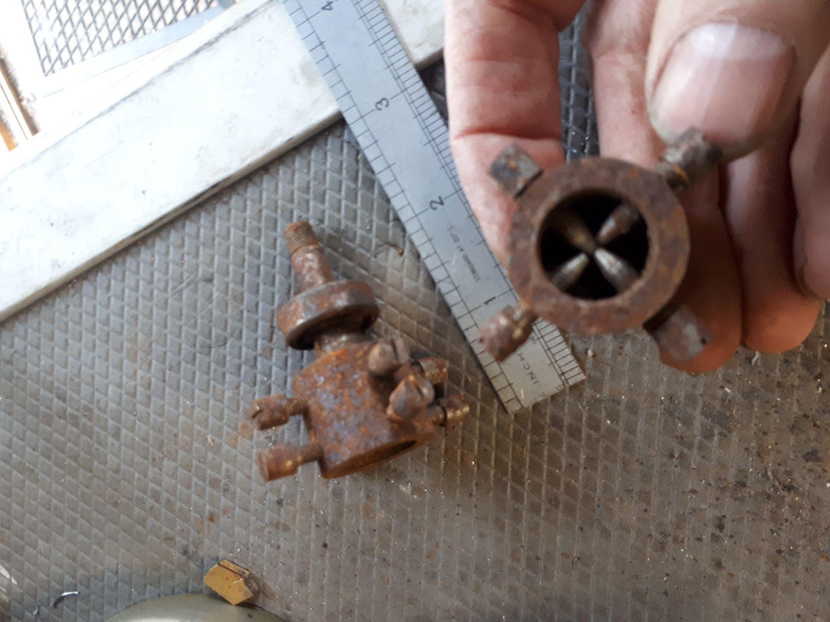

Third items are for clamping onto some object , 8 pointed clamping screws and a spindle with a very fine thread at the end, one has a bearing on the spindle

Id guess the first is either for cutting threads, or sizing rod, or a cutoff tool like a pipe cutter. Or maybe a multipurpose tool for all three.

Third is a small bell chuck.

I'm voting "box tool" on the first...  turret lathe tool.

It’s all turret tooling from something like a Ward turret lathe. There is a classic roller box, collets with collars to let them mount in the holes in the turret, and a Cats Head chuck.
