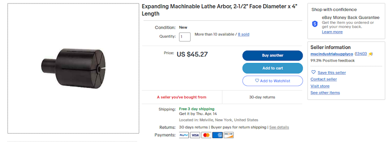

Here's a little item I laid out 45 bucks for  :wack: :wack: :wack::
MSC Expanding Machinable Lathe Arbor, 2-1/2" Face Diameter x 4" Length
What's wrong with this picture?

Dunno, could be many things. One problem might be thin wall on stub, that expanding screw looks relatively thick.

A tiny screwed taper trying to move large chunks of steel. The centre hole and taper should be much larger.

I'm not sure that the screw looks long enough to engage the unslotted part of the arbor.

Seadog has it. Everything else in the ad description is truthful. It WAS 2-1/2" in diameter. It WAS a mandrel. It DOES fit in a lathe, and it IS machinable.
It just doesn't expand.

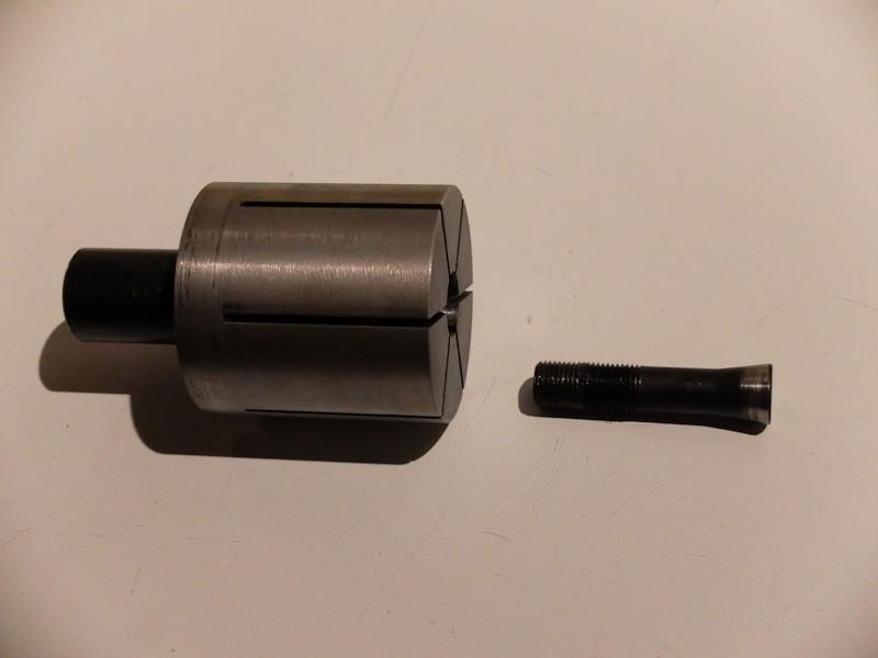

Well, I take that back. If you take the 8mm Allen wrench supplied and cut with a grinder to a straight length and then weld that into 1/4" pipe, then make a 4" Tee handle for it, and try to expand it with that wrench and find it still doesn't expand perceptibly, so you slip a 8" pipe cheater over the new wrench handle and apply force until the expansion screw stops in a tight jam almost impossible to undo even though you greased everything with high pressure grease, you will get a measured .005" of expansion. Only at the very tip of the far end.
Who in their right mind thought that a small screw would perceptibly deflect six 3" long pieces of 1" thick tool steel enough to grip a part in a lathe? A part, which, to slip onto the 4" long arbor, needs at least .005 inches of clearance in the first place?  And the available .005" expansion only achievable with an oversized dumb-donkey wrench and cheater bar?
How can MSC ship these things out with a straight face? Have they ever tried one? Was it an April Fool's Day special, and I didn't notice?
Ya know it's not unusual for me to buy "cheap" tooling (this wasn't cheap btw) since it's what I can afford, and then have to correct something, or find a way to live with some small issue, or for it to have limited life, or a rough finish, etc. But this is a first..... where the simple purpose of a tool is so completely and obviously missing. An expansion arbor that doesn't expand. What were they thinking? That no one would notice?
I mean it seems obvious in hindsight, and embarrassing, not comprehending for several hours, so sure that it must work, that I went to the trouble of making a bigger wrench for it, somehow still believing that those 1" thick jaws would move. Of course they can't! Just look at the damn thing, Steve!  :hammer:

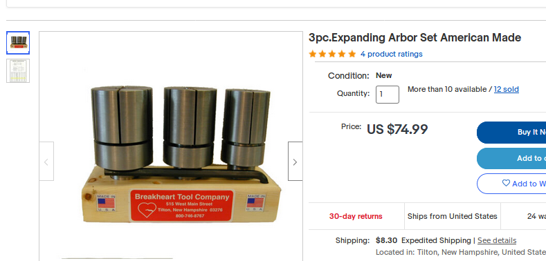

Well, notice the following ad, also found on Ebay. See any difference? And these are smaller -- 1-1/2" 1-3/4" and 2"...

I think you're going to have to try machining that groove!

So, how deep should we relieve this thing? Well, looks like the properly made set has a 1-1/2" diameter version, and it was found necessary there to add relief -- so checking that photo and enlarging it, it appears to me that the relief cut is a little shallower than the chucking stub. And checking their specs in the advert, that stub is 1" dia. So the relief cut must be less than 1-1/2" dia and more than 1" dia in depth.
I make that out to be 1-1/4".  :smart:

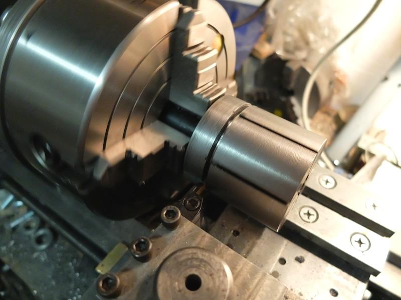

Turning a relief slot. I went in a half inch -- the example arbors would have meant going in 5/8", but already I have 10 thou expansion now with reasonable hand tightening of the wrench instead of 5 thou wrestling a cheater pipe extension on the wrench to get it.
Ten thou is a reasonable tightening range, since a typical tube part requires about 5 thou clearance to slip onto the arbor before tightening. Another 5 thou of range gives a good enough grip for what I need
The original supplied 8mm Allen wrench gave no expansion at all prior to modifications and before the bigger handle wrench was made.

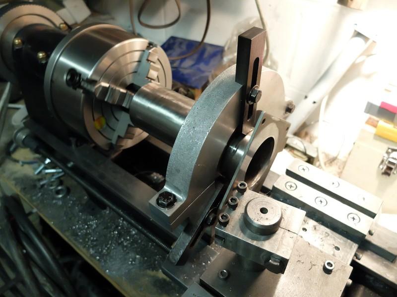

Facing a flange on a thin wall stainless steel displacer cylinder for a Ryder engine driven by the corrected expansion arbor and held in the new steady rest.
