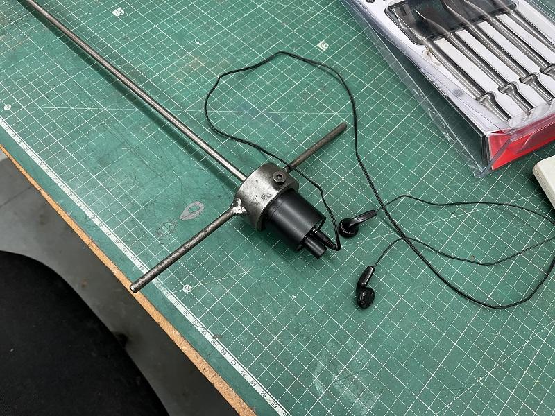

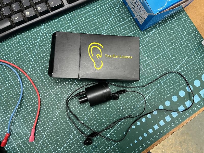

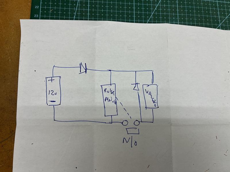

The Problem: I have a ditch and a stream, both of which are crossed by a 25 mm MDPE blue mains pressure water pipe - I'm ditching both water ways and need to avoid the pipes. Both were laid over ten years ago by trenching up to the the banks, and indeed down the banks as far as possible, then the pipe were trodden into the silt as deep as we could. Location known approximately but not accurately.
The Solution: A "Water Thumper" my google research tells me. This is a device connected to the nearest tap, and consists of a water solenoid valve and some electronics to rhythmically turn it on and off like a heart beat. This imposes a pressure wave ( and hence sound) in the pipe which can be detected by a suitable probe pushed into the earth.
. . . . how hard can it be to make that ?

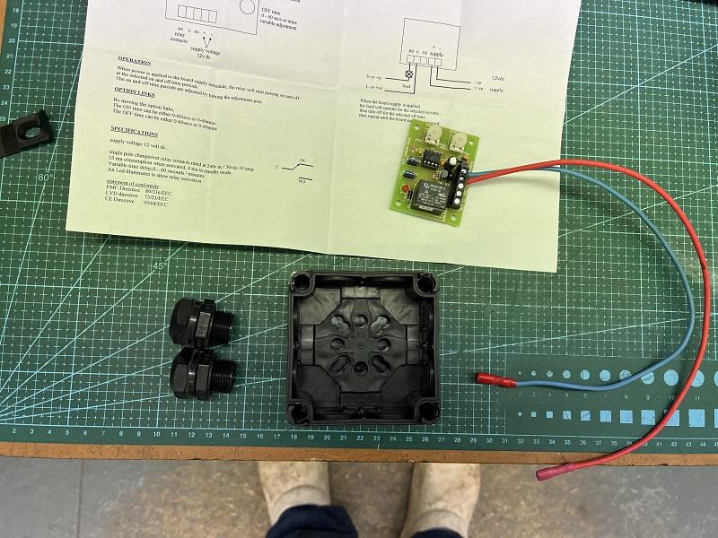

So I ordered some bits off ebay. A pulsing bit of electronics, a water valve, a Chinese 'spy' listen through walls audio detector device  and a waterproof box.
I turned up a socket for the audio device and welded it to a suitable ground spike

The water valve persistently didn't arrive  :( Never mind I had a nice solid brass one intended for a different project - at least test it on the bench with that.

Now the circuit is pretty simple accepting that some one else has kindly programmed the PIC controller. There are two timers controlled by twiddle pots. One for on time and one for off.
I feed the circuit via a diode to save it from reverse polarity issues, and the back emf from the solenoid valve is quenched by another diode. All standard practice.
