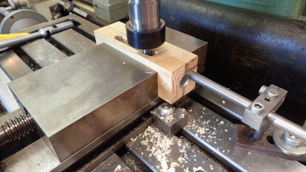

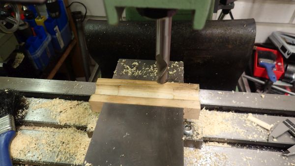

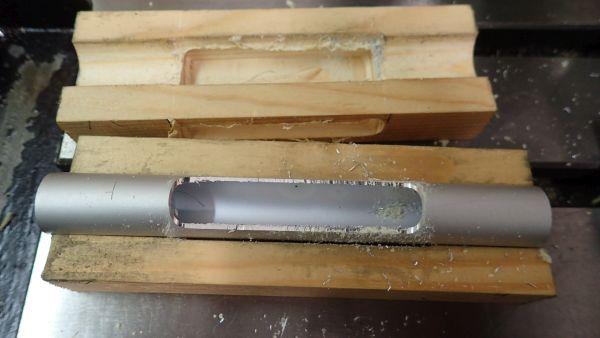

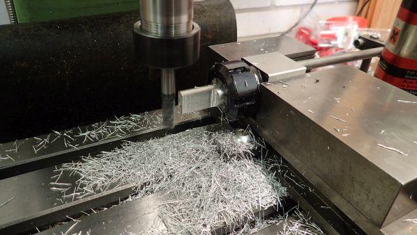

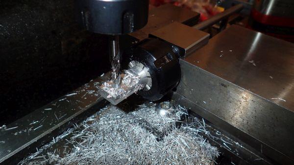

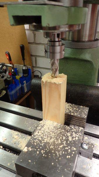

Mentioned on other thread that I use sometimes wood in metalworking. Here I had thin walled pipe that would have been awkward to hold on another way. As you see wood is pretty elastic and I produced scalloped edge with end mill....should have been feeding a bit slower.
Not finest work but will do on this

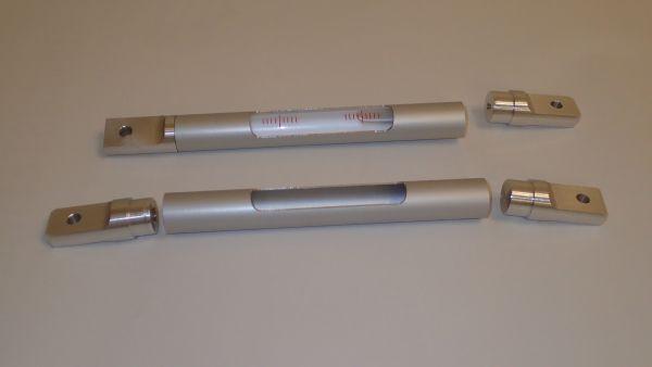

Pekka, what are the parts for?  :beer:
Re: Brown stuff as a jig.
« Reply #5 on: March 25, 2022, 06:57:33 PM »
Spirit levels for sort of king way alignment tool.
I have vials. I got today spherical washers to allow tilt the vial tubes for adjustment, but looks like I need "plan B" to execute it.
