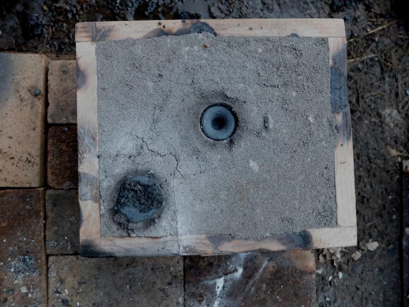

So I band-sawed out a simple 6-3/4" disk out of 3/4" plywood for a pattern, rammed it up in greensand, and did a little larger melt than I had before in my A6 crucible. The iron is from a brake disk -- about 11 pounds was melted, and I added .35% ferrosilicon. The furnace had been fairly extensively patched, and completely re-coated in ITC 100HTceramic coating.
For some reason the furnace took much longer to melt that iron, about 50 minutes compared to 20 in the prior 3 runs. I was using off road diesel instead of regular diesel. It seems to have different characteristics, and I'm wondering if the furnace damage as well as slow melting is a result of the recent change. I will probably switch back to regular diesel -- particularly here in winter temperatures, when viscosity is heavier for these light oils.

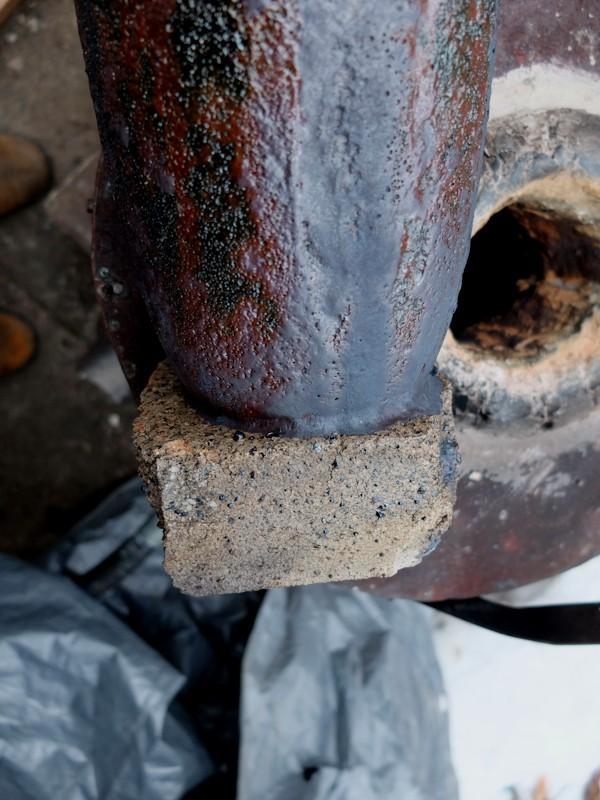

Everything did eventually melt -- I did have to add iron as the melt progressed to fit it all into the A6. But when I went to pour, the crucible again stuck to the firebrick plinth. I had put cardboard under it, but I think the longer melt and fuller crucible resulted in slag dripping down the outside to weld the crucible to the plinth.
This discovery right at the pour meant I couldn't easily get the ring shank onto the crucible -- the firebrick was too large to set it in the ring. But because the shank I'm using now is expandable I was able to stretch it down over the top of the crucible, and pour that way.
\Unfortunately in the excitement of trying to get the crucible situated in a shank in time to keep it hot, I wasn't able to do as good a job slagging just before pouring it. I had slagged once while it was in the furnace, however.
Anyway the pour was accomplished, and the crucible returned to the furnace to cool down slowly.
I had put a big riser in the center. The sprue showed pieces of slag, the riser looked clean, and shrinkage was very apparent as it cooled.

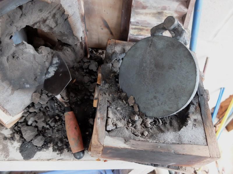

And, here is the break out. I was pretty well pleased with the casting, considering the pattern making was about a 10 minute afterthought on a day I hadn't actually planned to cast on....., and the problems I had with the crucible sticking when I did.

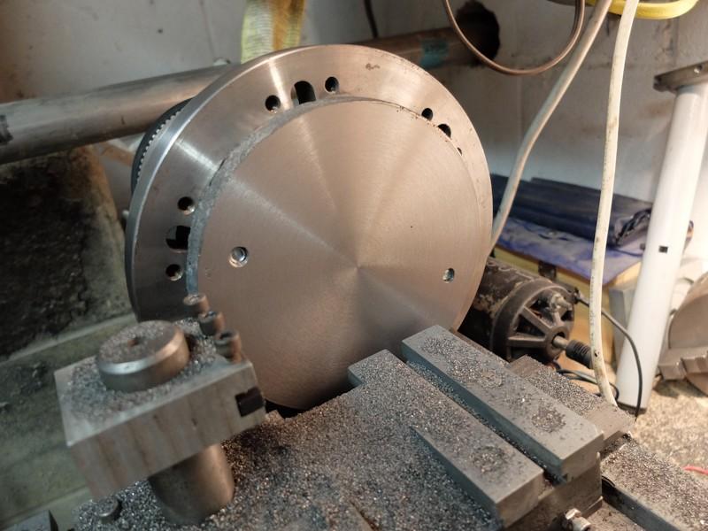

And here it is being machined on the new lathe's faceplate, which it will eventually replace. To clamp it, I simply drill two holes in the plate, tapped them, and bolted it in place.

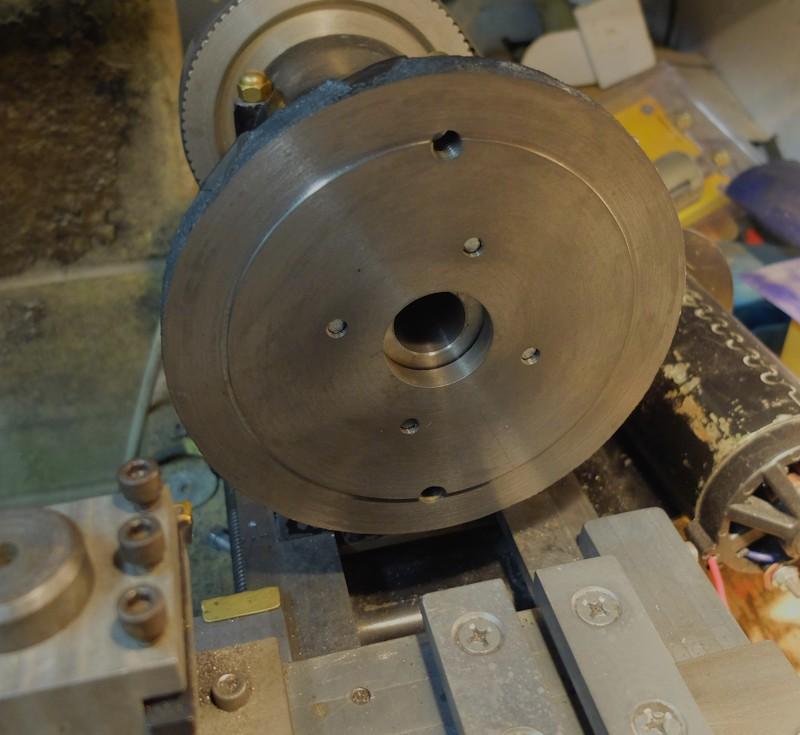

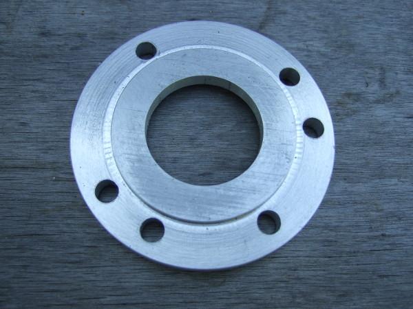

I bored the through hole and turned the back registers and drilled for the spindle mounting bolts. That was made easier because when I'd built the lathe, I made a gauge for the spindle mount. It definitely came in handy this time around. The one face fits the spindle, the other fits the fixture to be attached, and bolt hole patterns for 3 and 4 bolt fastenings are located.
I tapped the backing plate then bolted it to the spindle. I put a final light truing cut on the face, then I turned the front register to fit the new 6" 4-jaw chuck. I will mount this with hex head cap screws, rather than Allen screws -- much easier to remove than those on the import mini-lathes, as there's room on my lathe to swing an open-end wrench behind the spindle bolts, and the backing plate bolts.
I need to  drill the backing plate for the chuck mount. I think I'll also drill holes for my 5" 3-jaw chuck, as they can share the same backing plate. The 3-jaw won't have a register, because I just bolt it up lightly, and then tap it into center using an indicator on a bit of shaft held in the chuck. Then tighten the mounting bolts. No runout due to mounting. Worked great when it was mounted on the faceplate, and I'm sticking with that method.
The 4-jaw does have a register, just for convenience in mounting. Obviously you can true up any gripped workpiece in an independent 4-jaw chuck using the chuck jaws.
Plug gauge back and front, and the backing plate ready to drill for the chuck(s):

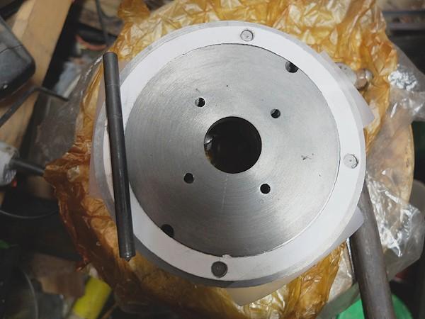

Okay, end of the day, how to locate hole centers in backplate to fit the chuck? I don't have any transfer screws, and didn't want to make some -- and especially not for M10, since they'd probably never see use again, and besides, my lathe isn't functioning at this stage to make them.
You could measure out the locations, using a square (there are 4 bolts), if you had a center point to work from, but the center of the backing plate was bored out. I could possibly stuff a piece of wood in there, saw off flush and find a center there to work from.
Or you could put it on a mill and drill there -- probably the smart way to do it. I don't have rotary table, so I'd have to do it by coordinates, no DRO either so I'd have to read dials remembering backlash, etc. But also my mill is in a really cold space right now, and the setup would be like minor torture.

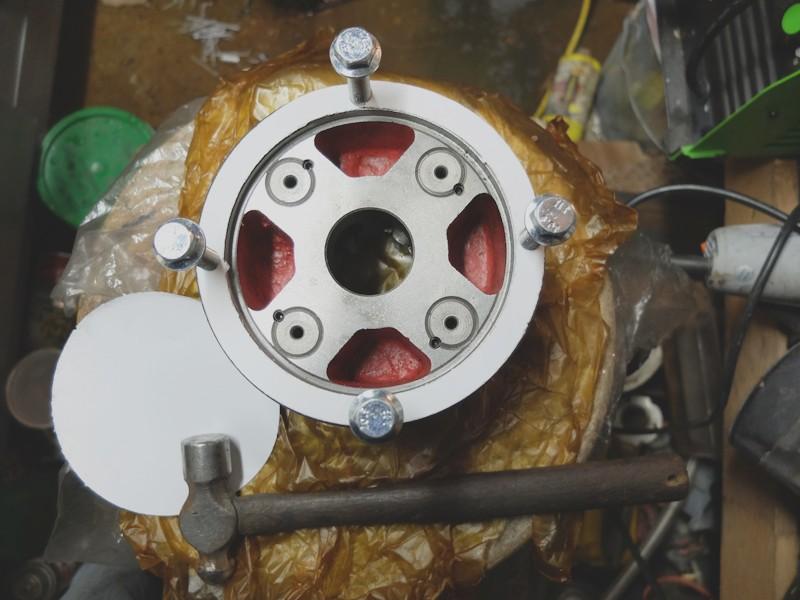

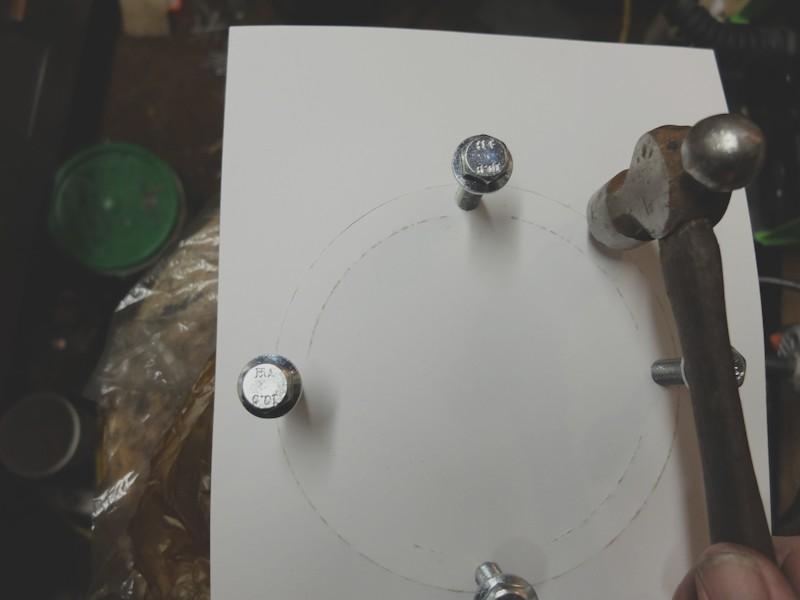

So, I decided on another way. I found a piece of stiff cardstock and laid it on top of the chuck. Then poked a pencil through it to locate a threaded hole. I put one of the M10 bolts through that hole and screwed it in a short way. Did the same for all the other mounting bolts.
Then I took a small hammer and tapped all around the chuck back face outline. This is the same way you make custom fiber gaskets. The light tapping cuts the paper to the shape of the surface it is lying on.

The finished paper template lying on the chuck:
Re: Casting a Lathe Chuck Backing Plate
« Reply #9 on: March 10, 2022, 07:22:20 PM »
Here is the template on the backing plate. It fits over the register. I taped it down and the used a transfer punch of the same size as the holes to line up and punch the hole locations. Though a transfer punch doesn't bear against paper like it does in a hole, it is useful as a visual guide to center the punch.
This isn't exemplary precision machine layout, but it is as likely to be as accurate as doing it with a square and measurements from a wooden center -- in my hands at least!  :zap: And the register is what really counts in mounting the chuck, as long as the bolts pass though the plate in line with the tapped holes.

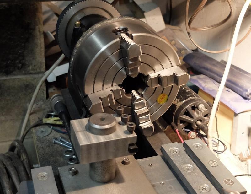

And at the very end of the day, here is the 4 jaw chuck mounted on the lathe.  :ddb: :ddb:
All that's left to do is turn the rim of the backing plate smooth to match the chuck circumference.
