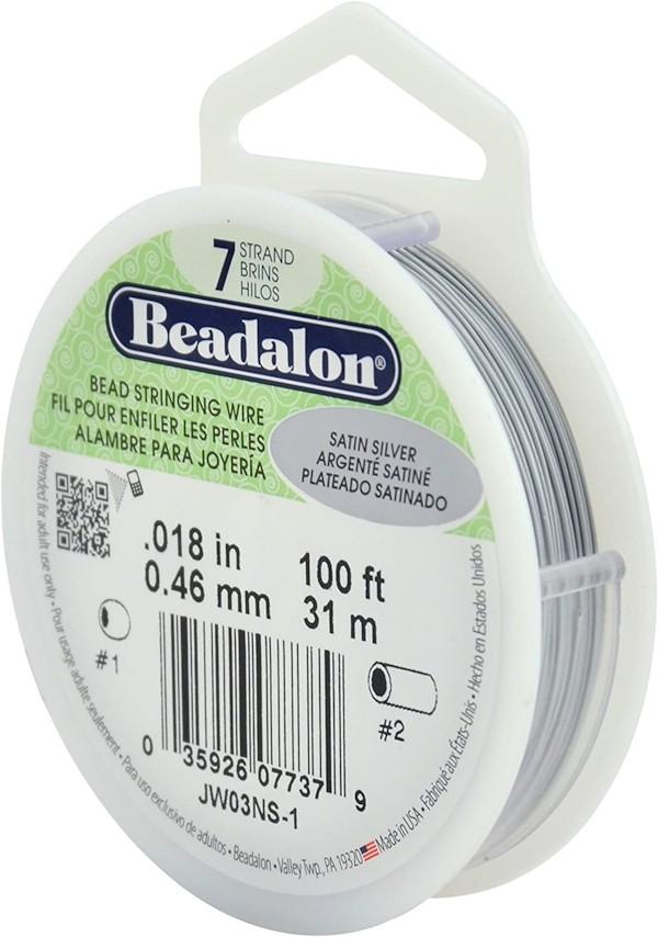

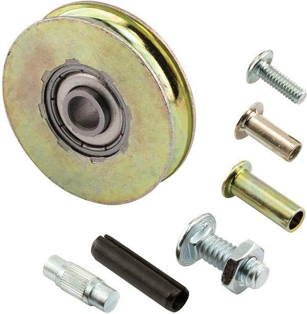

I spent all day yesterday working on a futile arrangement of MDF discs and wires (fishing trace).  The MDF material was totally unsuitable and the trace wires would not play the game.  So I pulled it all apart to salvage a few bits and start again.
Version two will have sprockets and chain to keep the moving arms synchronised.
  • Posts: 6829
Re: CNC painting system, another silly idea?
« Reply #17 on: February 22, 2022, 10:53:01 PM »
Suggestions: sliding glass door track pulleys, and fine stranded coated bead cable available at craft stores/places that sell beads for stringing into necklaces.
« Last Edit: February 22, 2022, 11:21:46 PM by vtsteam »

Thanks, I will keep that sliding door hardware in mind.
