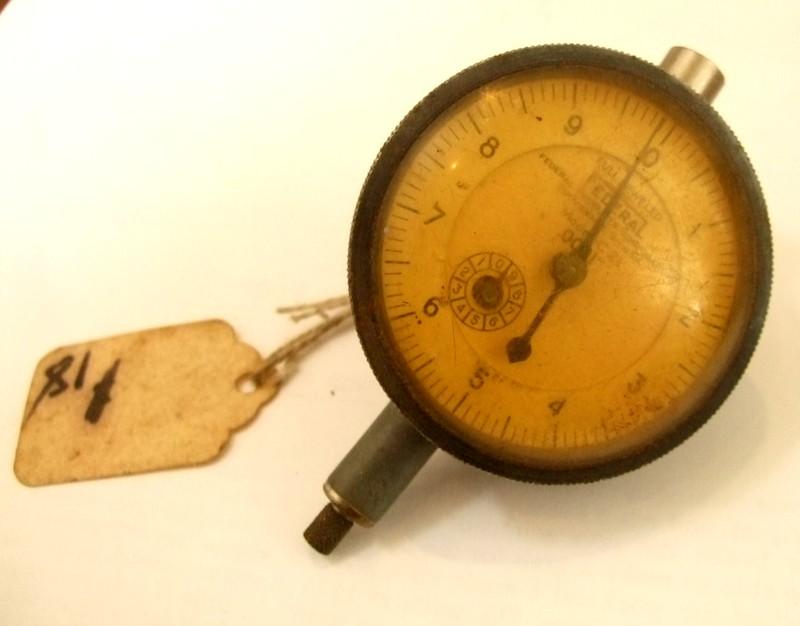

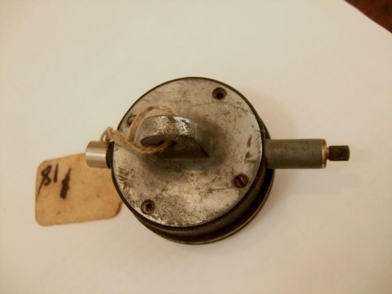

I've had this DTI sitting in a drawer for easily 5 years. I got it at a flea market. Hard to read even what the dial says under the yellowed glass, Federal and then Model C21, and .0001".
From the overall condition, long storage and, now I see, missing screws, I'm worried the insides aren't in great shape....
Guess I'm going to try taking it apart. Maybe Bob is watching ....... I hope!  :borg:

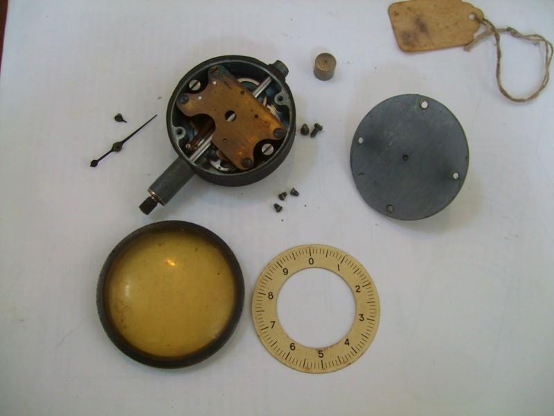

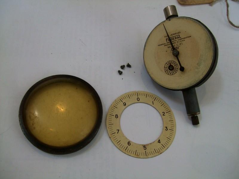

Three screws held the bezel on. I didn't want to bend the hands by lifting it straight off, because the numbers ring would have interfered. But I was able to lift it at the short end of the pointer, then shift the whole bezel up and off the hand, and free of the body.
Re: DTI Challenge 2022
« Reply #2 on: January 25, 2022, 02:06:17 PM »
I removed the large pointer by slipping a pair of tweezers under it, closing them lightly, then lifting up so that each arm of the tweezers was lifting flat against it. It came loose with a little pressure, and I was glad the hand wasn't bent in the process.
The small hand was a little more difficult to figure out. I couldn't fit the tweezers under it. But two miniature flat bladed screwdrivers did fit under, and luckily, it was an easy sliding fit on its shaft.

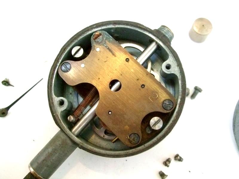

I then took off the zero adjust cap at the top of the gauge, and removed the back of the DTI. There were only 2 screws of 4 in the back. The mechanism cage is brass, but the instrument case itself seems to be zinc die-cast.
« Reply #3 on: January 25, 2022, 02:23:29 PM »

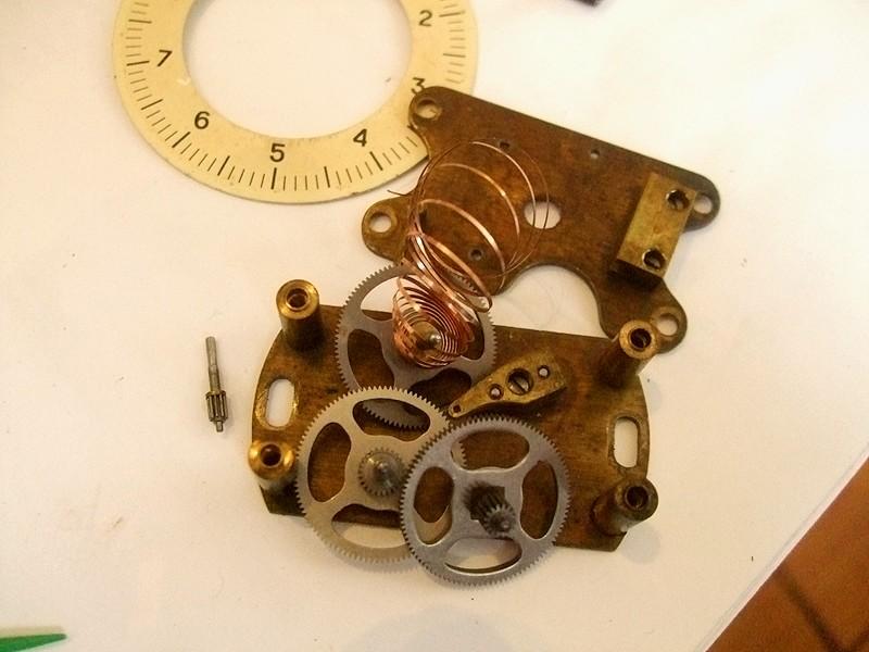

The works looked better than I had feared. But the screw holding the brass plate on in the upper left corner was corroded some. It is located where the two missing screws in the outer case rim were. you can just see one of the resulting holes in the case, above it.
I was able to turn the other three screws without a problem. But I couldn't budge the corroded screw. I haven't applied too much force, as I don't want to strip the slot or twist off the screw. Not sure what to do here exactly. Maybe some kerosene (paraffin, UK) applied with a toothpick on the screw post joint under the brass plate....?
The movement seems to be pretty good, and from what I can see, undamaged. But it is slightly noisy -- and occasionally tends to not return to zero perfectly without a little help, so I think it needs cleaning.
I am a little nervous about opening it up further. I have visions of parts springing out all over the place, and/or not being able to replace everything exactly where it goes, and in proper relation/orientation.

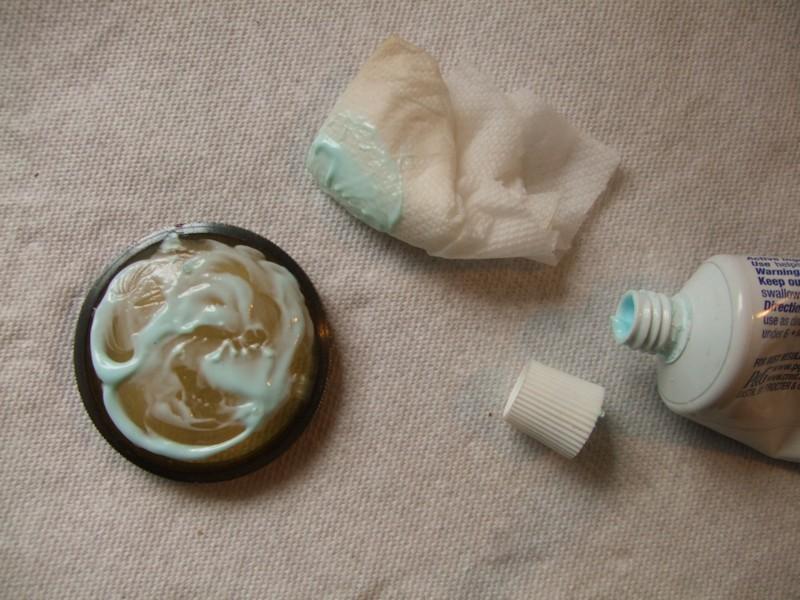

Avoiding the problem of the stuck screw temporarily, I got some toothpaste (old fashioned Crest Regular -- the type with abrasive in it, not "gel) and started polishing the plastic bezel.
(I also did add a couple toothpicks worth of kerosene to the stuck screw, hoping it will penetrate.)

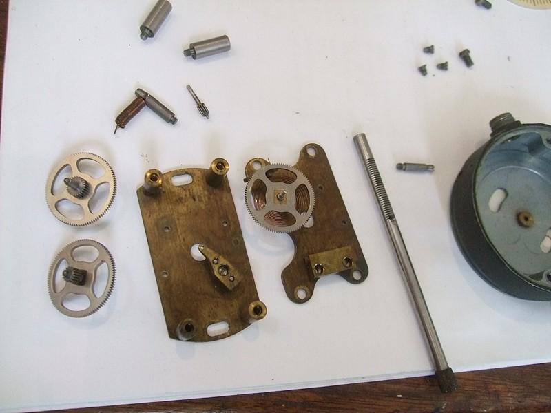

The pieces and parts. I washed everything in warm water and dish soap, using an old toothbrush as a scrubber.

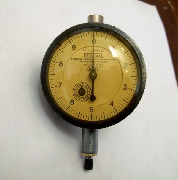

Anyway it's back together, cleaned and carefully oiled (lightly as per Bob's video -- though only with 3-in 1 since I don't have instrument oil).
Results, it is much easier to read, it sounds "proper", and smooth.
Problems: still yellowed bezel, return to zero is not consistent.
On the return to zero -- it was losing about a tenth of a thou, every time it was pushed to full reading and released. This, I believe turned out to be the plunger end screw, located at the top of the clock. It's housed inside a removable cap. It sets the zero limit. It was turning itself loose ever so slightly every time the DTI was cycled. That is easily remedied with a tiny dab of paper cement on the screw threads. I don't believe this screw is supposed to be bottomed out tight, but allowed to float and provide that zero adjustment. But I might be wrong......Bob, any idea?
Second problem with the return to zero: once the screw setting was remedied, if pushed to full limit, the pointers would return to zero fairly consistently, but if turned to say a quarter rev of the pointer, would not return all the way.
I'm not sure of the cause here -- could be friction/wear, or weak return string, or mis-assembly.
For wear/friction, I'd guess that the most likely suspect is the tiny pointer pinion. It seemed a little worn, by eye. It revolves the most of any shaft in the movement. It gets a lot of end pressure also, when the clock hand is pressed on, or pulled off. Or maybe its bearing hole was supposed to have a jewel in it....??? The pinion shaft fits into a brass block bearing that looks to be hand made. Is this block original?

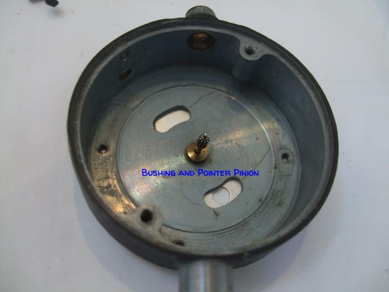

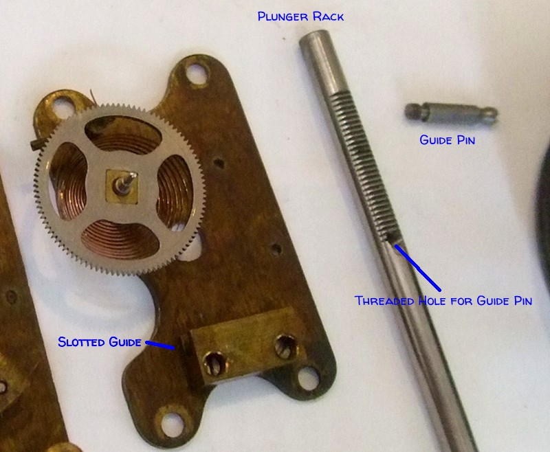

I took it apart again and checked out the pinion with calipers. It actually doesn't seem worn to me, it's simply reduced at the top and then splined. I think also I may not have pressed the pointer on far enough to keep the pinion gear from having end play.
The bronze bushing on the clock face does have a fair amount of wear, however..... (photo below) or at least it isn't a close sliding fit on the pinion shaft. A much easier job to replace if I decide to in future.

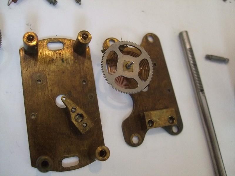

I also felt that I may not have properly lubed the plunger rack and the plunger rack guide -- which is a flat slotted brass piece (photo below). A rod slides in the slot to keep the plunger from rotating. When I tried those parts in place while the mechanism was out of the case and the pinion removed (no gears meshing with the rack) I could hear a slight squeek and feel a little resistance to moving the plunger.
I had previously tried putting a tiny amount of oil on the guide rod that slides in the brass guide. This also carries a spring and it's very fiddly to screw into the plunger, twist and then engage in the slide. When I did that previously, I don't believe the oil actually made it to the guide brass by the time it was installed.
I also hadn't understood earlier how to engage or disengage the plunger rack from the mechanism gears. I now realize that you can rotate the assembled mechanism inside the case before fastening it down to disengage or engage the rack. I thought the adjustment was only to center the pointer spindles in the face, but it has a mechanical assembly purpose as well.
This made assembling the plunger much easier this time, and I also was able to oil the slotted brass guide instead of the guide rod.

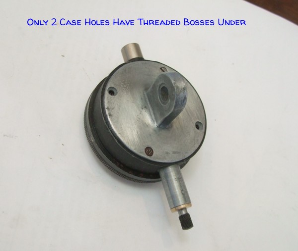

Reassembly went better all around, and this time, the indicator does return to zero most of the time, though it's a little lazy if you move it less than .002 from zero. It then returns to about .0004. Otherwise it zeroes well. I think it's probably usable, assuming you want readings anywhere else.
The range is to 90 thou. Technically it should be 100 thou, and I could unscrew the zero adjust screw to add another 10, but with the wear and spring strength as it is, that reduces return force, and makes zero less certain.
Ideally the pinion bushing should be replaced, and maybe a stronger (or shorter) return spring would make zeroing perfect, and give the full range, but I think it should be good to try as is.

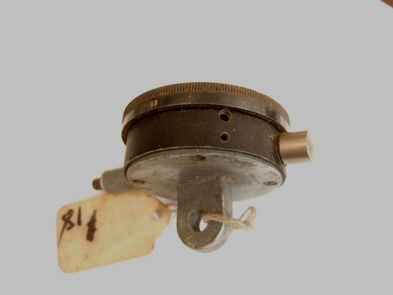

Another interesting fact, only two of the case holes have threaded bosses under, so only two screws can be fitted -- which was probably the original configuration.
Here's the indicator after cleaning, and oiling, polishing the lens and reassembly.
