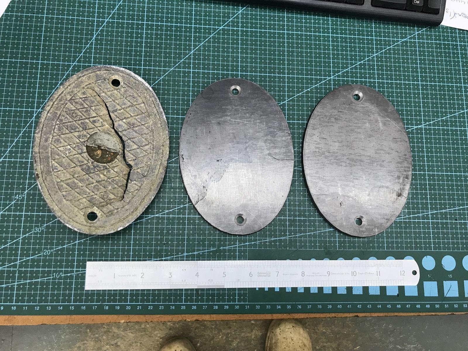

Every year about this time we have our private sewage system (Klargester) serviced and the sludge pumped out. A few years ago their two big trucks managed to break one of my manhole covers, (which they denied having seen) so now I put traffic cones on them so there is no excuse. This year when placing the cones I noticed that two adjacent aluminium 'rodding eye covers' had been cracked at some time - probably not by them so I needed two new covers. I can buy the complete assembly for about £25 but NOT spare covers.

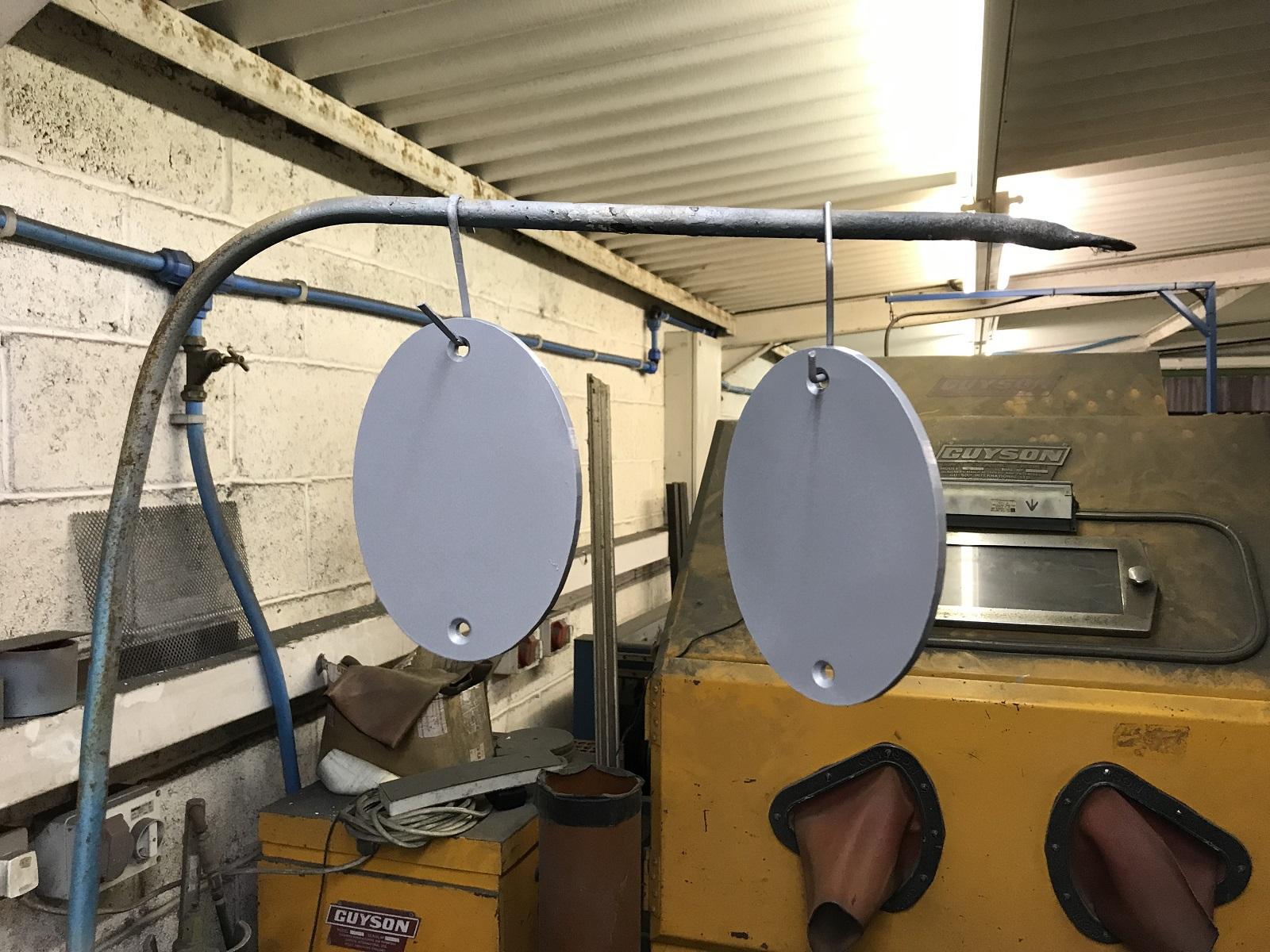

Handy having a CNC Plasma Table - turns out that the covers are true mathematical ellipses so easy to draw in Autocad - would have liked to cut them from 6 or 8 mm aluminium tread plate but none to hand, so the plate of 1/4" mild steel that was on the machine got used. A coat or two of cold galvanising will delay rusting a few weeks (!) but I'm sure they'll be fine for years.

Nice job Andrew. Is a small widget not necessary to assist in future removal, as being steel will they not rust themselves to their surround?

There is 'screwdriver room' round the edge and the recess is cast aluminium so 'should' be OK. If I happen across some aluminium (thick - 6 mm plus) durbar plate) I'll re-make them. I have at least a dozen of these rodding eyes round the farm but only these two are where vehicles can get at them. I'm quite surprised that they've cracked as they only span 4-1/2".
