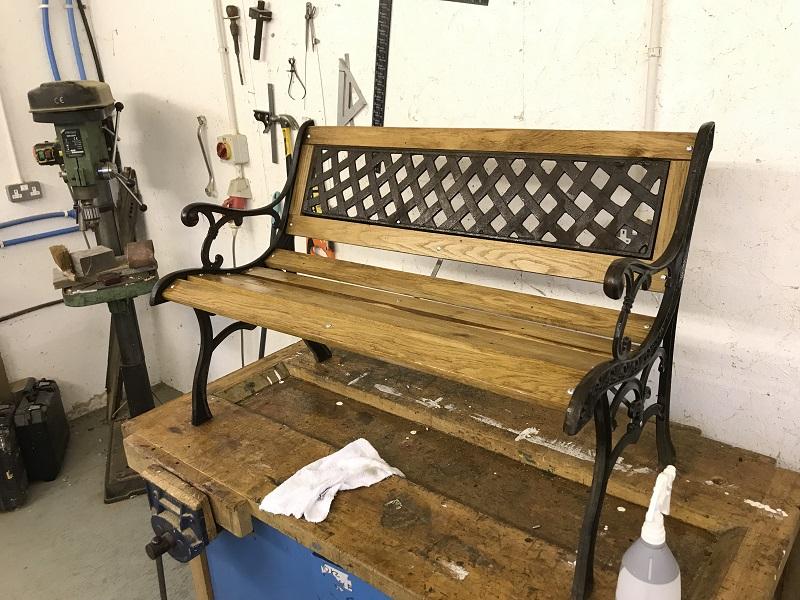

So, now today IS the allotted day for the bench. Simple really, drill the ends of the slats for 5 mm bolts, cut the remaining old ones off and discard them, and then start bolting it together - it's a bit like wrestling a set of bagpipes as there nothing to hold it upright, but I got there in the end. The only complication was that it had to be one inch narrower than the original (that door wasn't big enough!) and matching the slat spacing to the ornamental cast back insert took a bit of head scratching.
But from painful beginnings I'm quite pleased with it - I've just bent up and fixed the reinforcing / bracing steel work that stops it racking, and given it a coat of Lanoguard (this is the hugely expensive stuff I've bought to stop the JCB rusting once it's steam cleaned so I hope it's grateful!)

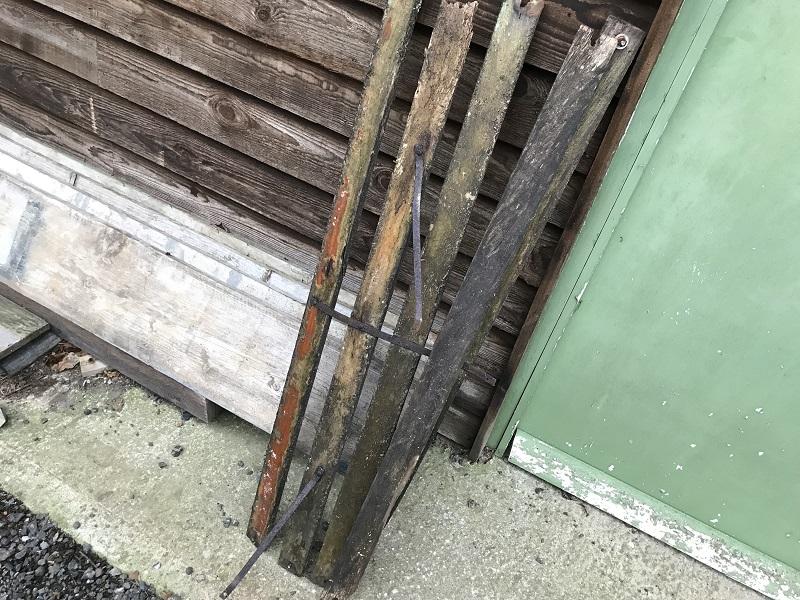

Andrew, for once a question rather than a comment. Does your bench have stays underneath between the slats and the end castings to maintain the correct geometry?
I have what looks like the same bench but without the two metal strips.
Re: A Garden Bench Lives Again
« Reply #2 on: December 20, 2021, 05:02:24 PM »
Yes if you look at the picture of the old slats the old and rather flimsy stays are still attached.
I bent mine up from rather more substantial material, probably 1/2” x 1/8”, as it was the lightest on my stock rack. However I also changed the layout, with one running fore and aft 90 degrees to the slats, at their midpoint, bolted to the front, centre and rear slats. And also one running parallel to the slats as one piece, with the centre  on the same bolt as the fore and aft one at the centre, with its ends bent up at 45 degrees to meet the side frames with the last 1-1/2” bent up to be parallel to the frames to take a through bolt.
The result is a very much more sturdy bench than it was before.

« Reply #3 on: December 21, 2021, 05:48:50 AM »
Andrew your mods are a good idea. My bench relies on the rear panel to keep the sides at 90 degrees to the slats. Not a rigid desing at all.
Thanks for the modification idea.
