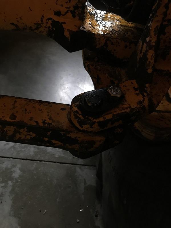

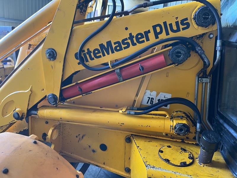

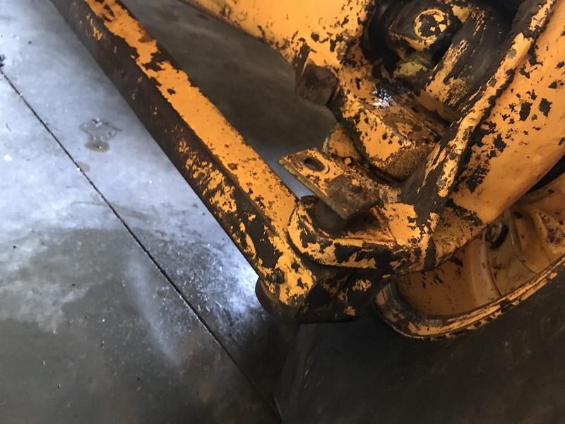

With all the faffing about failing to get the steering ram pin out I hadn't finished the tie rod - the off side bush, pin and seals were still sitting on my desk in the workshop nagging me.
So with slight trepidation, not wanting to start another mammoth task I set too. And I'm delighted to say that the pin came out with two bursts of the air hammer and the entire job took about an hour including rebuilding my grease gun :clap:
Quite significant wear on this side (why more here  :scratch:) - the nominal 25 mm pin was down to 24 mm in places and the bush was at 26.5 at the worst place.
Previously, when the front end was up on the bucket you could grasp a wheel and rock it quite a bit - now there is no discernible play  :thumbup:
So just that pesky steering ram bush and pin, but that will have to wait until the season is over. If only it was a 'through pin' and not buried in a blind hole.

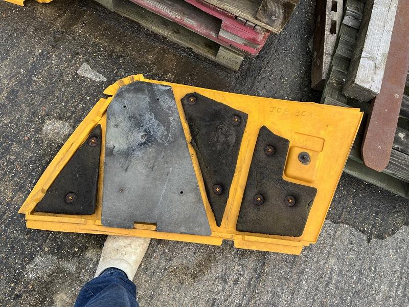

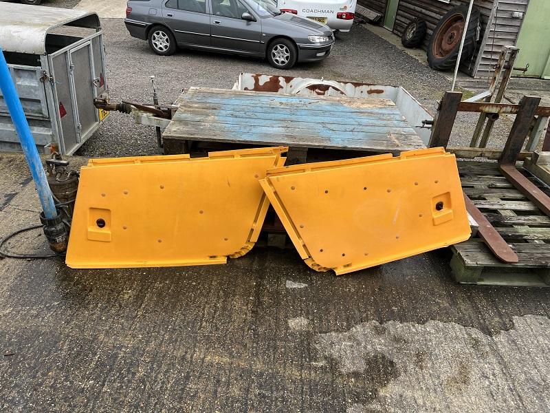

I got a call the other day from the chap who I bought the JCB from. He'd found the 'engine covers' which he hadn't thought that he still had.
These were originally optional extras, and a designed to reduce noise as much as keep the engine clean of mud etc. Project 7 ones and Project 21 ones regularly turn up on eBay (at a very silly high price) but I've not seen them for this Project 8/9 machine - available new but again at a silly price and they are by no means essential - but nice to have.
He let me have them for a modest price and they arrived this morning. Rather filthy so they've been pressure washed and will be mounted when the sound proofing has dried - or I may replace it as it's acoustic foam and showing it's age by being rather crumbly.
In other news: Ditching paused as the first lambs arrived this morning, one is not feeding and is on the bottle already, and as the lambing shed is on the other side of the hedge from where I'm ditching the attendant noise isn't wise!
Having had a fan blowing on them overnight the foam sound deadening on both engine panels is now dry, so I've re-fitted them.
The fit isn't brilliant - I suspect that the front nose cone / radiator cowl arrangement has met with a mishap at some time as the angle that it sits at isn't quite right compared to the shape of the panels. I can't see that the panels have altered so the cowl must be bolted on at a slightly jaunty angle.
. . . another winter job to put on the list but again definitely a non-urgent one.

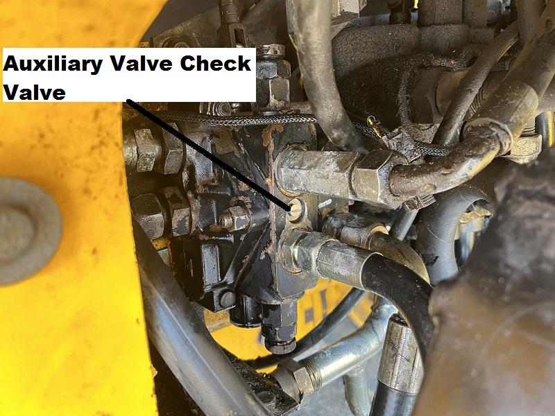

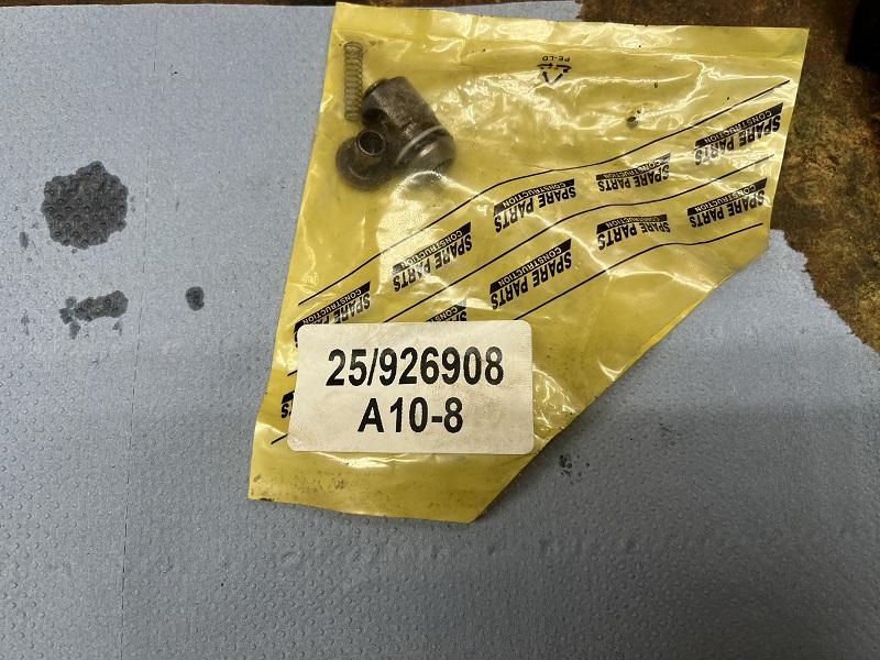

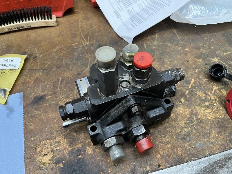

When I got this 3CX there was a slight leak from the 'Auxiliary Valve' - this is a foot operated valve that would operate a hydraulic breaker were one fitted, but on my machine operates the 'ExtraDig' dipper extension slide that gives an extra few feet of reach.
As I played with the machine the leak got a bit worse and I decided that it needed sorting.  It was a check valve that was leaking - a simple cylindrical body crossed drilled for one of the bolts that hold the slices of the valve together and thus retained in the valve. This body has an O ring and backing ring to seal to the body of the valve and has a spring and clack valve pressing onto a machined surface for it's check valve function.
Internal spare parts for this valve are 'no longer available' from JCB or the various parts dealers, however I was able to find a good secondhand valve which I got my hydraulic fitter Martin to put in, his flexibility being considerably greater than mine. It only needs a mechanical pedal linkage removing along with four hydraulic hoses and some mounting bolts - technically trivial but physically impeded by loads of other bits of JCB surrounding it!
Needless to say after a few months of operation the replacement started leaking in exactly the same way  :bang: I tolerated it until recently while ditching I burst a hose on the Extradig circuit and when replaced the valve leaked hugely. Probably the extra pressure pulse had destroyed the O ring seal.

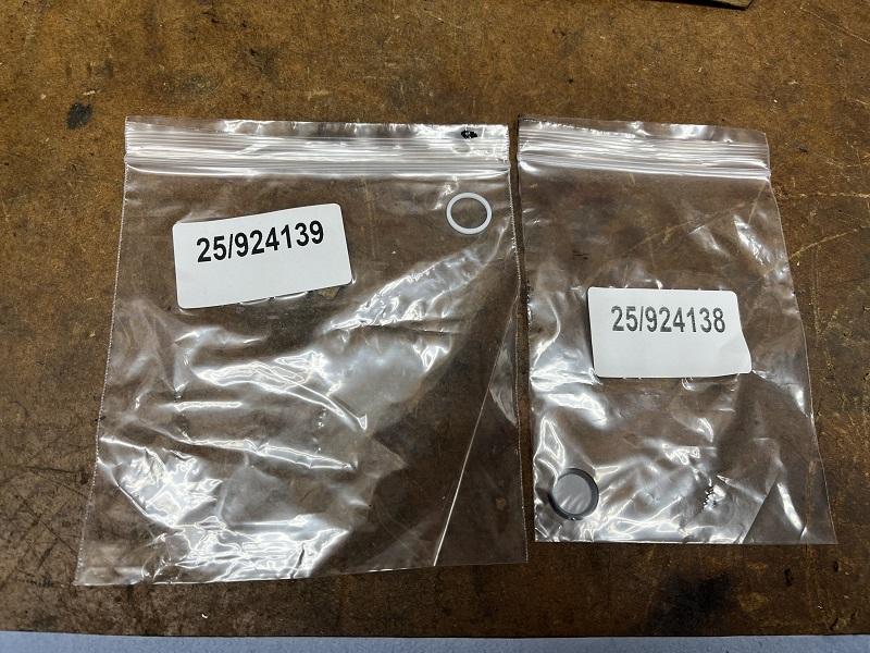

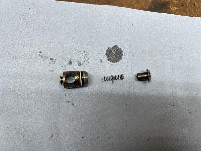

Well - this time I still had the original valve so could dismantle it to measure O rings, backing rings etc - slightly odd ball sizes but I am sure that I could have found them from the myriad of hydraulic suppliers that are on line.

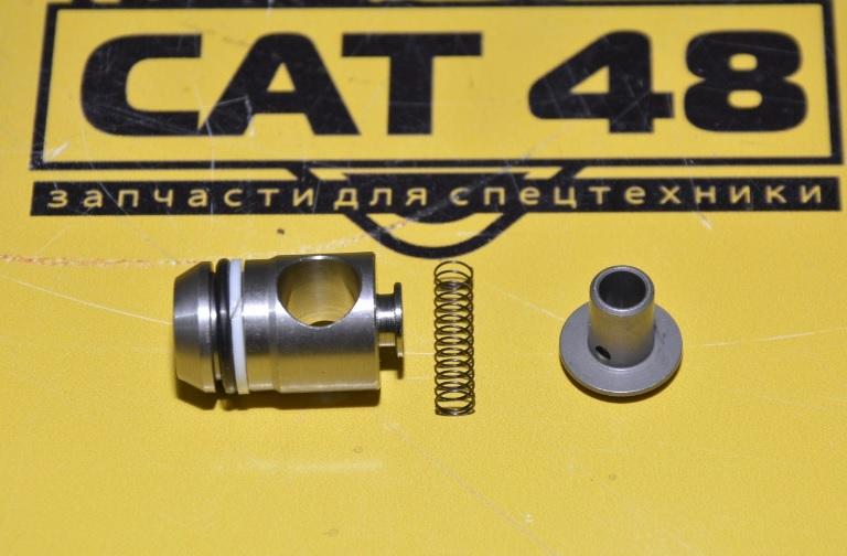

In an idle moment one evening I searched for 'Check Valve' on the official JCB parts portal and found all sorts of definitely different valve but one 'spares kit' that looker remarkably close to the one I'd dismantled. Listed as a spare for a totally different machine and NOT for a 3CX I got a spares dealer to measure the bits and guess what - the same size  :ddb:
Armed with the part number I was then able to identify the correct O ring and backing ring and ordered a complete 'spares kit' ie the whole check valve, and also spare O ring and backing washer. These arrived this morning allowing me to replace the complete check valve in situ on the machine and have bits to repair my original auxiliary valve as a 'shelf spare' for the future.
Although far easier than removing the auxiliary valve for bench repair replacing the check valve while on the machine wasn't the easiest task however it is done and works so far without any leaks ! I've still to repair the spare unit.

If I'd have known it was as simple as it is I'd have pulled the original auxiliary valve apart and even if I had to make the backing ring I'm sure the odd size O ring could have been sourced. That way I'd have saved a sizable chunk of hard won cash (the 'good used' item was £250 including VAT and carriage)
I've just rebuilt the original valve as a known good shelf spare - to my surprise I find the backing ring is actually split with a 45 degree overlapping cut making fitting to the valve body very easy. I'd expected to have to warm it in hot water, and indeed was advised to do this by the dealer, but that wasn't necessary.
The split  backing ring shows up on this image from a CAT dealer's parts site !
I enjoy much these stories.

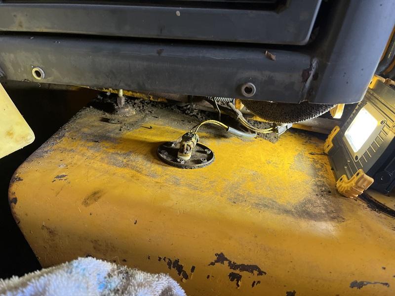

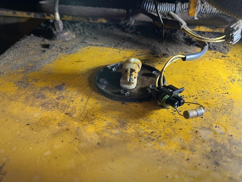

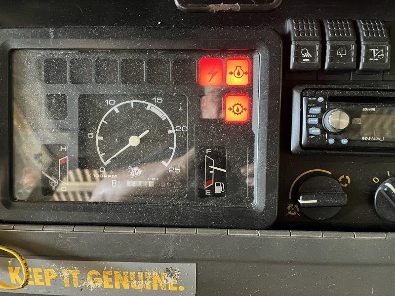

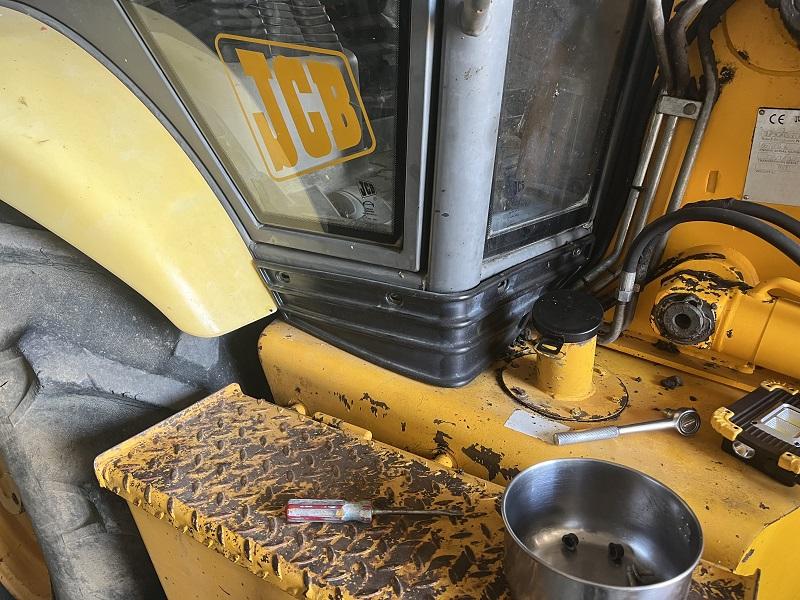

The fuel gauge stopped working the other day. Had been fine, then zilch, no deflection at all with a full tank.
Now diagnosis should be pretty simple if access was better. It can only be the gauge itself, a fuse, wiring or the sensor in the tank. Not a fuse as other things on the same feed are working. Access to the gauge is a right pain as it means removing the side console instrument cluster - took two days last time.
So how about the sensor in the tank? On my last 3CX the only way to get at it was to remove the tank, but on this somewhat later model I spotted a trim moulding on the off side cab edge that might just let me get at it.

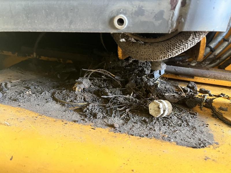

Sure enough only held on by some M6 bolts and removing it revealed an amazing build up of muck - anyone would think it's been used shifting loads of earth! Digging though the buildup with a scraper, and workshop vacuum cleaner eventually revealed the flange holding the sensor in the tank and it's two pin electrical connector. Carefully puling it apart and squirting it with contact fluid made not a jot of difference. Now these sensors, as far as I can tell, vary from about 24 ohms to 75 ohms empty to full.
I stuffed a 56 ohm resistor into the loom cable socket and lo and behold we have a 2/3rds full indication on the gauge - the fault IS te sensor - no having to dig into the side console again.
When I can get through to the parts place to confirm the part number I'll order one up, but so fr they're always on the phone  :bang:

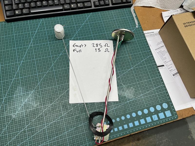

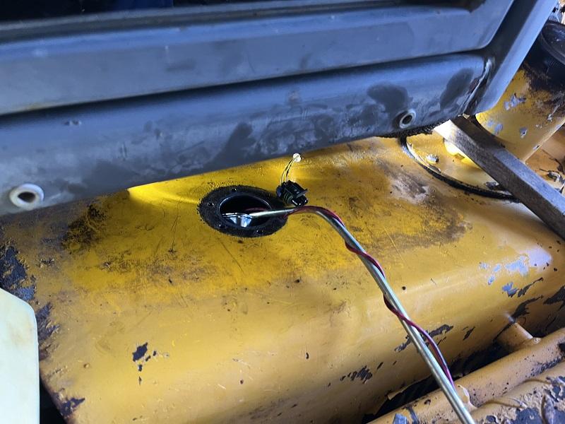

The replacement diesel level sensor arrived this morning, so first measure it's full and empty values:
Full = 13 ohms
Empty = 285 ohms.
Now to fit it. I had already pumped 20 litres out of the tank last night to avoid it flooding out when I removed the flange, and that black plastic trim bit was already off so it was 'just' a case of unbolting the six flange screws, lifting out the old and inserting the new.
Well of course it wasn't quite like that - as I had feared the long stem on the sensor clashed with the cab floor prevented it tilting enough for the variable resistor bit to come out through the hole. With rather more force than desirable eventually it came out by levering it with a screw driver and bending the case. Obviously the new one couldn't go back like that, and I wasn't going to drop the tank.
I ended up bending the long stem allowing the box of tricks to pass through the hole, then as far as I could bent it back in situ. If I ever have to do this again I will cut the stem and make up a coupler  collar with grub screws to put it back together.
What I've done obviously will change the calibration a bit but not too much I hope.

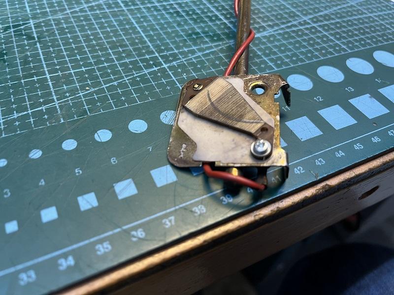

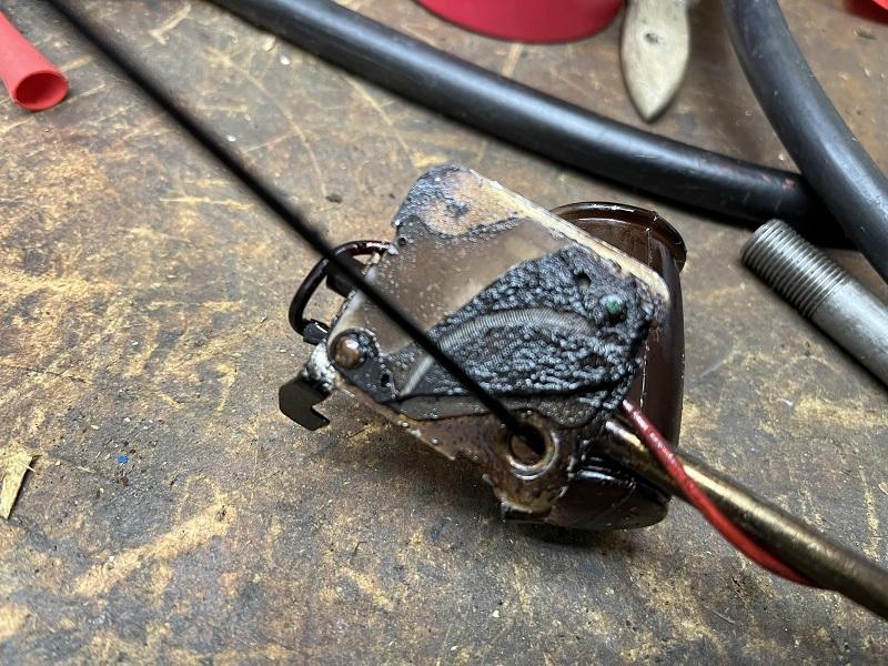

Then to dismantle the old one and find out what failed. It's resistance element is nichrome wire wrapped round a shaped former, with a springy contact finger rubbing up and down as the float angle changes. End to end the nichrome wire was OK giving sensible readings, but it's end termination had given up the ghost and was broken. Theoretically I could mend it but probably won't !
« Last Edit: June 20, 2022, 07:29:20 AM by awemawson »

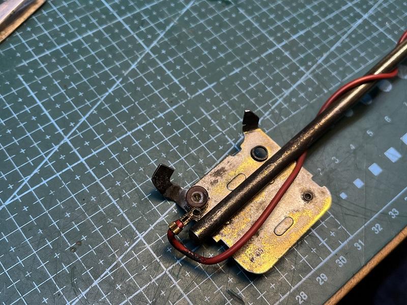

So not willing to chuck out a potentially repairable diesel level sensor I pulled it apart.
The break in the nichrome wire was very close to the riveted end connection - so after a bit of a clean up with brake cleaner I drilled out the riveted terminal connector, unravelled a bit of the resistance wire to give enough to wrap round the bolt that I replaced the rivet with, and screwed it all back together.
I bit of tin bashing on the box housing the resistance element to make it back to original shape (damage caused by me levering it out), and it looked almost presentable. Bending the wiper to give a bit better pressure I re-assembled it. bending it's fragile lugs back to retain the halves together.
A quick ohms test shows that it works - so it's been bagged up in the packaging of the replacement one and put on the shelf for next time.

That is some fine wire!
Oh yes Steve - I definitely needed my magnifying glass !
Offline WeldingRod
  • Posts: 401
And a fun coil to get a complex taper!
BTW, it's probably not nichrome. Probably manganin.

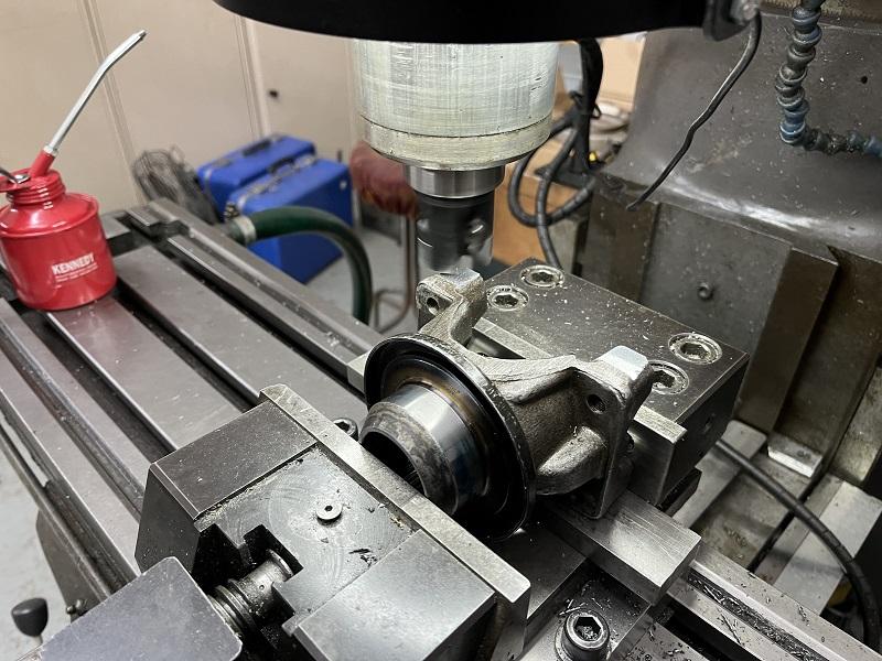

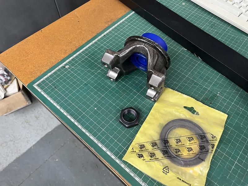

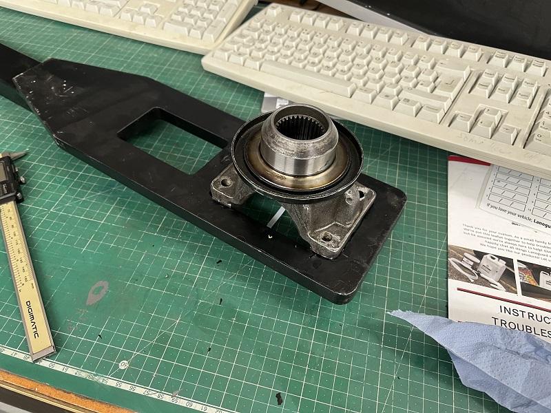

The 4 wheel drive output flange that carries the front prop shaft to the front axle differential has developed an oil leak. Entirely possible that this is my fault as I managed to over fill the synchro-shift gear box - and there are grave warnings about not doing this is the book of words - I suspect the excess pressure has reversed the lip seal lips.
Exactly the same construction as the pinion flange that I fixed in the front axle - there is a yoke that receives the UJ on the prop shaft, a special nut retaining the yoke which is torqued to a phenomenal torque, and a three lip seal that performs the actual sealing.
Having received the parts I thought I'd check if the yoke fits the special huge spanner that holds it still while doing up that nut, and sure enough, like the last one, the pattern part was too fat to fit the spanner, whereas the genuine part on the machine fits like a glove.
Last time I just trimmed it down with an angle grinder, but having prior warning I actually got to do some machining and reduced the width of the yoke by 4.25 mm on the Bridgeport. Much nicer than using the grinder!
So all ready to do the actual job but a few other jobs are ahead of it in the queue . . my bench is covered in a totally dismantled Stihl 023 chain saw waiting for crank shaft seals - then there's a friends generator to fix, and 18 stillages of logs to re-stack in the tractor shed - so probably a week or two before this gets done. But at least I'm prepared.

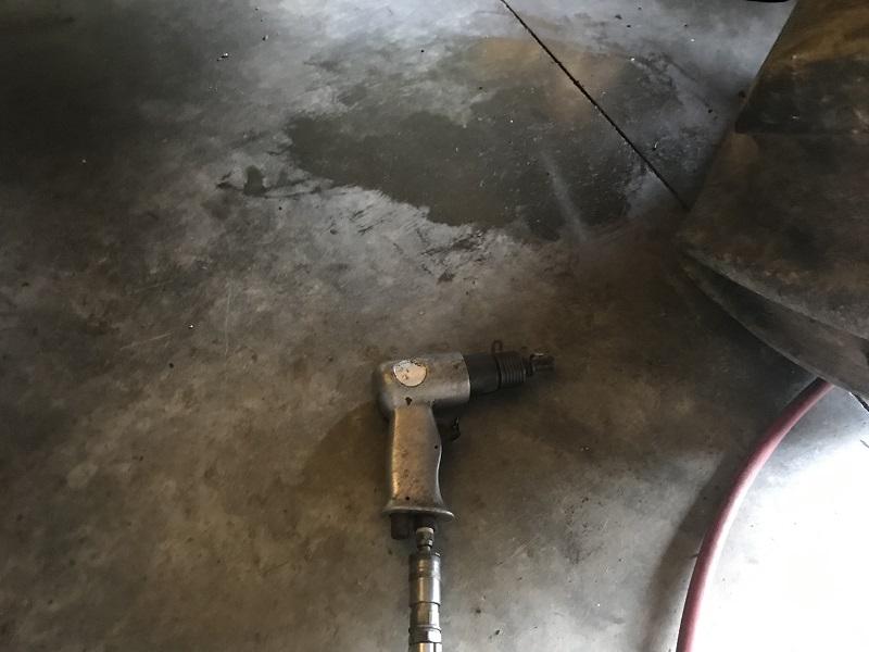

This afternoon I finally got round to changing the front output shaft seal. I'll be honest, I've been putting this off. Not over keen on rolling about on a concrete floor.
It was basically a repeat of doing the front axle pinion seal with the same issues that I had there - old seal reluctant to come out, universal joint needle rollers happy to discharge themselves all over the place but I got there in the end.
First thing to do was to drain the old transmission fluid, and the book method is to remove the gauze strainer bolted on sideways on the side of the assembly - worryingly the bolts were barely finger tight but the good news was that the cork gasket was in good condition as I'd overlooked buying a new one. Gauze was clean as a whistle but I blew it out anyway with an air line.
Without working over a pit it was actually impossible to use the big special spanner to hold the yoke still while unscrewing it's big retaining nut as the spanner clashed with other bits of JCB - probably OK if the gear box was on the bench but not in situ.
However my Milwaukee M18 1/2" impact driver unscrewed it reasonably happily so it wasn't a problem .
So job all done time to change the filter which according to the hand written date on it was last changed in 2002.  :bugeye: In a bit of an awkward position but amazingly I was able to unscrew it by hand. New filter duly marked up with today's date and screwed home having oiled its rubber sealing ring.
According to the book this transmission takes 14 litres - so I put in 12 and dipped it. Bally thing was over filled. I ran the engine briefly to fill the filter but no still too full  :bang:
So crawling back under again (repeatedly!) I loosened the strainer and must have drained off at least another litre before the dip stick was happy. As over filling was I think partially the cause of the seal failing it was important to get it right.
A big clear up of tools and a floor sweep and horror of horrors I found an oil seal reinforcing tubular spring of the sort that biases the seal lips onto the shaft - sinking feeling - would need a total repeat operation to refit the spring  :bang:
However all was well - inspecting the seal that I had removed it's spring was missing - phew  :clap:
So time to try it - a quick trip round the field in both two and four wheel drive - all seems to work - (but of course this yoke / prop shaft is rotated by the front axle in two wheel drive any way)
Left standing a couple of hours while I had a shower and supper (a nice gammon rasher  :thumbup:) and so far no more pools of oils.
. . . so hopefully that's another job jobbed
Sorry no picture - I was too oily !
