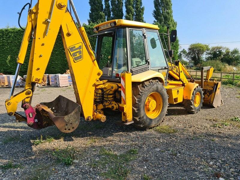

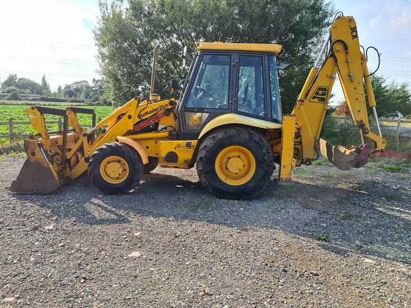

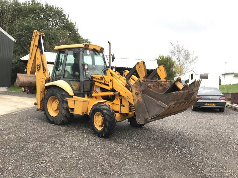

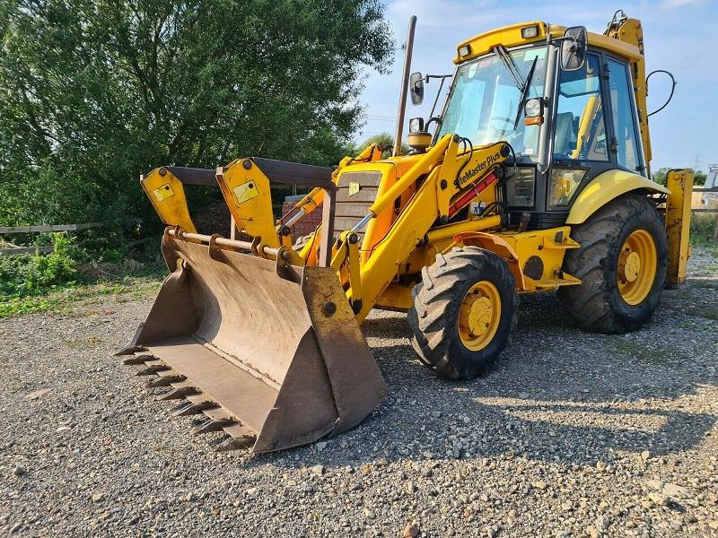

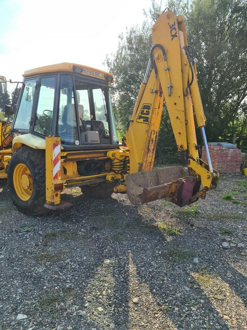

A long trip today Sussex to Norfolk, Lincolnshire, / Cambridgeshire borders to kick the tyres of a JCB 3CX Project 8 1995/6 back hoe excavator. Lots of driving but worth it I think as this seems so far to be a pretty good specimen for it's age.
I've been looking for a few weeks and seen some absolute dogs so it was a relief to find this one that lived up to it's description and photos.

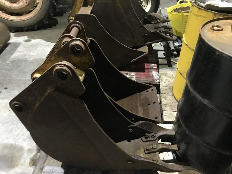

It comes with a ditching bucket, four digging buckets and a 'quick hitch' which is a 'good thing' as those six items would be about £2K to buy at the moment!
No doubt there will be many little things to sort out - inevitably there always are - but the first thing to sort out is moving all eight tons of it the 170 miles home  :bugeye:

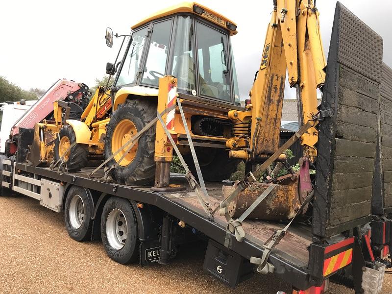

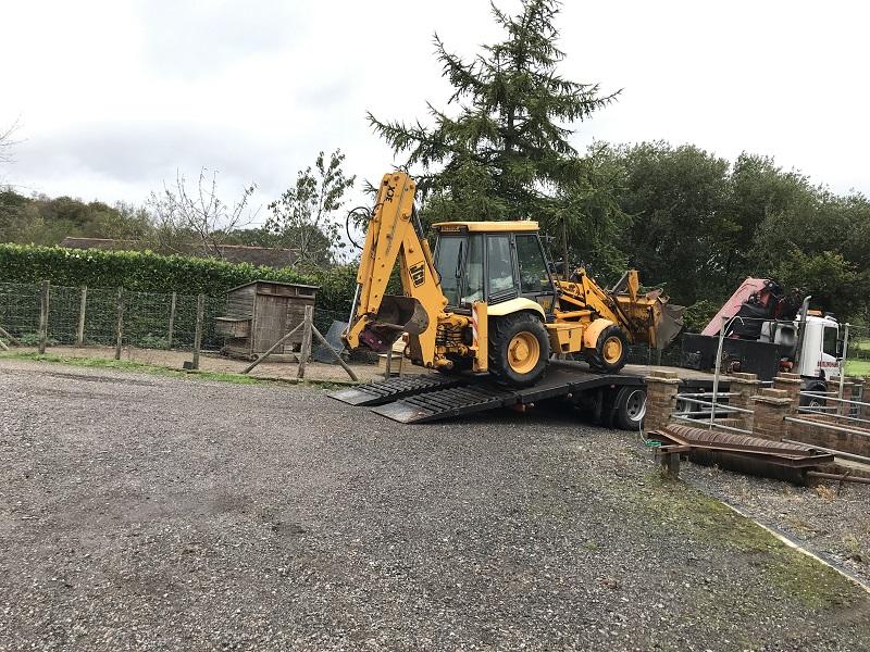

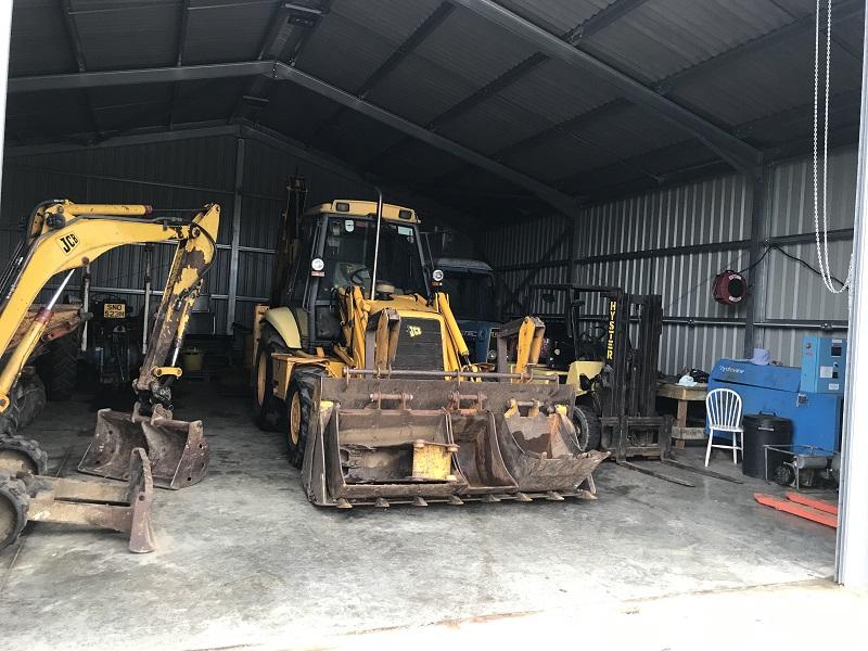

Well guess what turned up today  :clap: :clap: :clap:

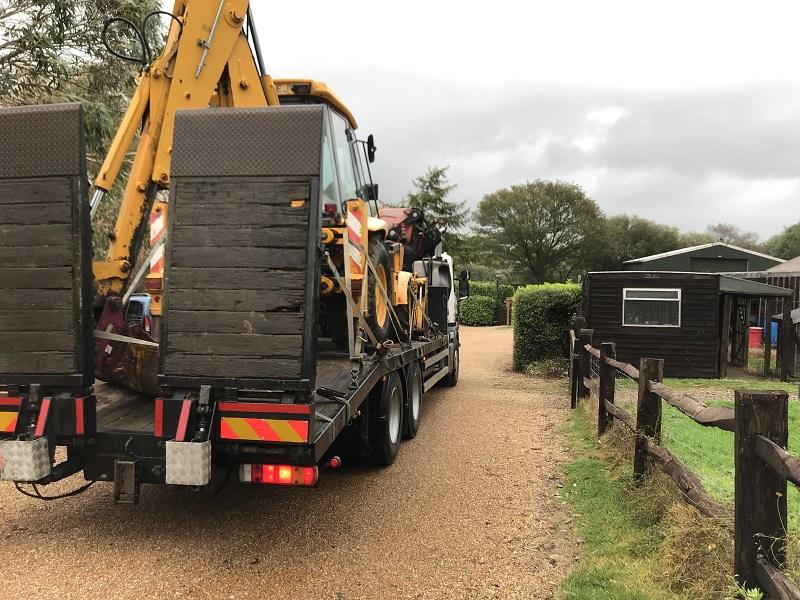

Various things have conspired to delay the delivery of my new toy. I had made contact with a transport firm that was only 1.5 miles from where the 3CX was lying,and arranged a reasonable price for delivery. The father of the chap I bought it from was supposed to drive it the short distance to the transport yard and it would go at the next opportunity which was to have been last week - that all fell through when he ended up in hospital  :bang:
The seller drove it to the transporters yard who kindly sent me photographs of it safely in his compound to await the next opportunity which turned out to be this morning.
On a beavertail lorry it safely got under the multiple telephone lines and 415 volt 3 phase lines that cross my drive (phew!) into the farm yard where the very nice driver (who was actually the owner of the company) unloaded it and put it my Tractor Shed. Oh good - it does actually fit  :thumbup:
Now I have decided to let the excitement calm down and NOT drive it for a bit - you can do a LOT of damage in a short period! I even got the delivery driver (who co-incidentally has owned one in the past) to park it up for me in the Tractor Shed.
. . . evaluation phase starts now !

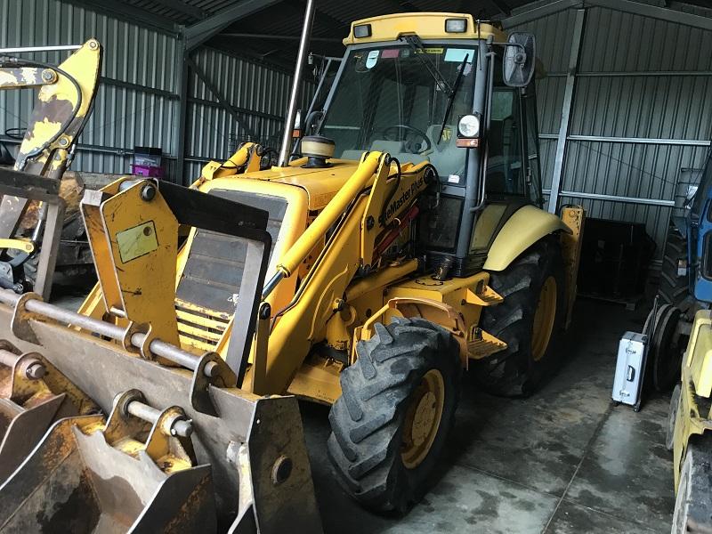

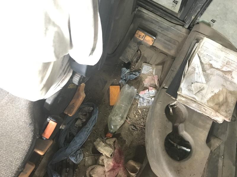

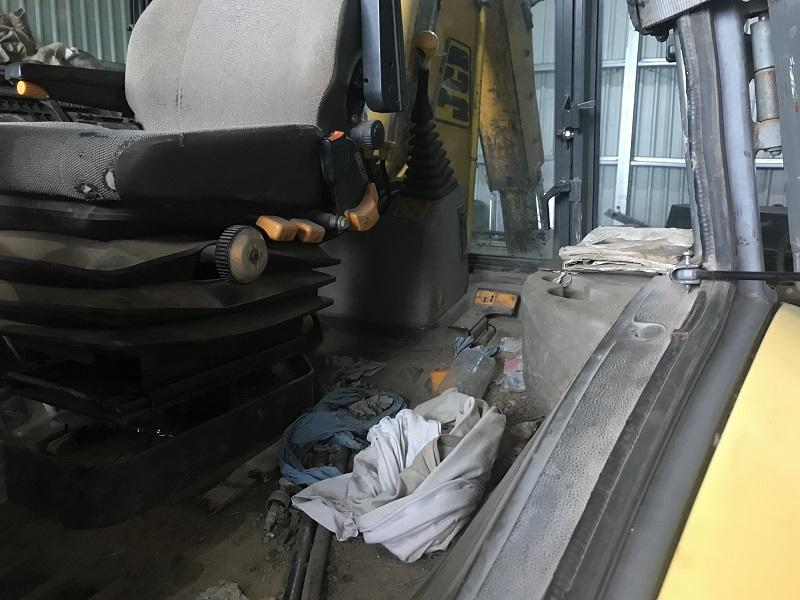

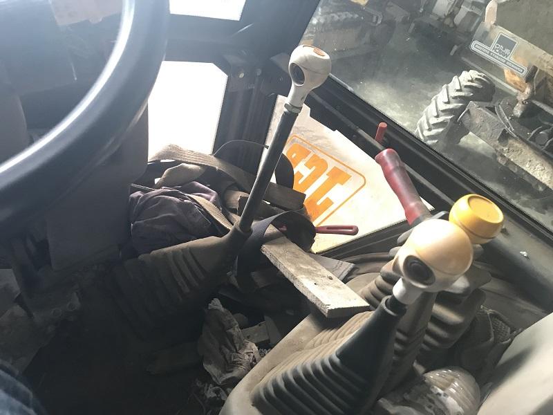

Now the cab is absolutely full of junk - old bits of rag, drinks cans, grease tubes mud - you name it. When I can face it I need to take several black bin bags full of grot out, and vac and sweep it out to see what remains.
Things that I KNOW are needed:

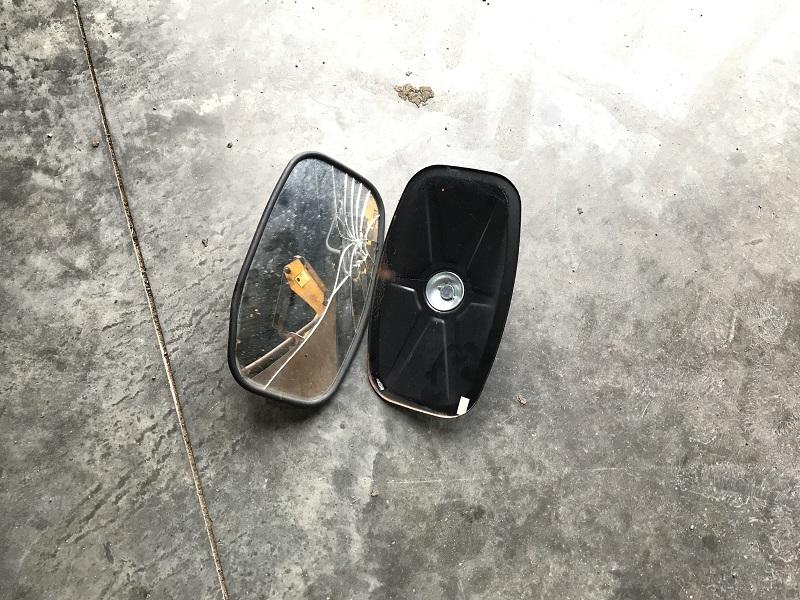

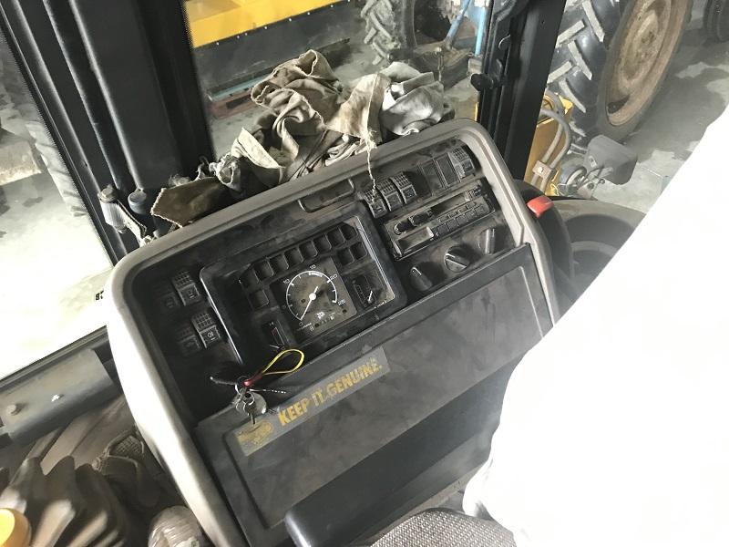

Glass for instrument cluster (declared broken by seller so no surprise)
Two rear view mirror glasses - simple plain mirror no heaters!
A plastic 'stone guard' that fits behind the rear chassis frame (plain flat plastic 3 mm sheet easy to make)
Then I need to give it a good service. A full filter kit covering engine oil, gearbox oil, hydraulic oil and air cleaners plus diesel filters.
Then a good greasing - I already have in stock about a dozen genuine JCB 400 ml tubes of grease - it looks like I'll need quite a bit - there are 70 (yes 70!) grease nipple on this machine  :bugeye:

Well you would think with a purchase of that magnitude they would have given it a bit of a pressure wash and valet!! Never mind Andrew, it will be easily done and very rewarding. I am jealous! Looking forward to see some digging videos!
Private sale Phil. Actually I'm happy it's not been 'prepared for sale' as you see it warts and all - there seems to have been no attempt to cover anything up.

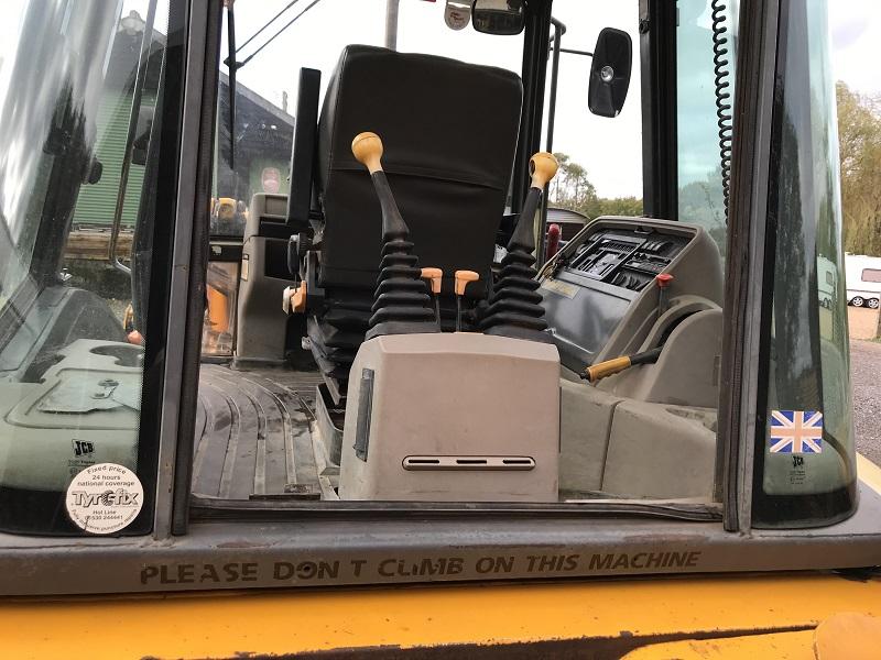

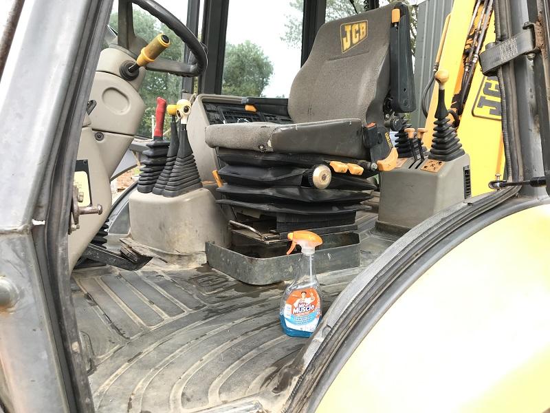

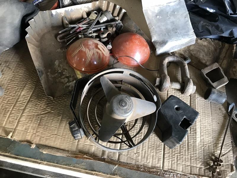

So I ventured out armed with a big workshop vac, a dustbin, and a dust pan and brush and made all sorts of discoveries having fully filled one dustbin:
A/ Various missing retainers and covers.
B/ The 'optional' cab fan that fixes on an arm
C/ A very worn and tired copy of the operators manual

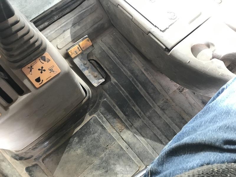

D/ And biggest surprise of all - THERE IS a FLOOR  :clap:

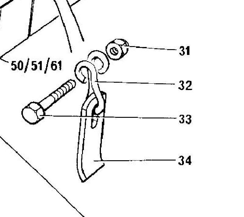

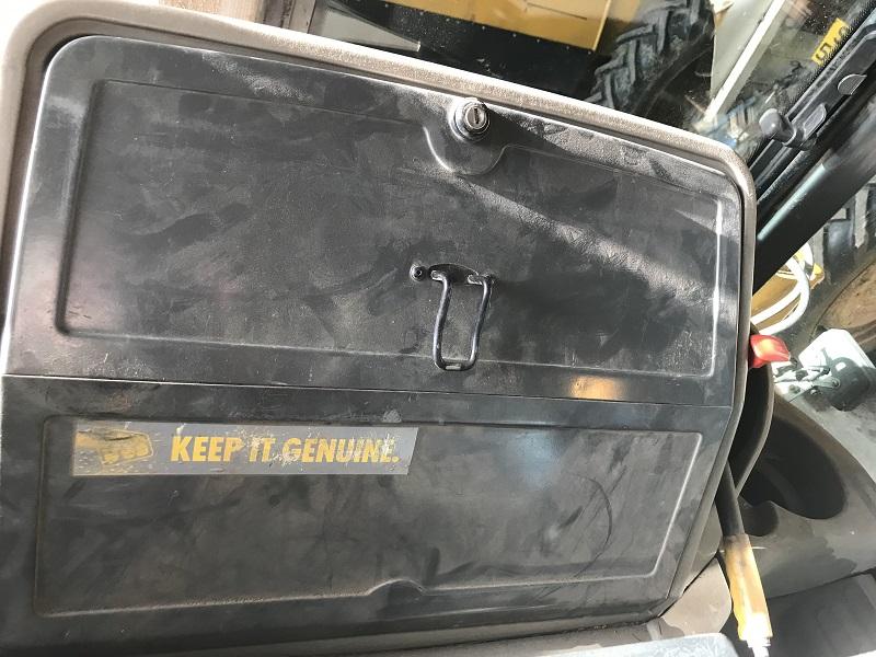

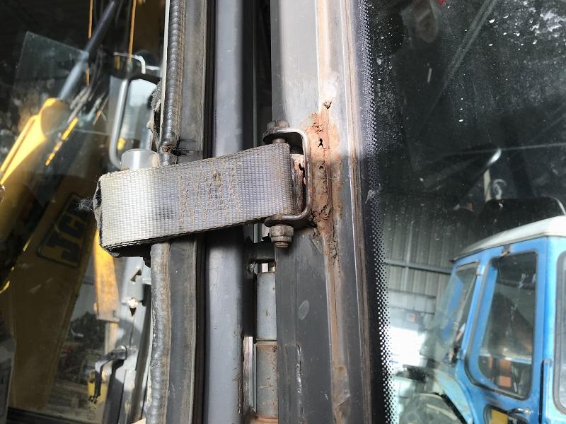

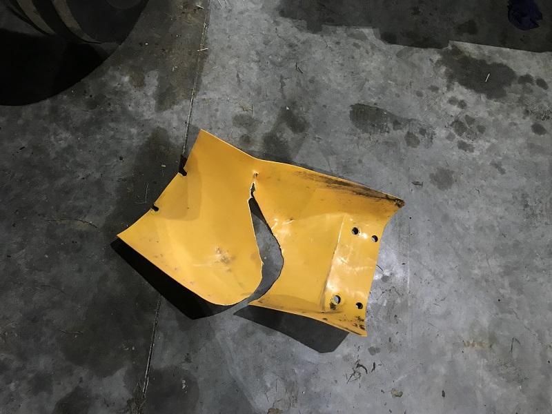

All seems to be in pretty good order - the only dodgy thing I've found so far is that the bracket that holds the door opening limit strap on has been torn off at some time and rather badly welded back. At first I thought that it was tin worm, but no just grotty welding. Close to the (bonded in) glass so not ever so easy to fix.
One discovery is that there is a fold out / fold down anti vandal cover that locks in place over the instrument console - oh and shards of glass from the original glass showing that it was 1.75 mm thick but I think I'll probably put poly-carbonate back.
This mornings task was to drive the 3CX into the farm yard, open all the windows and doors, and give it a good blow out with an air line in all the nooks and crannies. Still amazing amounts came out despite yesterdays intensive hoovering and sweeping.
After another sweep out and hoovering, I followed up with a 'wet cloth swabbing down' which at least now lets me read all the various legends on controls. A good clean up like this i find is the best way to find the true state of new toys as you are forced to look at every detail.
Fortunately no horrors revealed and in fact it's confirmed that ALL the rubber gaiters for the controls are intact and in good condition. Quite surprising for a 25 year old machine.

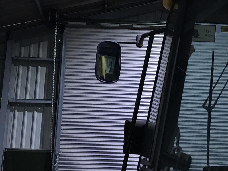

Reversing blind back into the Tractor Shed I took extremely carefully, as both rear view wing mirrors are broken, neither were originals by the look of it, and no doubt are a pretty expendable item when working on site! Two genuine one ordered.

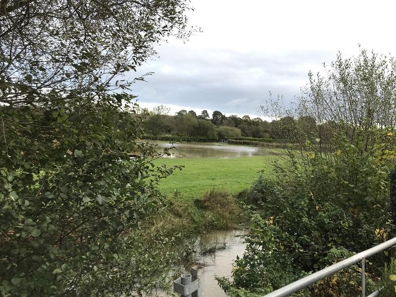

It looks like my hope that I could get a few days in this year ditching has been dashed. Last night the River Brede over topped it's banks and we are flooded, so the ground will stay too soft for quite a time.

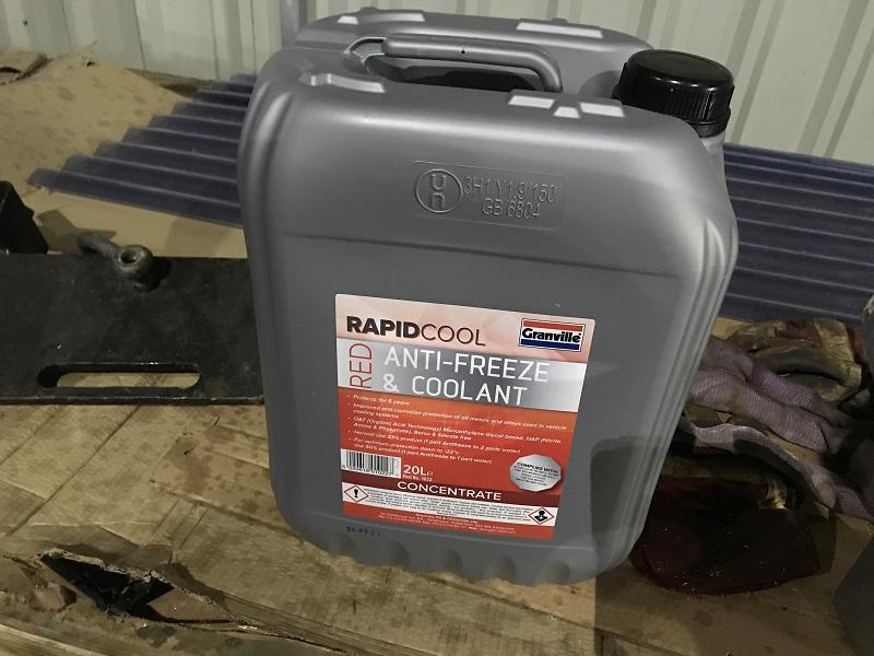

Things are beginning to happen, and bits arrive. I've decided to give the 3CX a full service, including changing all the antifreeze. No idea what is in it, the coolant level is low so the lot is coming out, a quick flush, and new at 50% dilution going in.
So today the new coolant arrived - 25 litres of concentrate as I need 20 litres (at least) of diluted. Also the replacement rear view mirrors arrived, so backing into the Tractor Shed should be less hazardous!

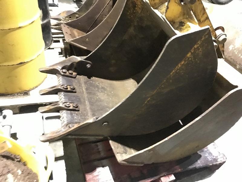

First thing this morning I unloaded the four digging buckets from the front shovel and palletised them for easier movement and storage - pleased to find that they are genuine JCB ones. This will allow me to more safely prop the front arms 'up high' to allow access to the engine.
We had a heavy  frost the other morning and it  resulted in the death of the battery - it soon recovers after a few minutes charging but time for a new one as these things have to be reliable - replacement due to be delivered tomorrow.
I've ordered a full set of engine oil, transmission oil, hydraulic oil, fuel, and air filters along with a new sight glass for the hydraulic tank, new glass for the instrument panel, and breather filter for the hydraulic tank - this lot should arrive towards the end of this week.

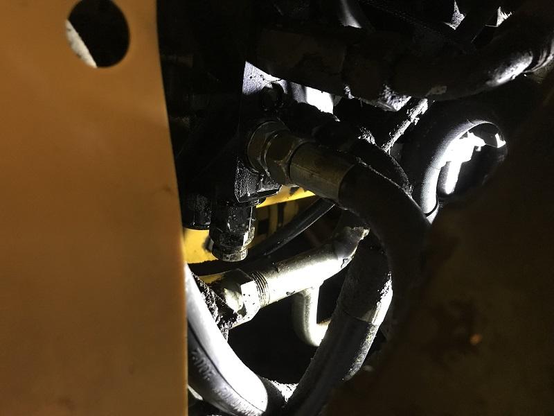

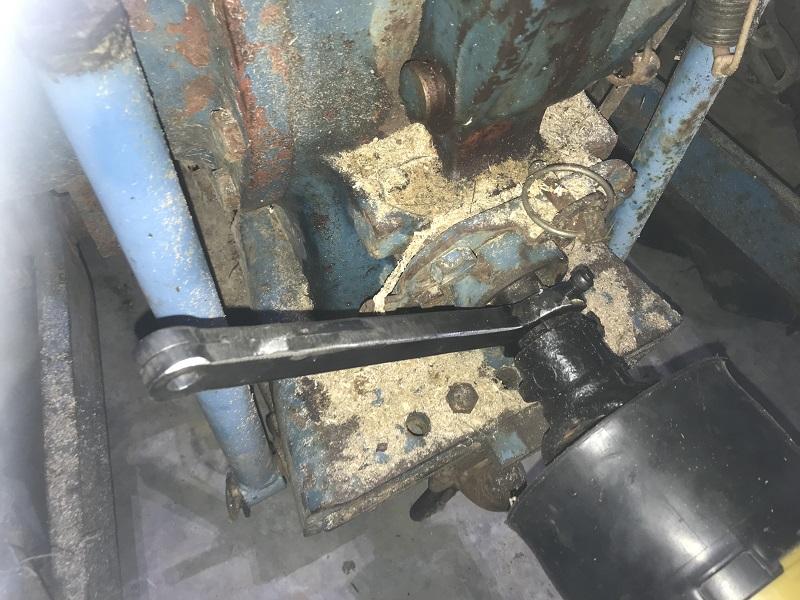

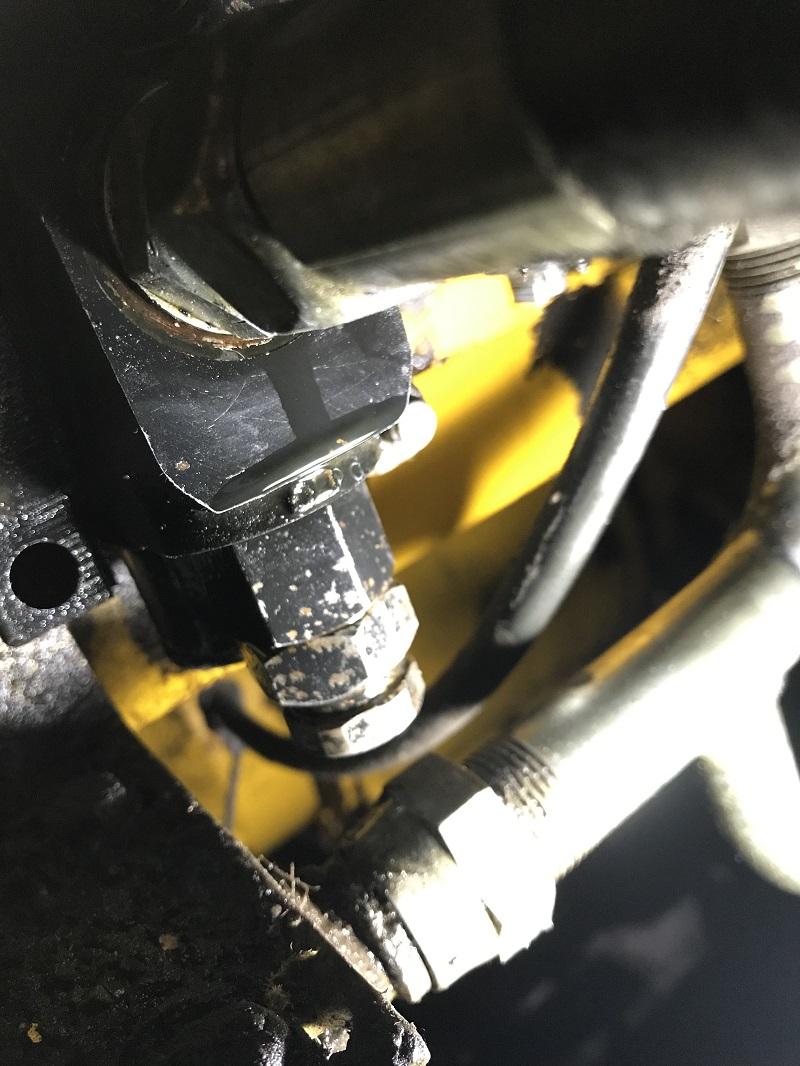

Meanwhile I've been tracking down a minor hydraulic leak from the back end - only slight but needs attending to. It's a bonded washer joint to a hydraulic fitting - it's as tight as I can get it so at some time I'll have to remove and replace it - fairly sure I've the correct size in stock.
To more easily get at it I fully removed the remains of the PVC 'stone guard' that protects the hoses from muck chucked up by the rear wheels - it's badly broken - there's a left and right side version - can't see the rhs one as it's behind the carriage which is currently slid to the right, but it's probably in much the same state. £150 each from JCB or £17 each (in black) as a pattern part !
Still can't find why the interior cab light and radio aren't powering up - fuses are OK so a bit of tracing called for.

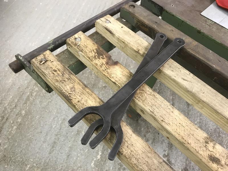

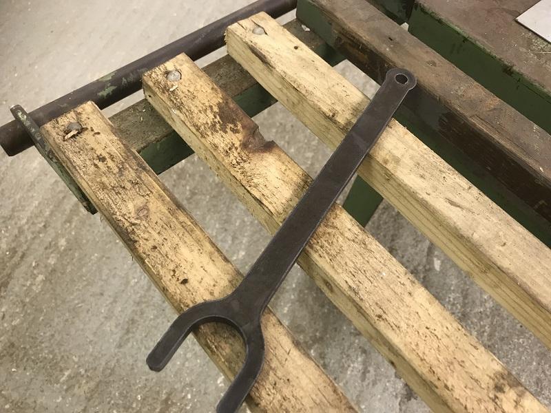

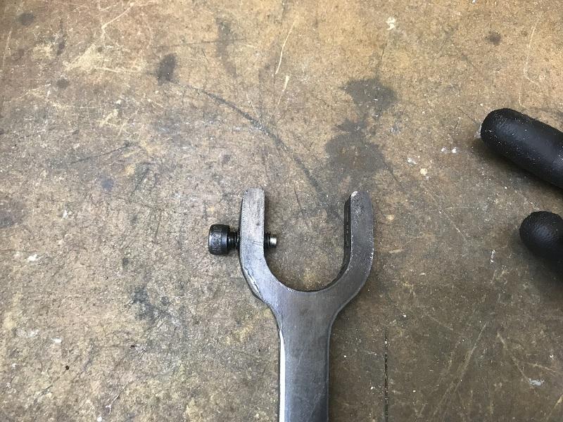

On the subject of fuses I find these modern car fuses with the two flat blades confoundedly hard to pull out and re-insert - can't see what your doing and fingers are in the way anyway. Particularly troublesome as the Project 8 fuse board is to the right hand side of the drivers seat and only about 6" away so no room anyway. I think I'm going to bend up some sort of clip to grip the fuses for removal and insertion !
« Last Edit: October 26, 2021, 10:27:50 AM by awemawson »
I bet you could find a fuse puller on thingiverse. I might have one somewhere you often find them supplied in car/van fuse boxes.
Hi there, Andrew,
You referred to a 'bonded washer'.  I take it that's the generic name for what I was introduced to as a 'Dowty Seal'?
Are they a multi-manufacturer item?  Are Dowty still in business?
PeteW - yes Bonded Washer = Dowty Seal
Pete. - turns out eBay abounds with fuse pullers so order placed ! Johnny Bravo popped over to pick up some electrolytic capacitors and pointed this out to me .

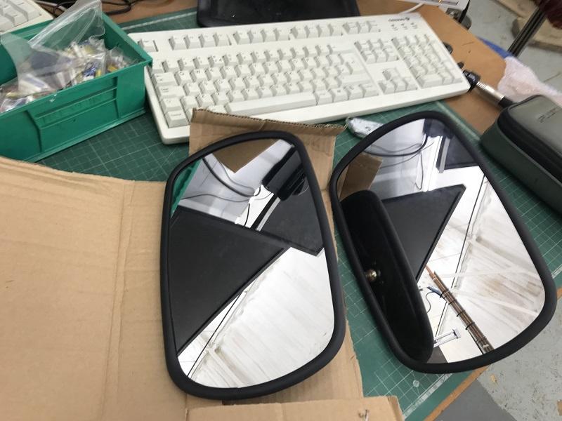

Only a little thing this morning, but at least it's ticked off the list: Replace the broken rear view mirrors. I had a few moments waiting for someone to shift some of the 'stuff' he's storing here so grabbed the opportunity !
