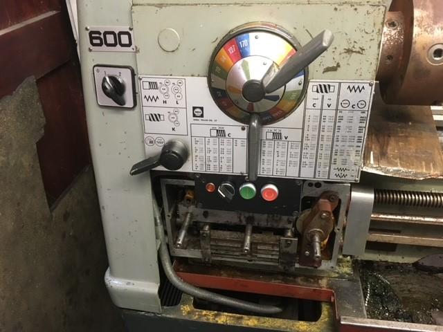

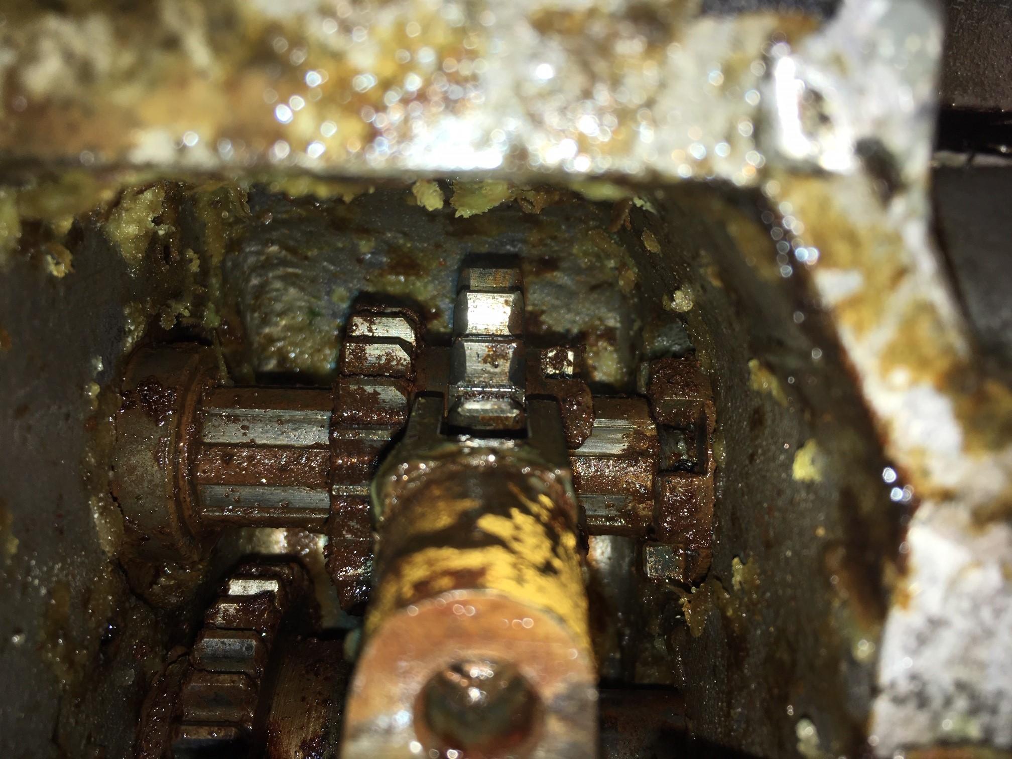

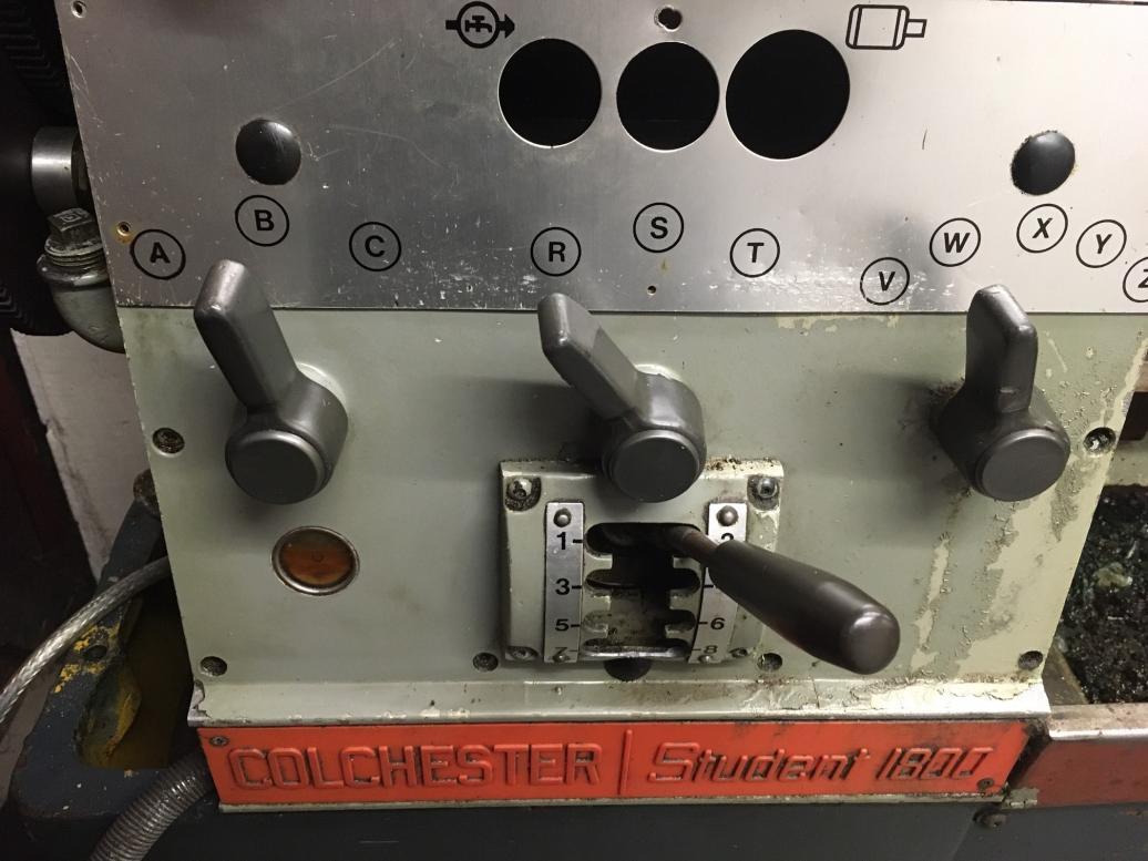

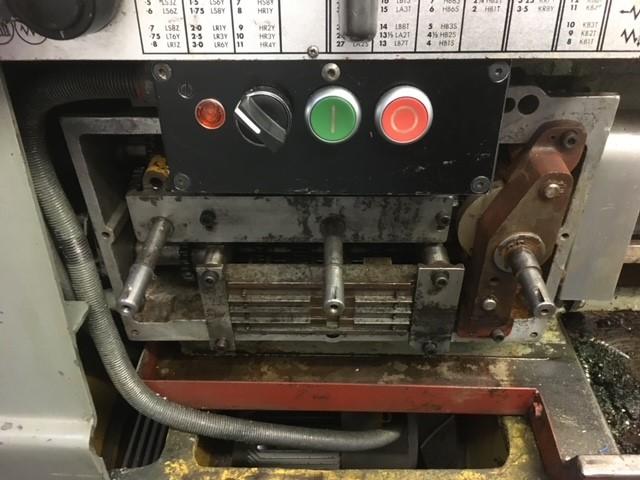

I've been working on my "new" lathe.
It's a Colchester student 1800.

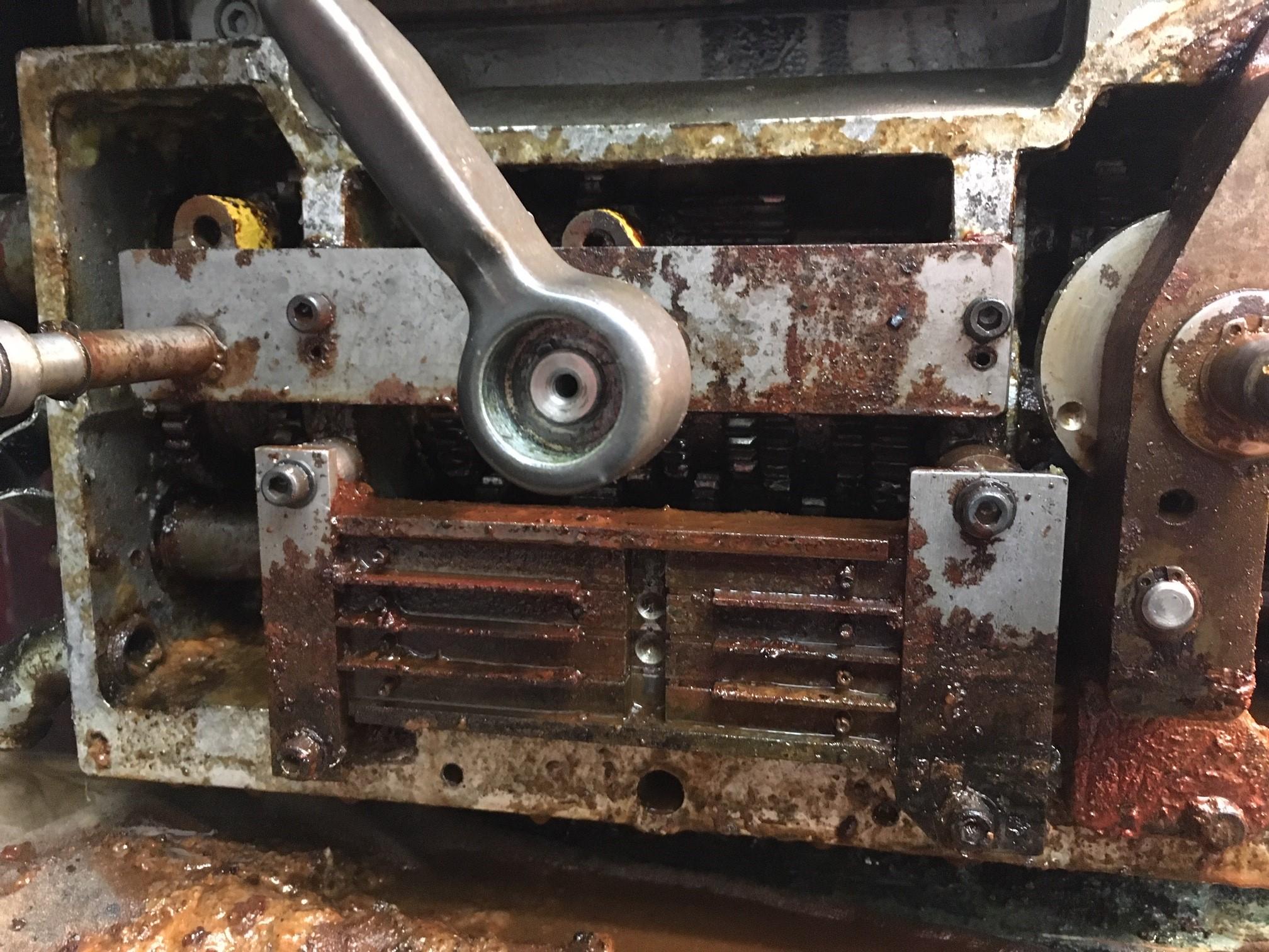

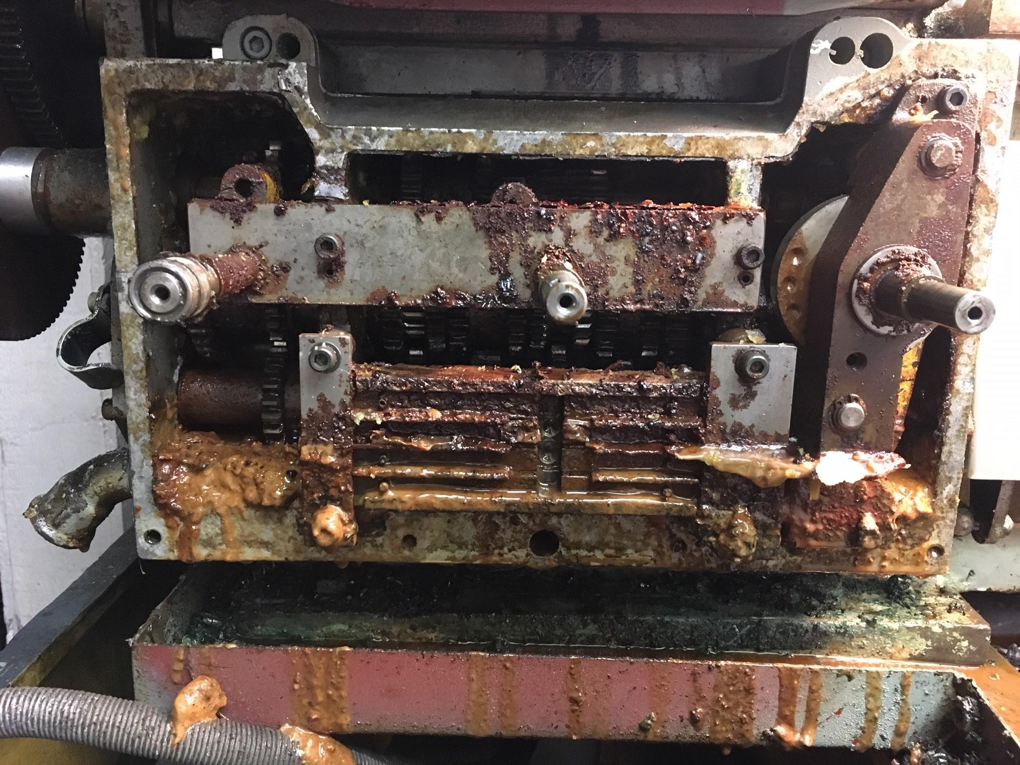

The front levers were all jammed up, so I dismantled it all, and found rusty porridge inside the gearbox! It's all cleaned up and free now though.

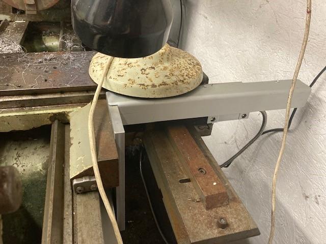

I've fitted it with a 240v 1ph motor, and also a 2 axis DRO.

Yuck!  Oily porridge, one might hope?

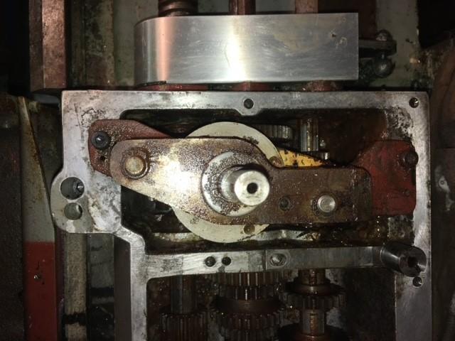

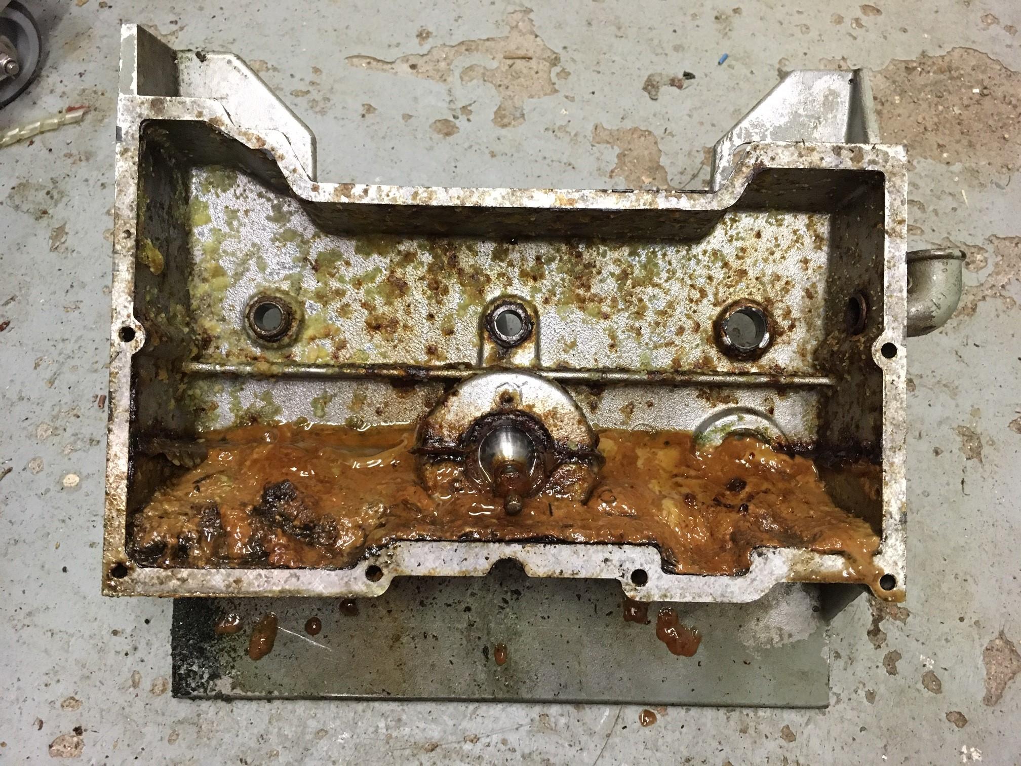

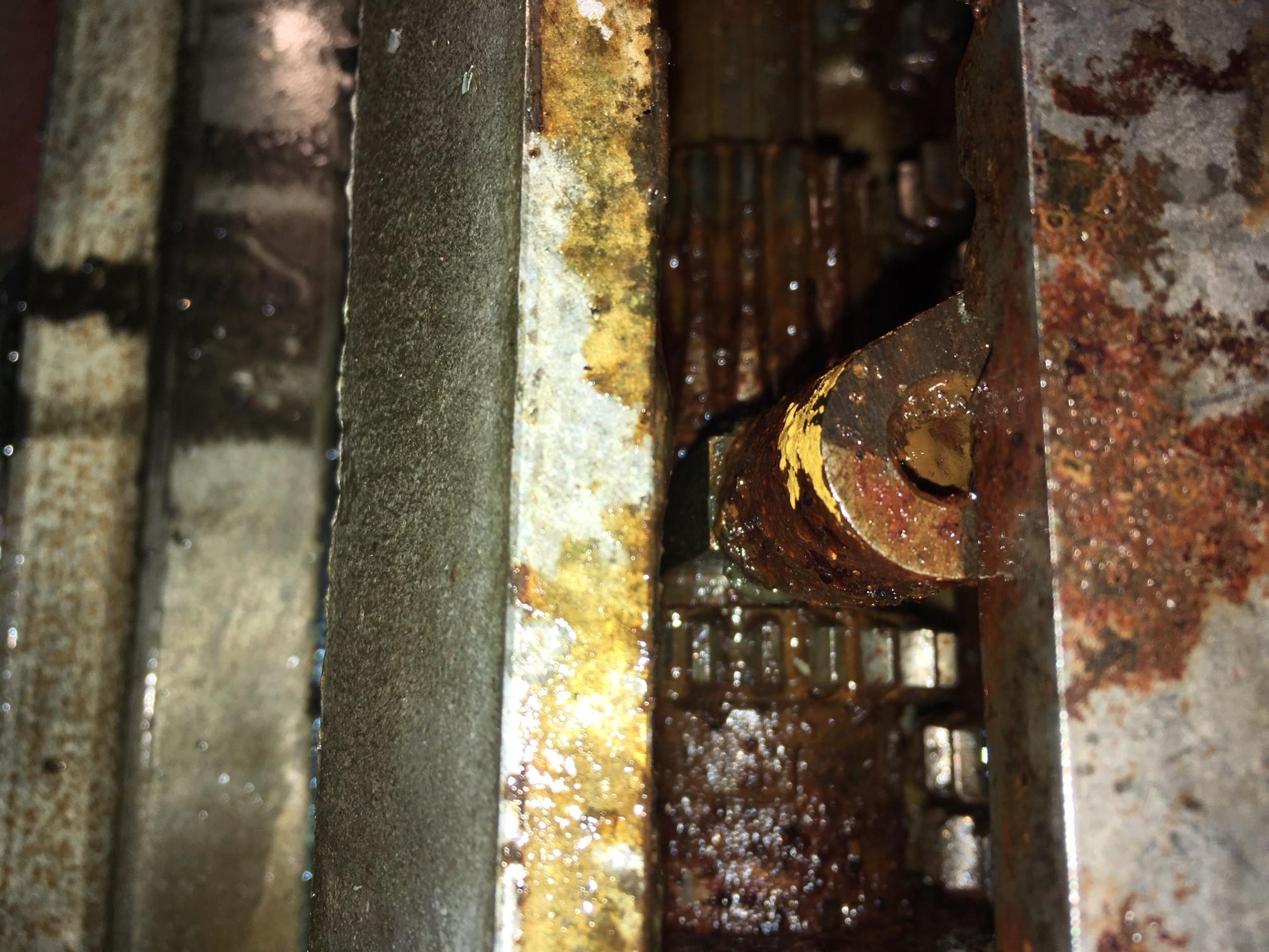

... well, it may have started life as oil, it's hard to tell!

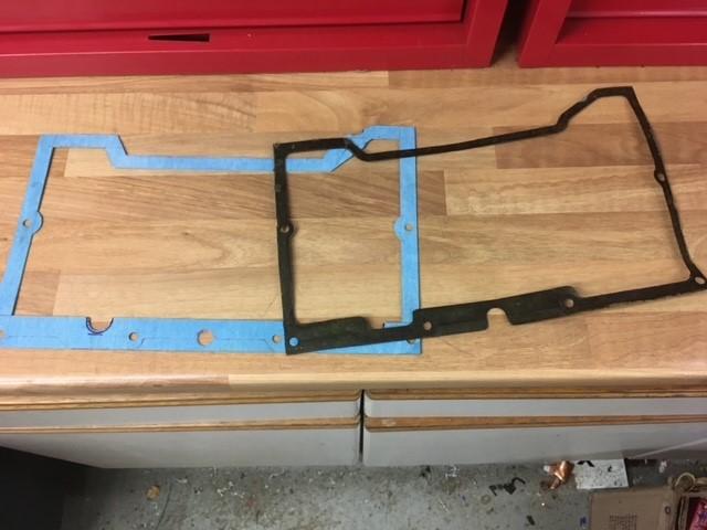

Took a long time to clean all the parts, but now it's all reassembled, new gasket, new sight glass etc and fresh oil.

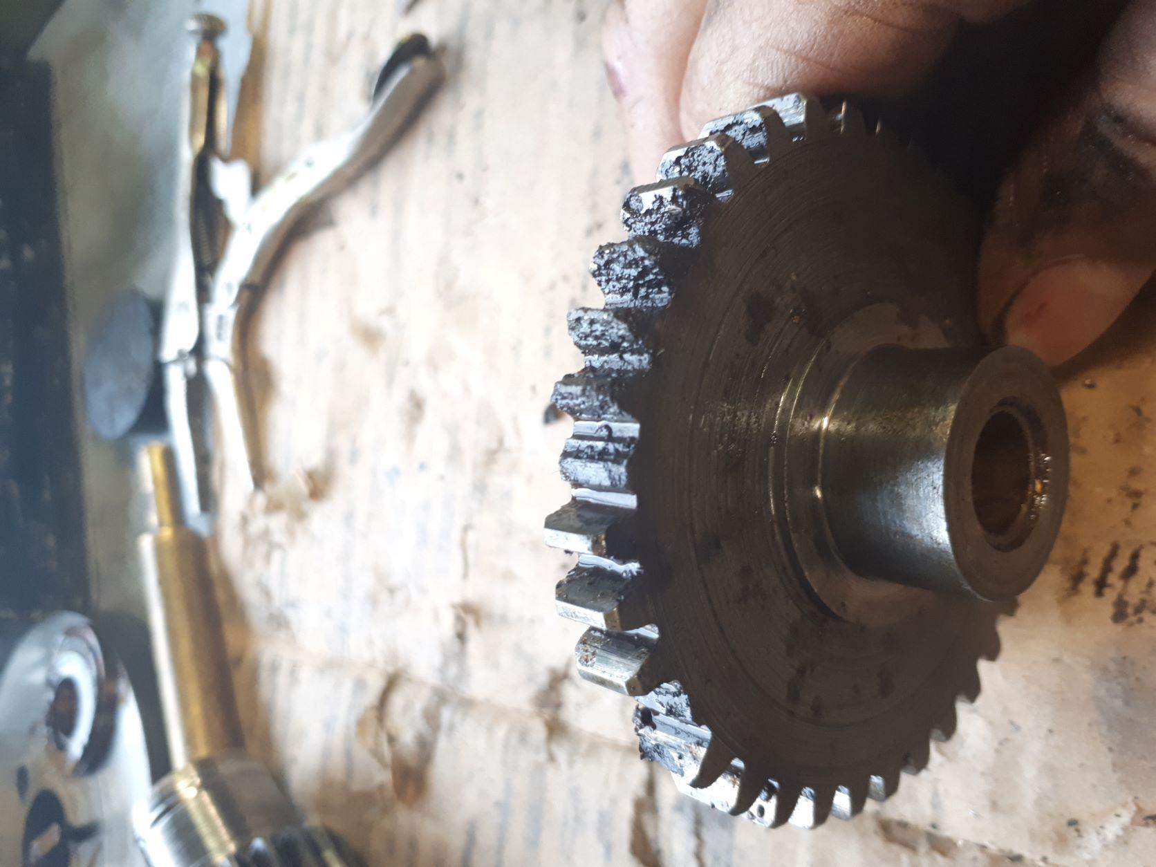

Head stock is "full" of good clean oil, but will be draining and replacing for good measure. Besides, there is a knock on one of the gears, so I need to fix that anyway.

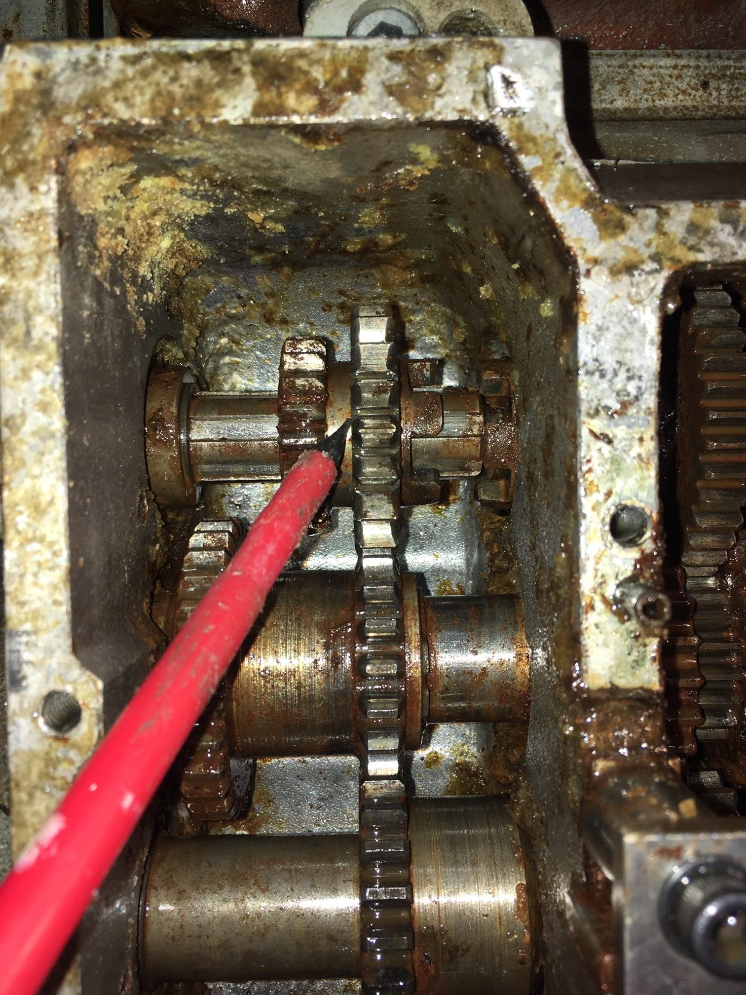

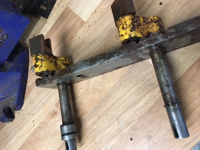

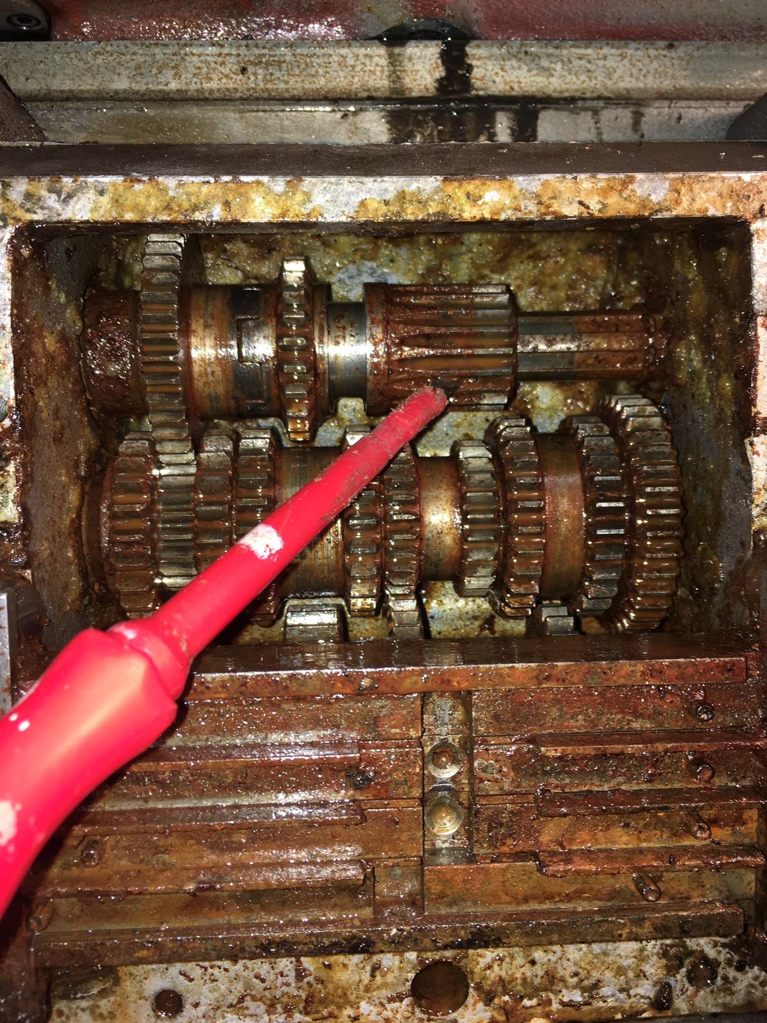

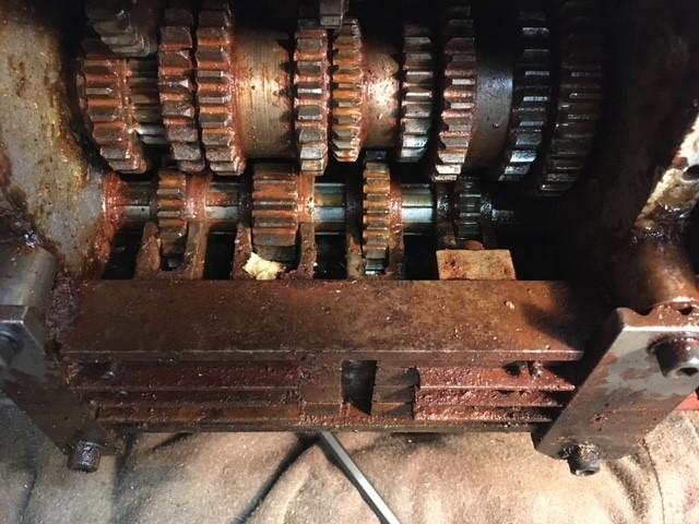

« Reply #3 on: September 08, 2021, 01:00:30 AM »
More  nasty gearbox internals...

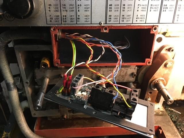

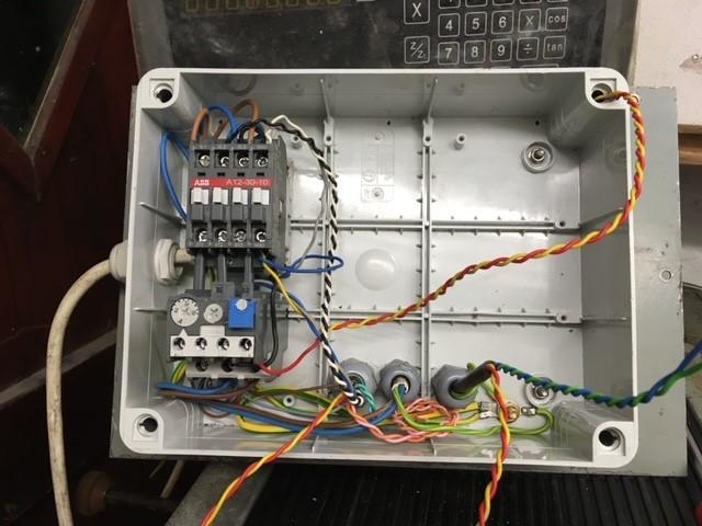

240v electrics conversion.
I left/abandoned all the original 415v wiring and contactors etc, in place. I then added a new box on the back with the wiring/contactors etc - it's easily accessible, and the machine could easily be put back to 415v in the future etc.

Offline cozy
  • Posts: 23
Re: Colchester student 1800

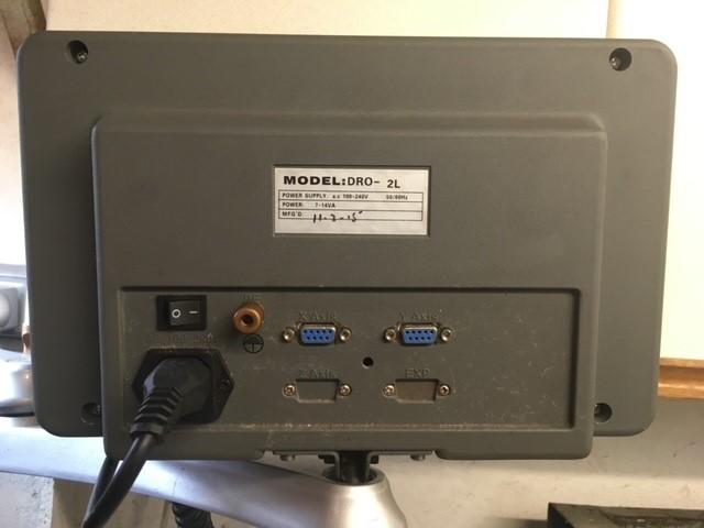

« Reply #5 on: September 08, 2021, 01:09:13 AM »

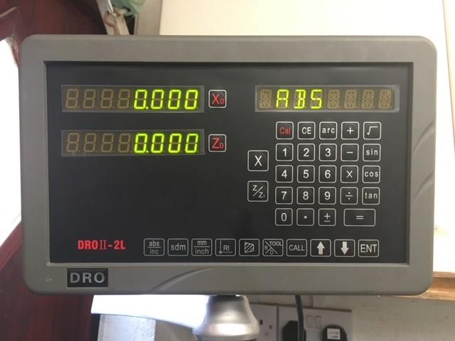

Nice 2 axis DRO. I have the same type 3 axis on my mill, and it has worked faultlessly for last 10 years.

Hi Cozy,
You had better get prepared to face the same mess in the carriage gearbox   :bang:
Coolant gets into the gearboxes easily on these lathes and displaces the oil
This caused a lot of damage on my larger model Triumph 2000  :(
I have been meaning to post a thread on the rebuild, Is there any interest in a thread on this?
