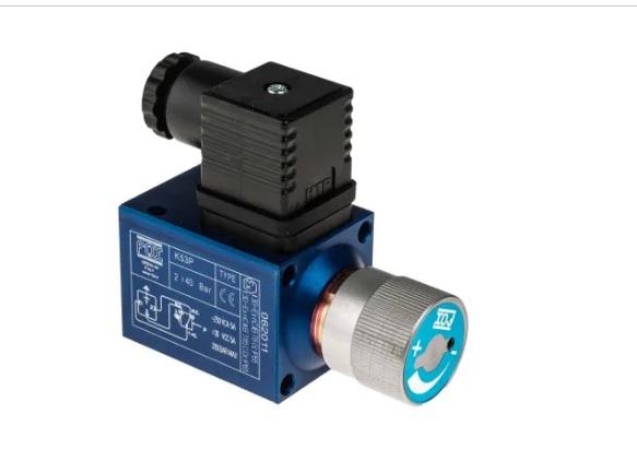

OK simple enough, the switches are in a very inaccessible position but they are after all just adjustable switches rated at 2-40 Bar with a single change over contact. Test them !

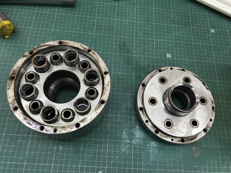

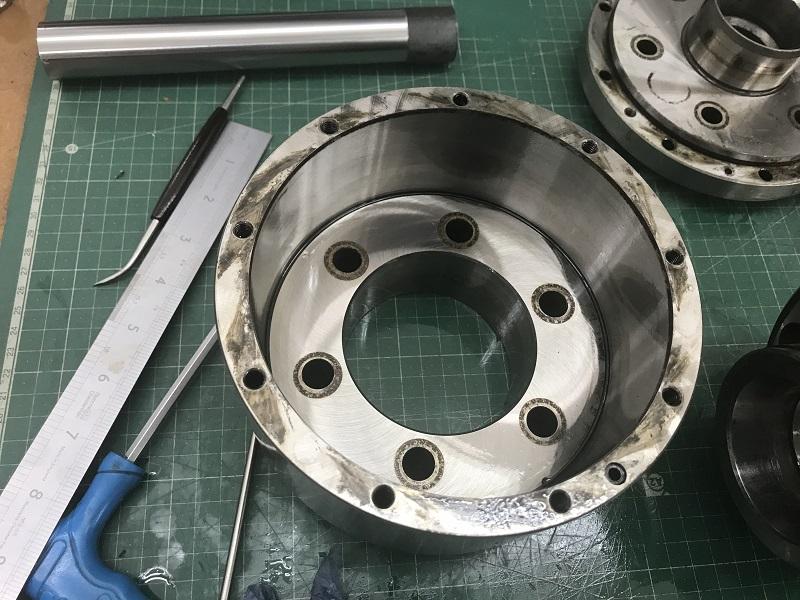

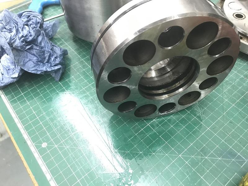

OK attack the chuck - got it removed and on the bench - was able to test that with compressed air applied it passed straight though and didn't build up pressure. Go and change your Tee shirt - yes the oil in the chuck covered me  :doh:

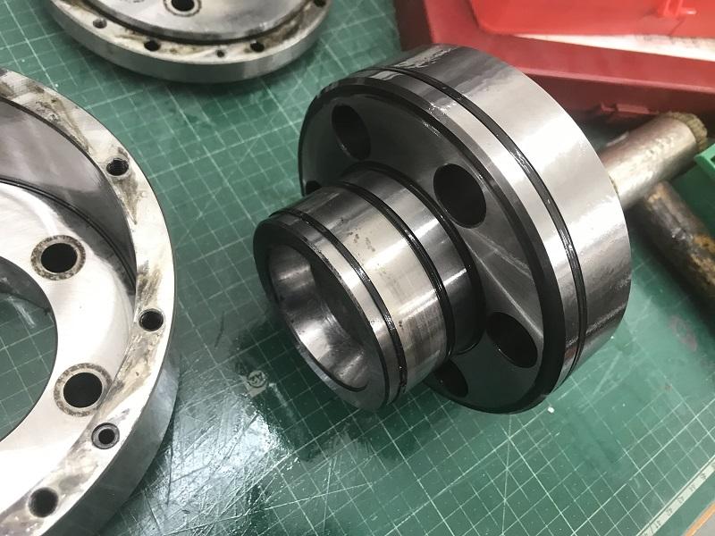

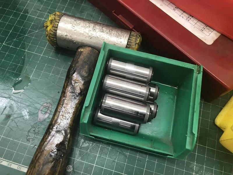

Now it's probably only an O ring gone - dismantle the chuck - well it's certainly got O rings but the main piston element has several double lip seals. All look OK apart from one that has a small nick in it, but it's a secondary seal so I doubt it's the problem.
A fair amount of Googling failed to find the odd sized lip seals - I'm sure they are out there but weren't immediately apparent - so I put it back together replacing 12 O rings that I happened to have to hand - these seal the holes for the mounting bolts so probably irrelevant !
Just as I could I tested it again on air and it worked fine ! Dare I risk it on hydraulic fluid at a much higher pressure - yes of course!
Darn me it worked flawlessly :scratch:
Now I will have to watch it carefully as these thing rarely just go away, but it's working !
Picture of the K53P  pressure switch is the modern RS equivalent
